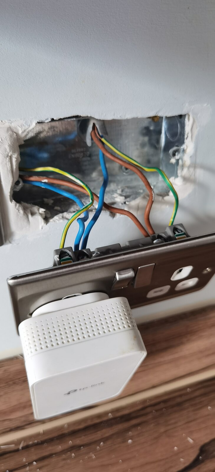

Hi I've changed the kitchen socket due to 1 of the switches breaking, wouldn't let me switch it off.
Since I've changed the socket the left socket doesn't seem to work, if I flick the on switch I get power for a brief second then nothing.... Any ideas?
I've since tried the old socket and still the same problem, it's all wired up ok.
On paper that's not possible unless one switch has broken.
If you bought a new double socket I've never known one not to work.
When you screw socket to wall make sure it is not under strain and bent. Needs to be sat nice a flat without strain.
How are you testing socket?
Took another socket off and no problems, so the replacement socket arrived with only the right side working.
Is there anyway just to repair the faulty switch? It's not fully switching off like something stuck or broken in the switch
