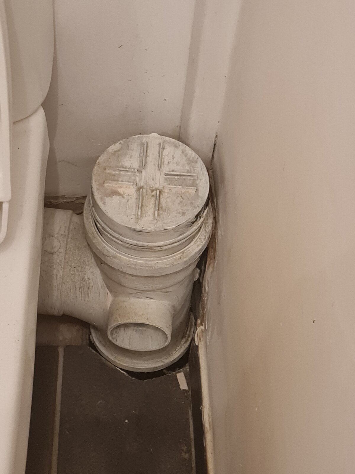

When the toilet is flushed, the bowl fills up with water then empties below the U bend and the wash basin plug gurgles.
If I turn the basin tap on, the toilet bowl fills to its normal level quickly.
If I don't turn the tap on, it fills but a bit slower.
When the soil pipe cover is removed (photo attached), the toilet flushes like it should.
Thank you for any suggestins you may have.

We planed to investigate today which wouldn't have been easy due to our kitchen extension, but the toilet has started flushing without any issues!
Could there have been a slight blockage that cleared itself?
Is there anything we can do to prevent it happening again?

Possibly, if waste has backed up and weight behind blockage has caused it to give, then quite possible it's cleared itself.
Not really, apart from don't put anything down the WC you shouldn't, (should only be the 3 P's, Pee, Poo and Paper), and avoid putting cooking fat down the sink. Let it cool and put in food waste or refuse bin.
Keep an eye on situation, any changes, e.g. toilet backing up, gurgling sinks/showers etc., then I'd be prepared to start investigating further, as possible it's either still blocked or has blocked again.
