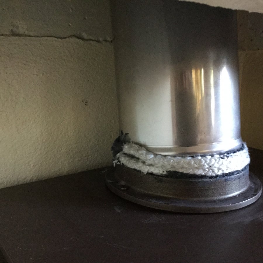

I had a HETAS installer in to install my wood burning stove and various charges were made (parts. labour and HETAS Certificate) but the certificate and invoice have not been forthcoming after six weeks. I have asked the installer twice for the paperwork.

In the event that a new installer found the installation unsafe do I have to pay them for re-installation? See photo attached.
Common sense suggests that seal is not going to be gas tight ( it will leak fumes into the room ) so that installation is unsafe.
How did you "know" that he was HETAS registered, did you accept his word or do you have dated documents that show he was the time HETAS registered. ( or was claiming to be HETAS registered ).
If you can prove he was HETAS registered when he did the work then I feel HETAS should ensure the work is redone to make the installation safe and that HETAS should cover all the costs as one of their approved installers has put you and your home at risk.

That job is a joke no wonder he is no longer registered.
Best get it reinstalled before you use it.
The rope, when fitted properly, seals the join between fire and flue. In this case the way it is fitted could be a noose for the fitter's business prospects.

I for one would NOT use the installation, if it don't look right, this one does NOT then it isn't fit for purpose.

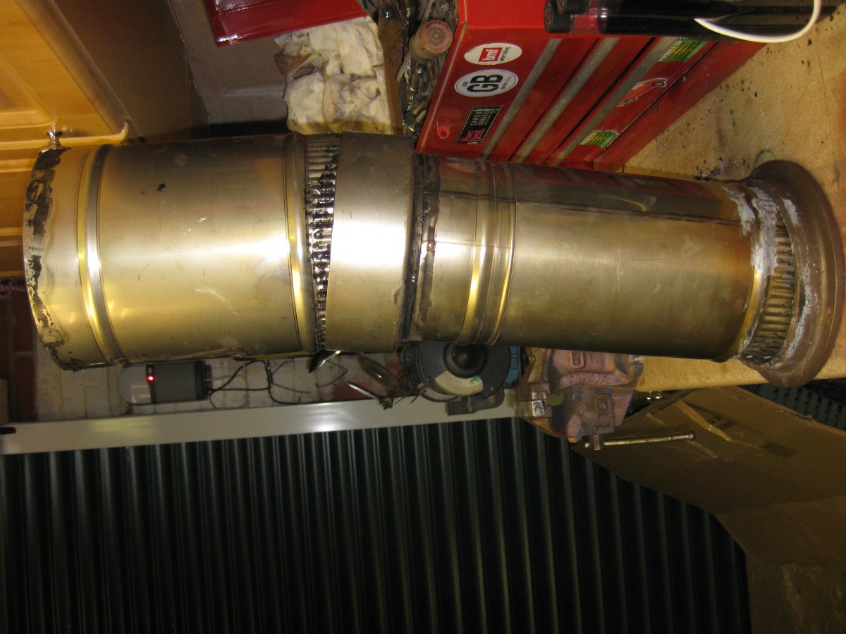

I said that the existing work was an eyesore and I wanted it corrected using correct offsets or equivalent (90 degree fully flexible joint for example). I had previously dropped a plumb line down and determined the rough offset measurement to be 50mm so a 15 degree pair would not be enough and a 30 degree pair would be fine as we could accommodate the fire being forward 25mm or so. I was told that all these alternatives would be inpossible as there was not room to fit any of these combinations. I'd dome my homework and the extending unit that was in place was exactly the same height as two offset bends.
I was asked what I considered to be the eyesore and I replied that the corrugated section of the pipe should invisible (ie correctly inserted so that a gas tight seal would be possible with HT silicone or fire clay and that fire rope shoiuld not be necessary. The response was to offer to cut the section at the back of the pipe so that the corrugated section at the front would sink deeper and be invisible. This would not be the solution given the ridge on the pipe. I'm now losing it! So what about the corresponding joint up the chimney? Not a problem. It's safe and I have certificated it. For a second or two I felt like resorting to physical violence but refrained (obviously as I'm not languishing in a police cell:LOL:).
I've resolved to take the hit on this as the stress and strain is not worth the candle. I'll get another installer in and explain what i want and get it agreed up front before work starts. Below is the complete stack removed from the chimney showing (without the fire rope around the base) what it looked like.
This replicates what it would have looked like in the chimney. There was no fire rope around the top section by the way. Further confirmation of the BS that had been spouted. Sorry about the photo being sideways on. In the original before uploading, it is the right way up.
