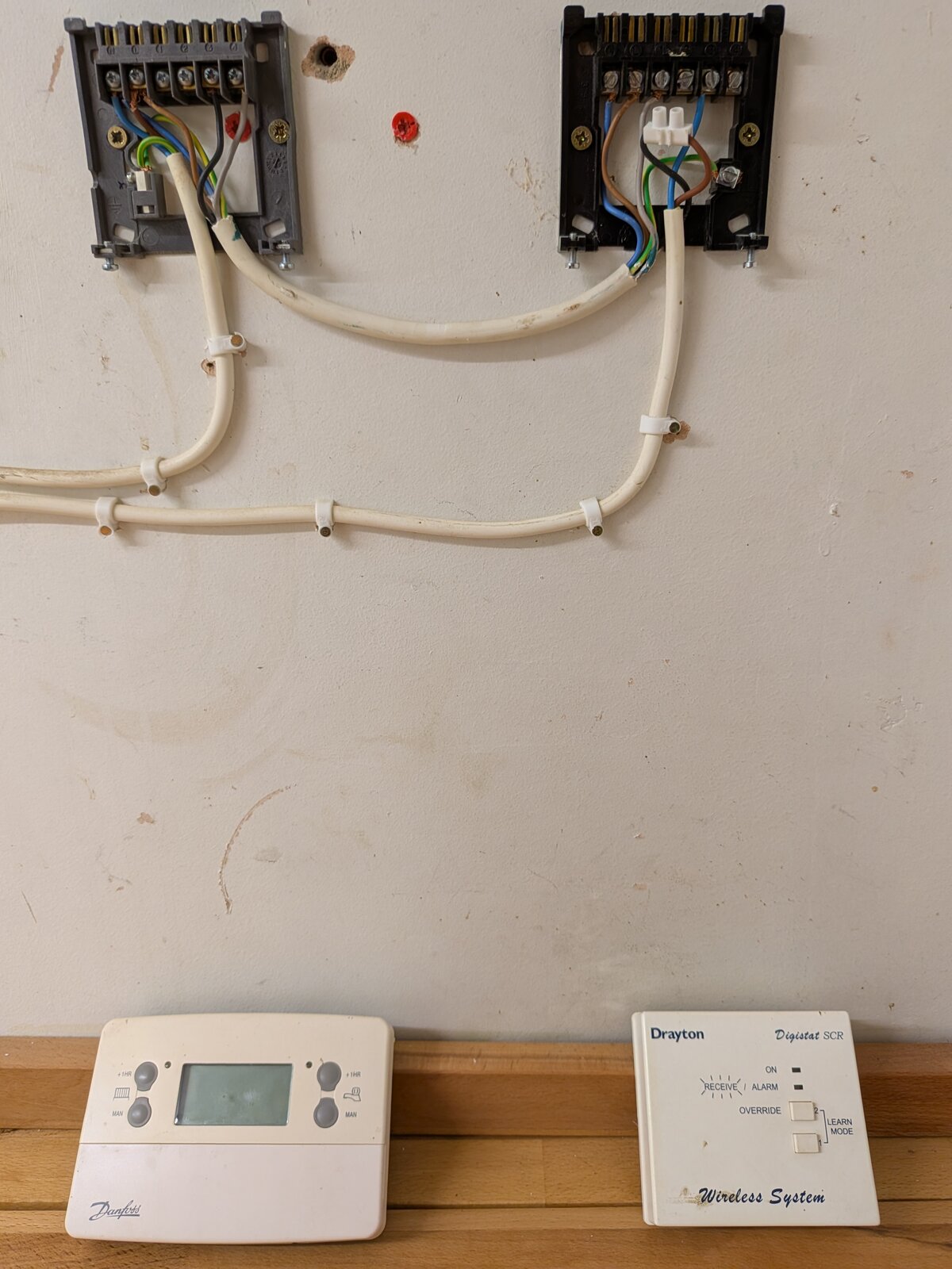

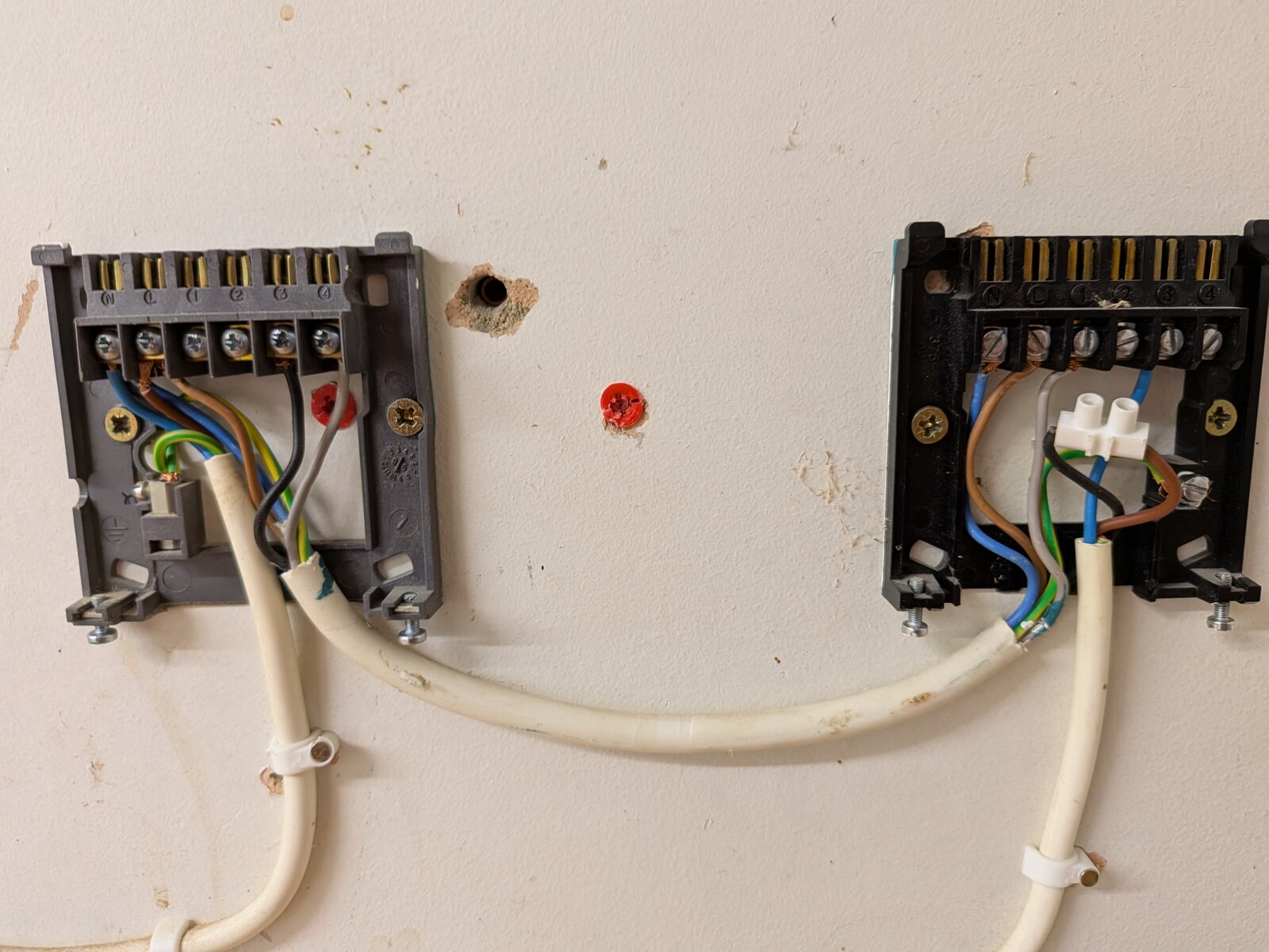

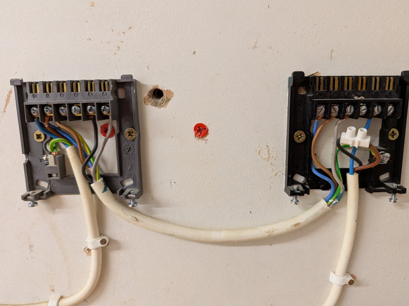

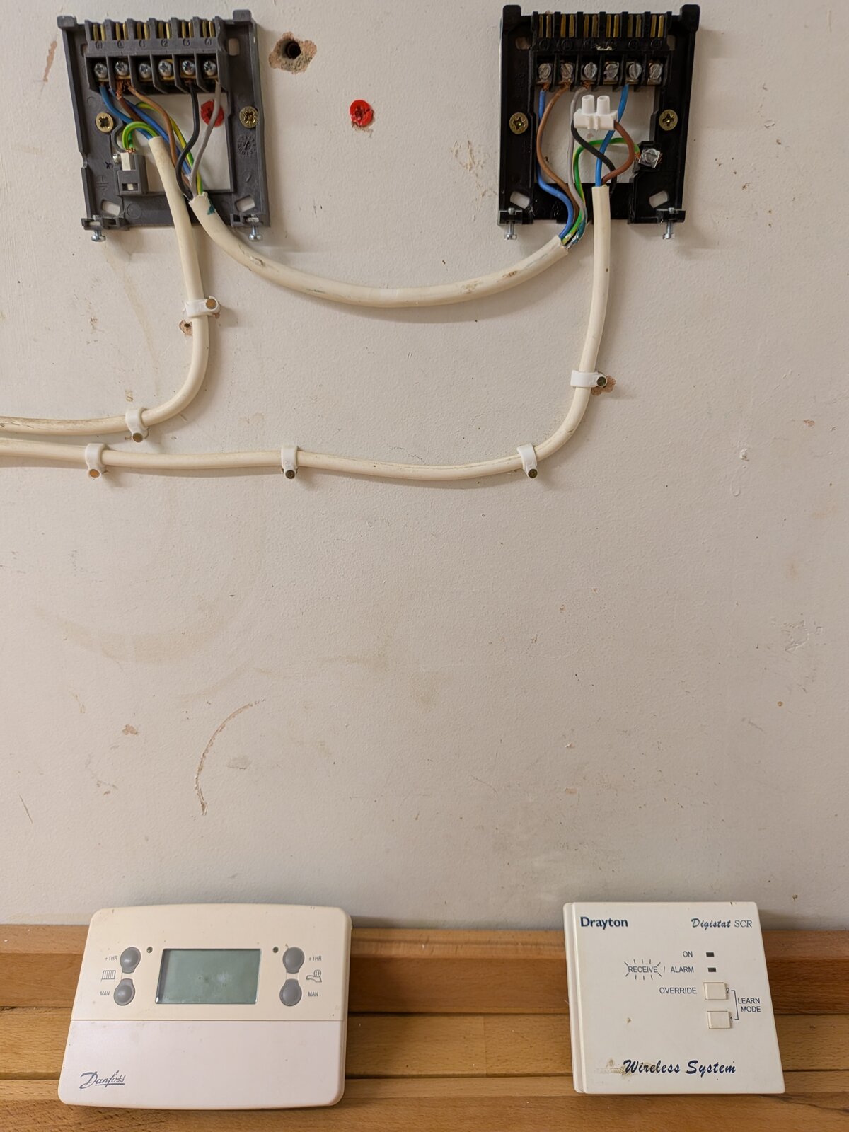

I've got a Danfoss programmer and Drayton digital SCR Wireless controller but no matter what I look at I can't see how to wire them correctly: the heating and hot water work, but appears to be on continuously rather that switched on demand for HW and by the thermostat for CH.
Attached is the current wiring setup but it's clearly not correct. And I can't see why there's a chocolate block connector in there either?! Anyone got any suggestions?

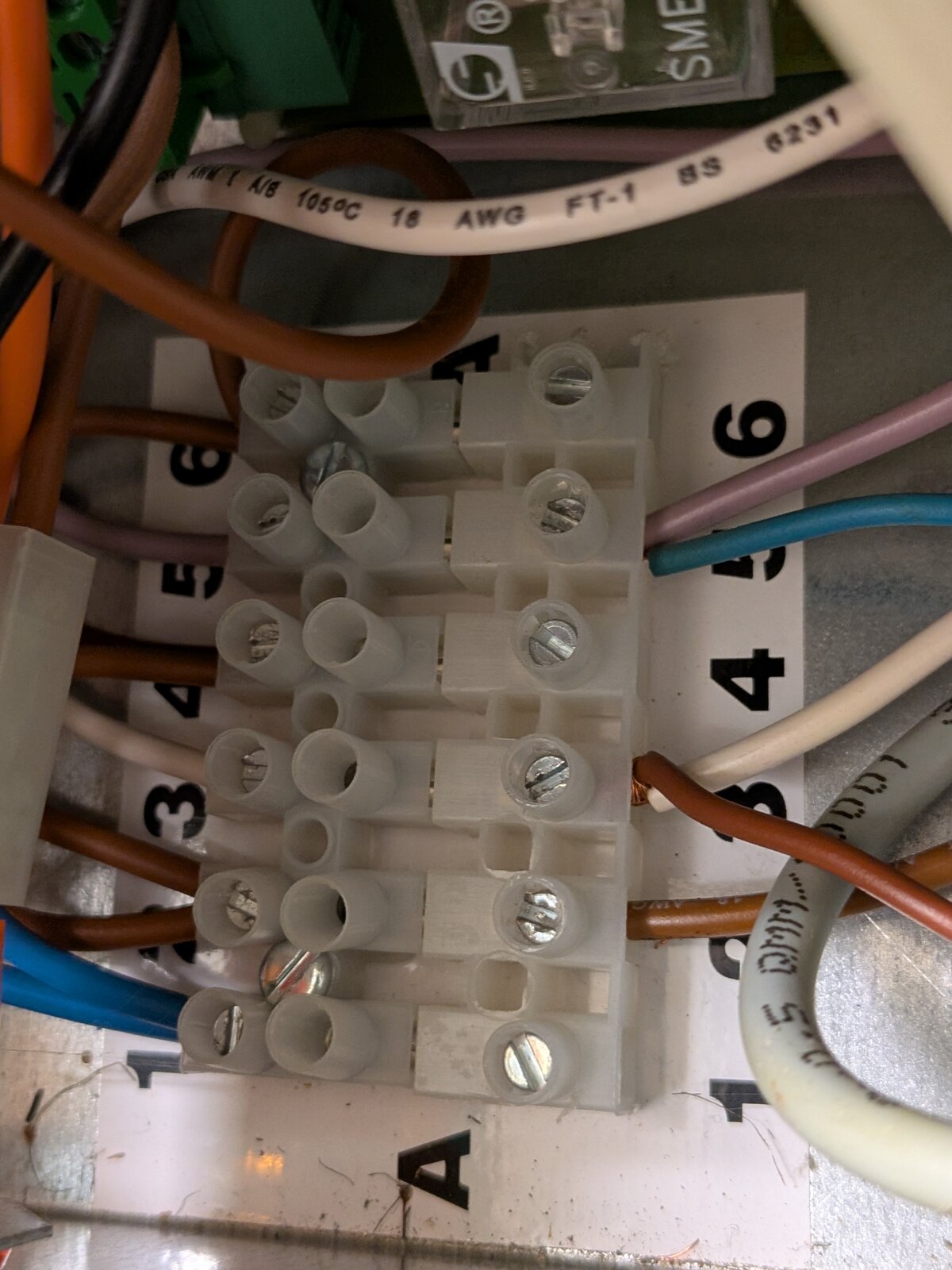

It appears as if the wiring could operate correctly, depending on how the system is wired at the wiring centre.
The Grey wire in terminal 4 of the programmer controls the heating, this is linked into the SCR receiver, that sends a switched live out on the blue wire (SCR terminal 3), when there is a call for heat.
As mentioned above, the black wire in terminal 3 of the programmer controls the HW. This is linked through the terminal block, to provide a switched live on the brown wire.
Is this system new to you, and has it always been a problem?
Can we have a photo of the wiring in your wiring centre?
These sort of issues are usually related to a faulty programmer, or zone valve/s.

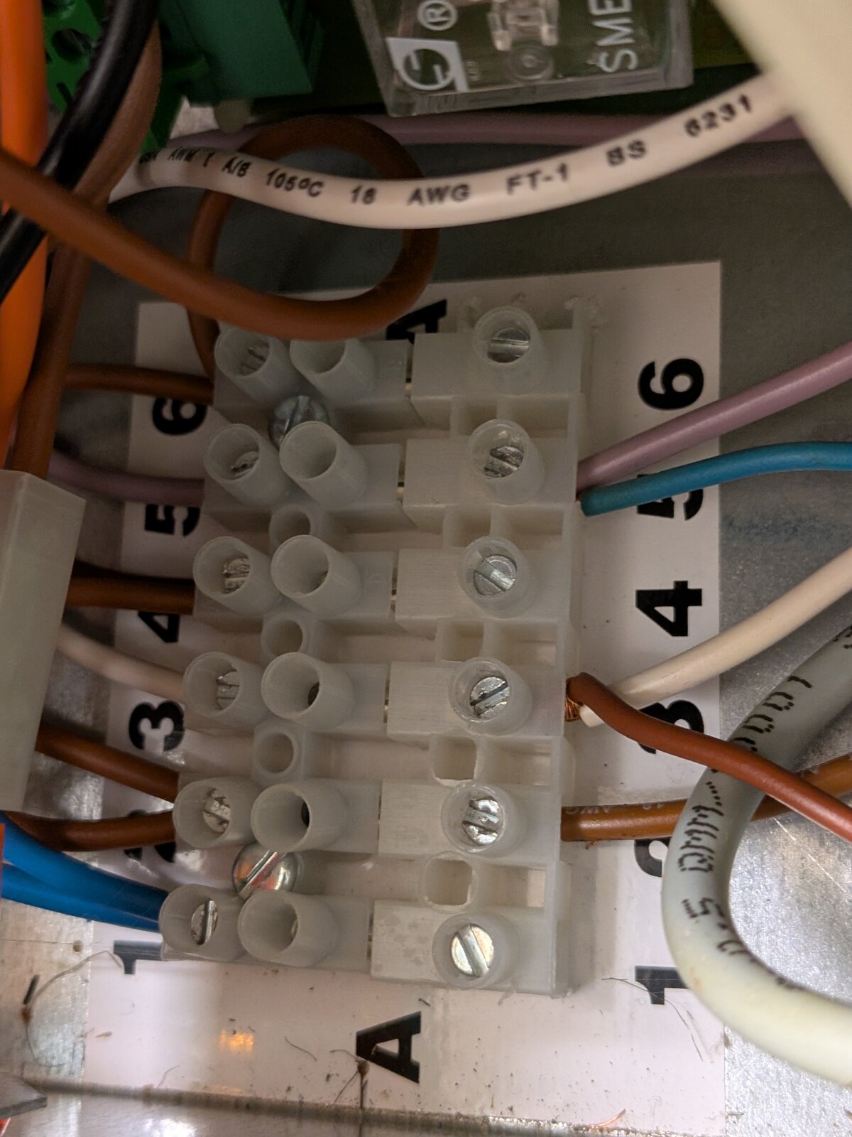

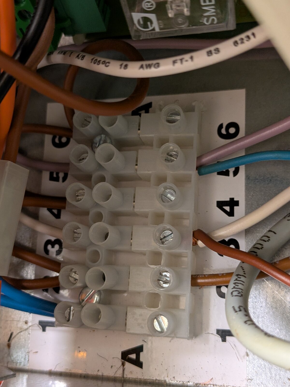

Is this what you need? It's hard to see as the panel is trapped by a replacement valve the plumber fitted when he serviced the boiler a month or so ago.
The system isn't new, but we've been renovating so haven't been using it for the last 2 years.

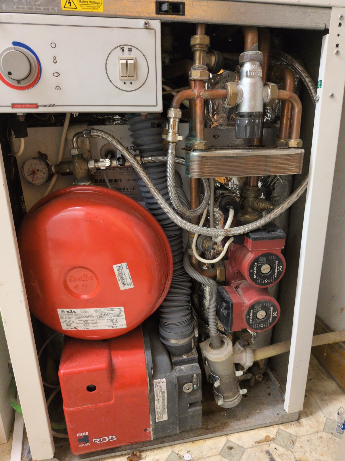

We are on oil with a Warmflow boiler (pictured). I think it's just pump on/off so maybe C plan basic? I'd usually call the plumber as boilers are black magic to me, and this wouldn't be such an issue. Unfortunately I can't get someone with Christmas so close, and I'm deploying with the military for six months at the start of Jan and leaving my wife on her own with heating on the blink!!

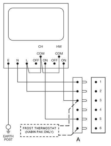

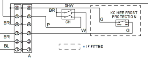

Likewise, I am also on oil, but looking at yours I would guess W Plan and it is a combi boiler. If it were mine, step one is note details and try and find the manual online,
I have found a random set of instructions here not sure if your boiler? I will guess this
is the wiring diagram together with this
I will guess this
is what this 1734297411703.jpegrelates to? Look at page 49 on, does it seem to relate to your boiler?
