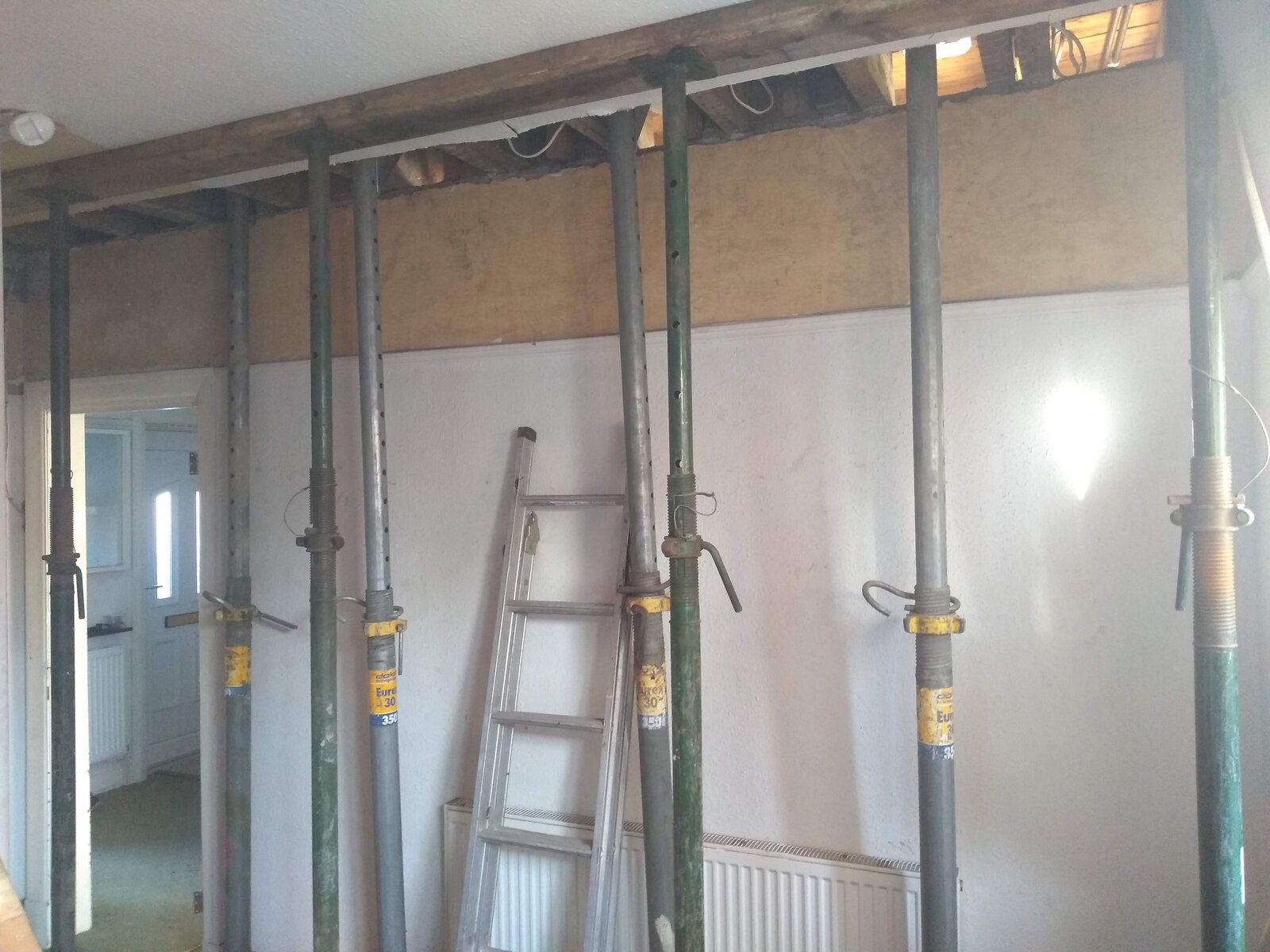

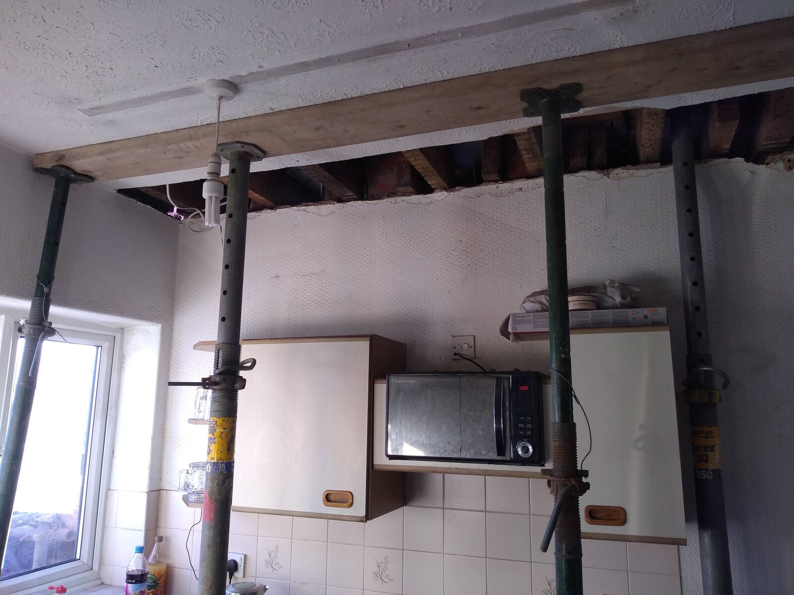

Similar to what I did, but mine was an internal wall with joists running in from both sides:
Kitchen side:
Dining Room side:

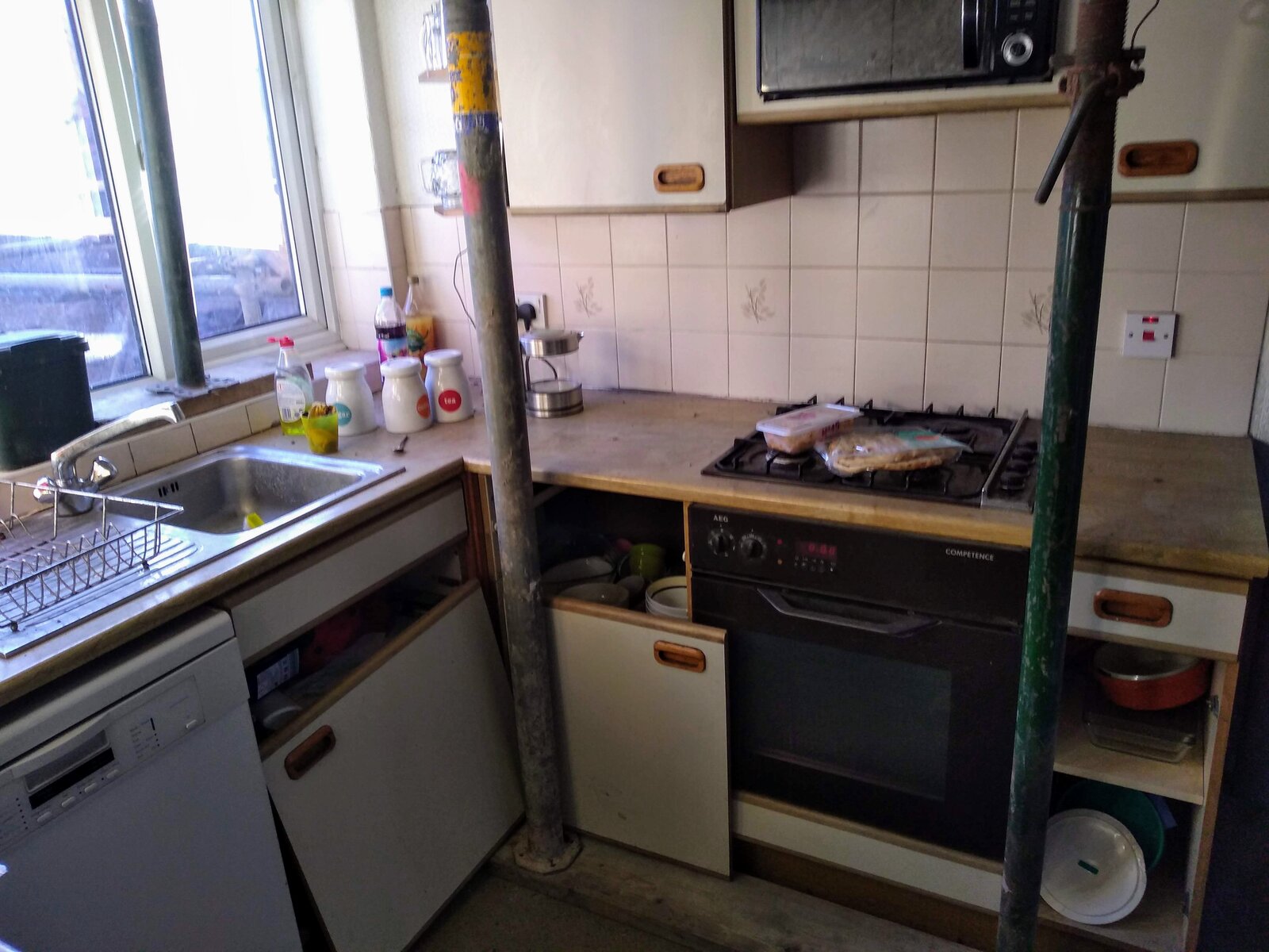

If you have a timber floor then check it's not rotten, and make sure you can open your kitchen cupboard doors or take them off if you can't.
Thanks buddy, thats how i had it planned in my head. I can get 300mm away most of the way along, its just the one corner where id like to come further out. I guess i just have to go a bit ott with the propping. I picked up some extras today.
