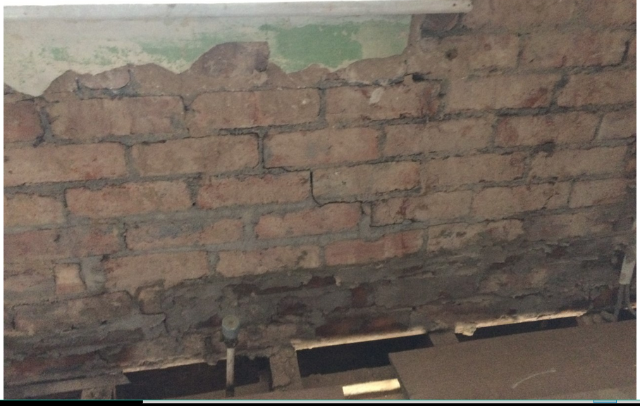

I often hear of people putting accrows under first floor joists that run into a wall in order to support the upper part of that wall. But is that a sound way of doing it? How do I know that the brickwork sits directly on top of the joists, there could be a gap between joist top and next course of bricks?
If there is a gap, it's generally very small; most joists in older houses are usually the depth of two bricks.

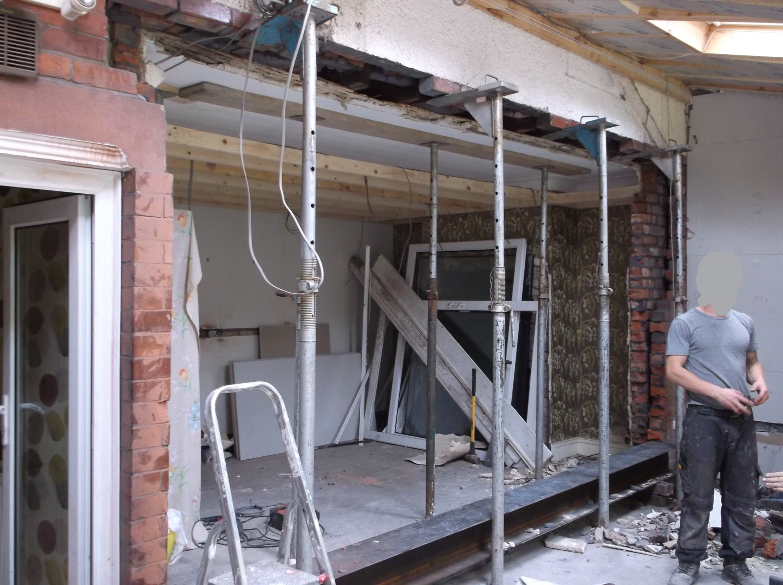

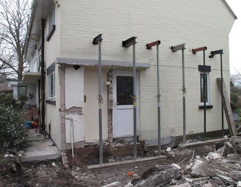

It depends on the brickwork, the joists and the amount of wall you are removing. Personally I don't like doing it because on old buildings you can never be sure how far into the masonry the timber extends, nor how sound (or rotten) it is, or how good the masonry is for that matter. If joists are going to rot anywhere it's always at the ends. We tend to use Acrows with Strongboys on smaller jobs, like these examples (culled from the 'net):
On bigger jobs it tends to be Acrows with RSJ "needles" that are used:

On one of my joists i reckon i can feel a 10mm gap. It might only be small, but if there's a gap then the bricks are not being directly supported. If they were to drop, and close that gap, that would be bad. Wouldn't it?
One only, it shouldn't be an issue. If it were 3 or 4 together it would be. Timber wedges/packers could be used to block-out the gap

Example of work where the inner skin is supported off the floor joists, in turn supported by a plank and props. The outer skin is supported off strongboys, and the beam to be installed is at the bottom.
