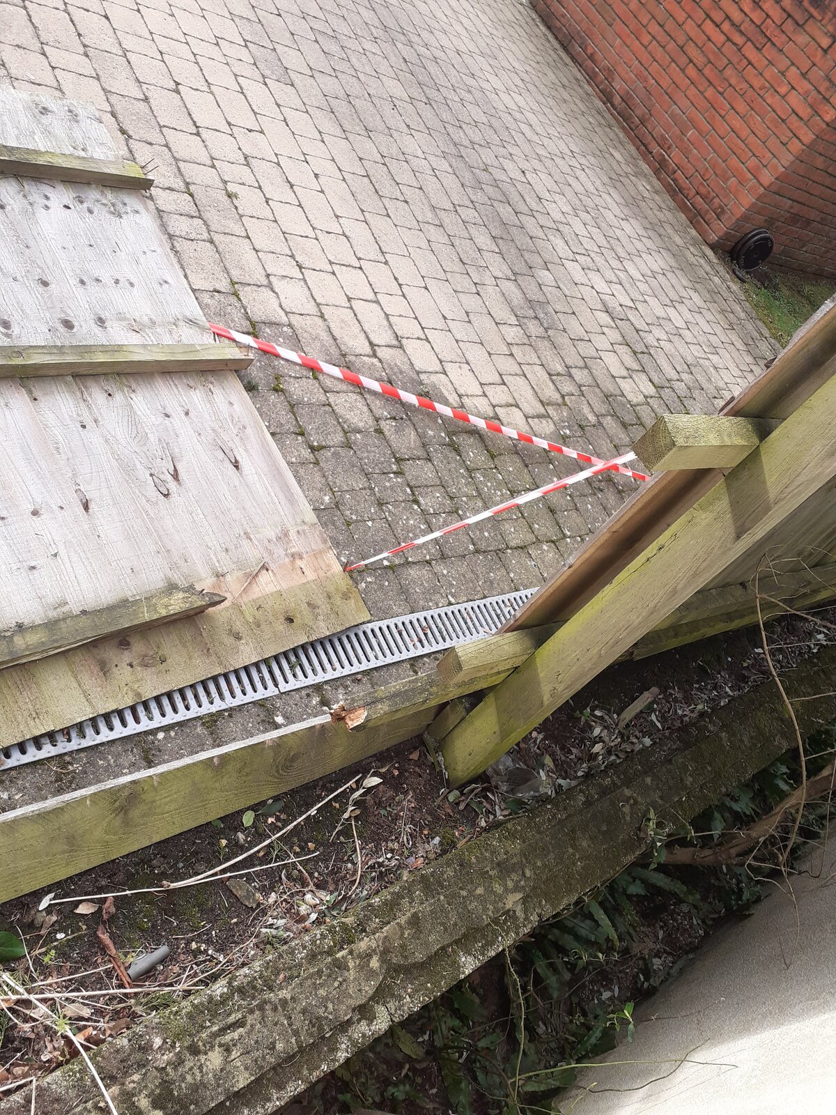

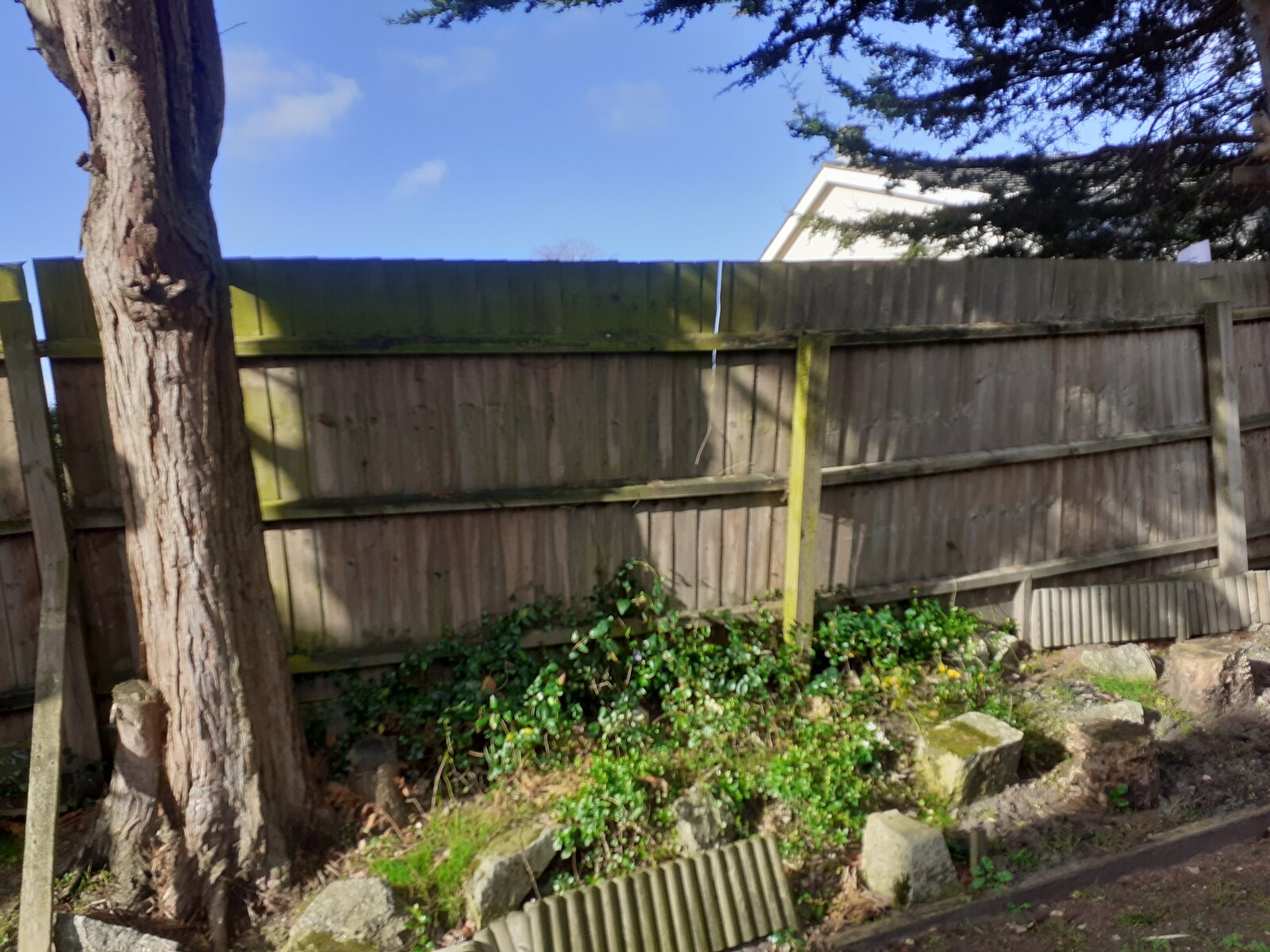

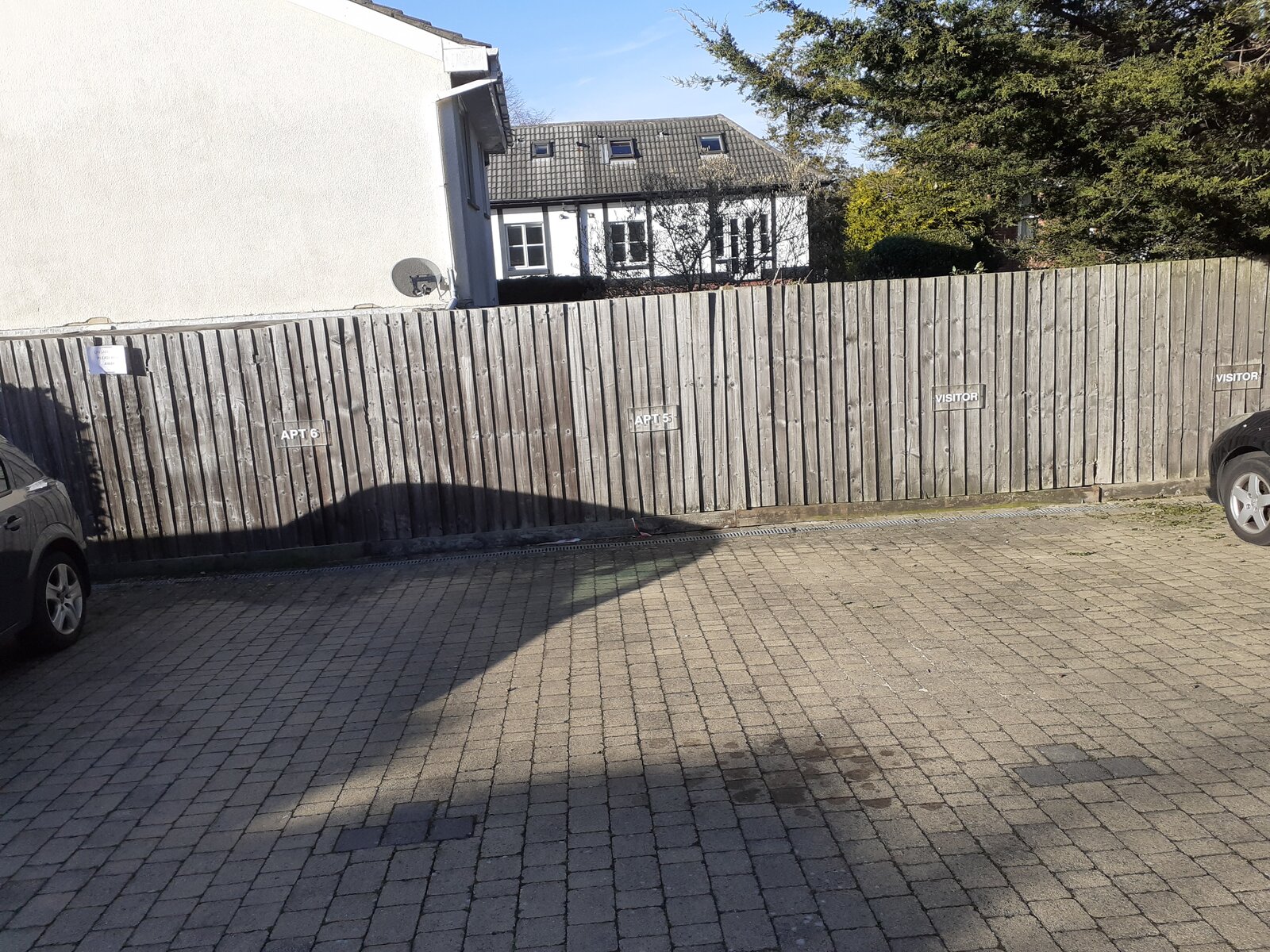

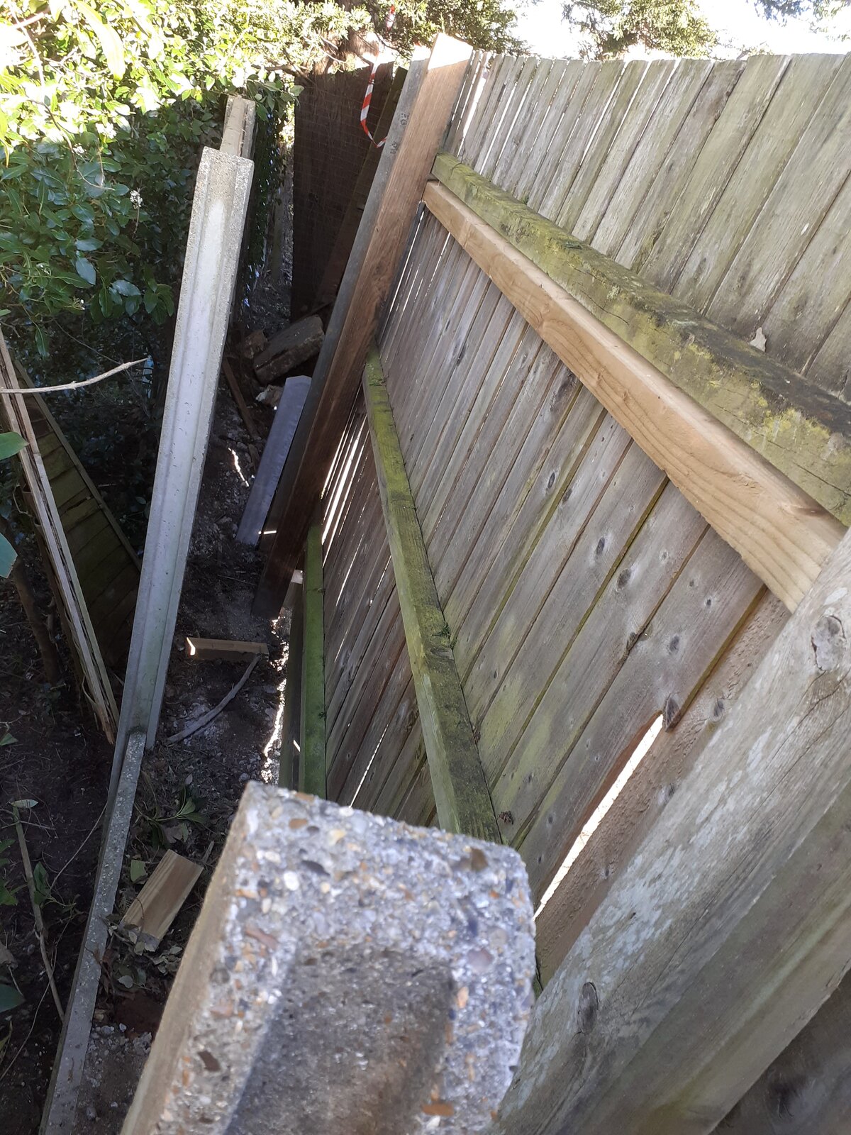

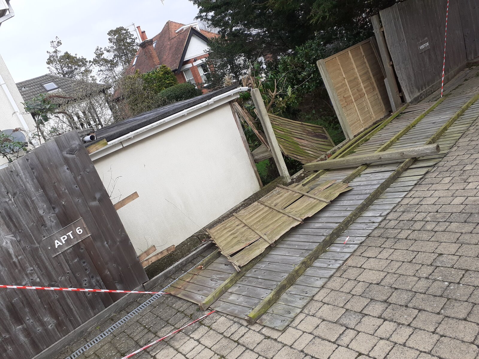

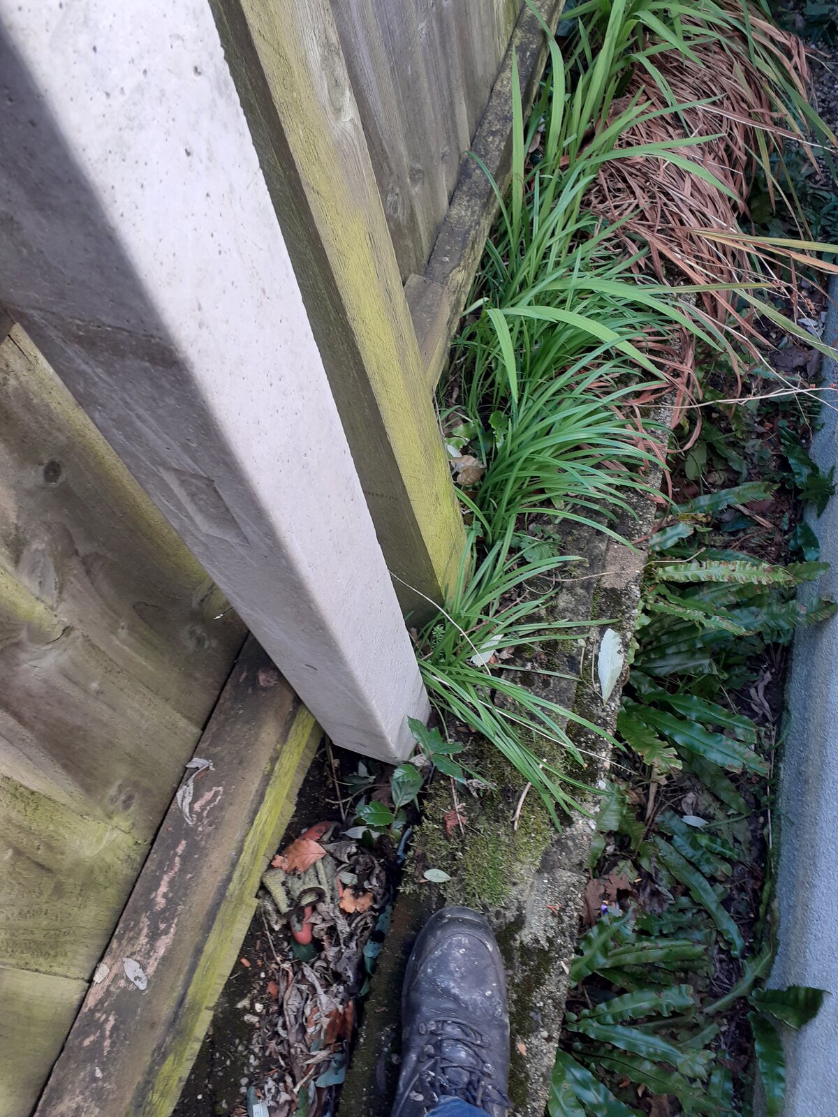

Got a section of fence which blew over .
I planned to use repair spurs and add a couple of new posts. Should I also replace some of rails? Any tips to keepng it all level?
A string line for the level, an offcut for spacing the overlap. Treated timber posts should be fine (get ones from timber merchants they are graded for level of treatment and will last longer than those sold in the Sheds). Concrete post mix is often used to bed in the posts but my fencing contractor used a very dry mix of sand shingle and a little cement. Very effective, dries solid and little or no movement of the post. No need for a wide hole which is useful where space is limited.

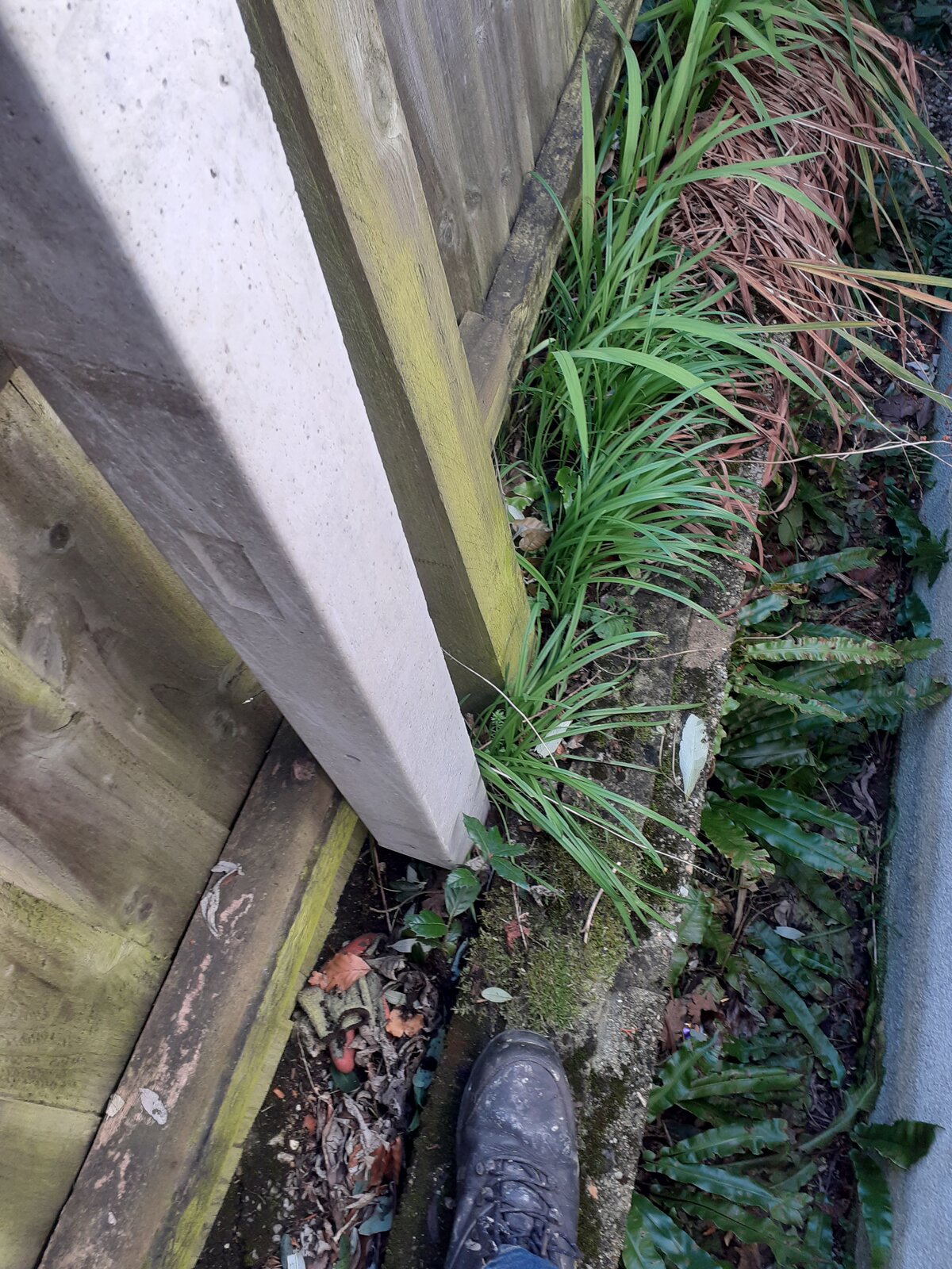

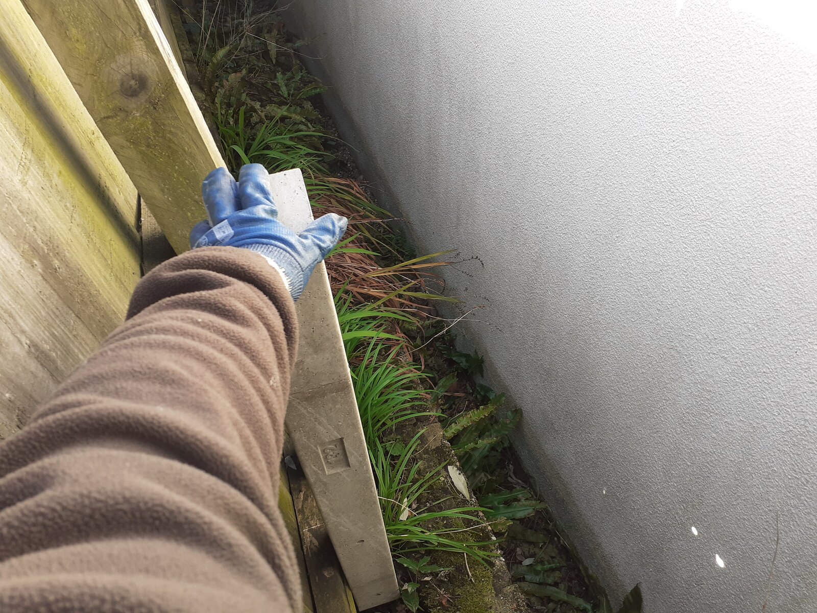

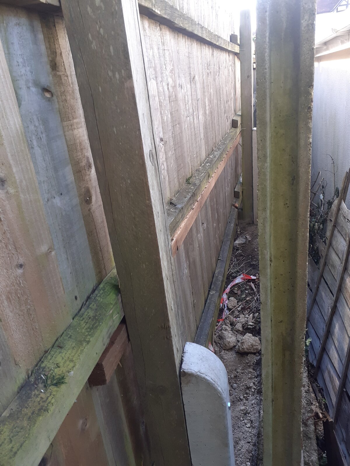

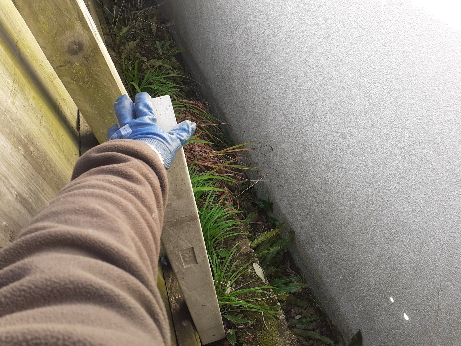

Can you put a repair spur side on (no room behind)?
Or would I be better bracing it with neighbour's garage wall?
Brace it off the neighbour's garage wall, they won't mind.
Andy
Well the old lady wont notice or a long time probably but whether that's allowed dunno. Woukdnt a spur sideways on do it?

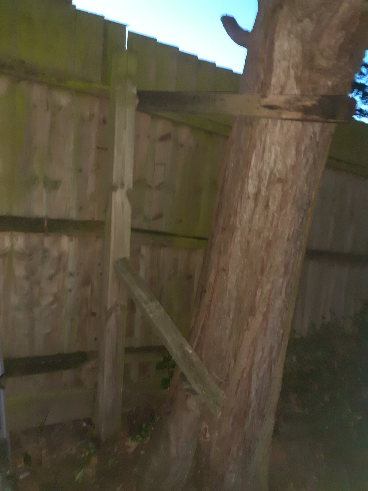

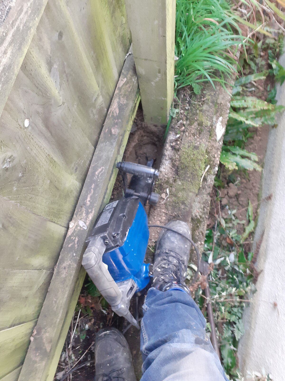

Didn't brace it on wall but put repair spur in sideways. All digging was done with breaker except one. Did brace one post off a tree. Hardest was getting the old feathers on top of gravel boards. Put in three new railsmm
