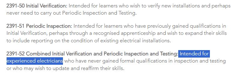

The reason 2391 is useless on it's own is contained in the course descriptions.
Of the three versions available, 51 would be for EICRs, and as that requires the individual has already done the 50, it's effectively the 52 which is both combined.
Intended for experienced electricians.
and from what I understand now, the written part of the paper has now been replaced by a computer based multiple choice test
Yes that's true now. I took my 2391 in 2007 and the exam was written with no book either!

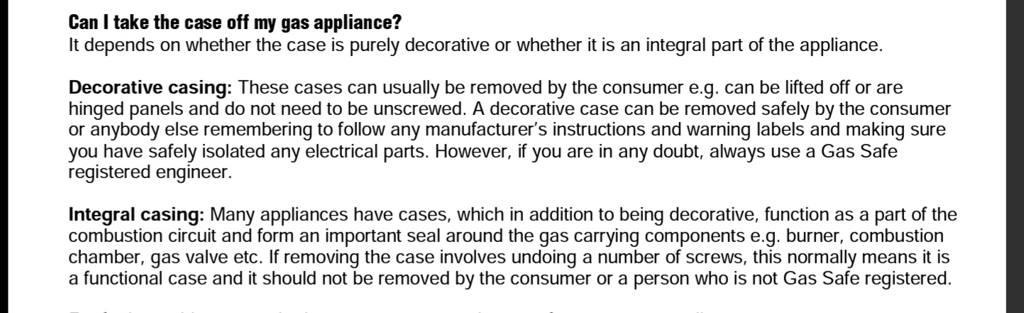

There is a difference between the gas appliances where the cover forms part of the combustion chamber/room sealing i.e. an integral casing and that of a decorative casing.
From the GSR FAQs...
This is often a bone of contention when we offer advice to DIY'ers on the Plumbing and C/H forum - many manufacturers hide their external control terminal blocks behind a room sealed cover.
We are obliged to warn a DIY'er that if they remove the cover to fit a new thermostat, they then have to have their boiler checked for gas safety afterwards, by a member of the GSR.
Which, I suppose in practical terms, means that an inspection by an electrician will end at the FCU, with a basic visual inspection of the flex and boiler. We may have to assume that the RGI who installed (or inspects) the boiler has competency for their part of the electrical installation.
