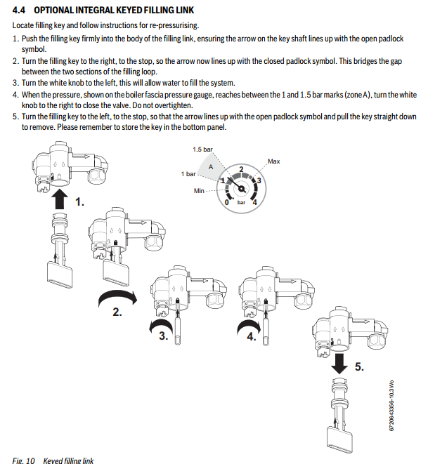

We don't have an external filling loop see below....

just close the plastic valve no3 then remove the key and if the pressure still rises it is the DHW heat exchanger
Well since bringing the boiler pressure down to about 1.5 bar that's made the world of difference. There may still be the odd drip but I didn't stand around outside looking up at the pipe long enough to find out. The pressure doesn't seem to be dropping either so hopefully that's done the trick.
