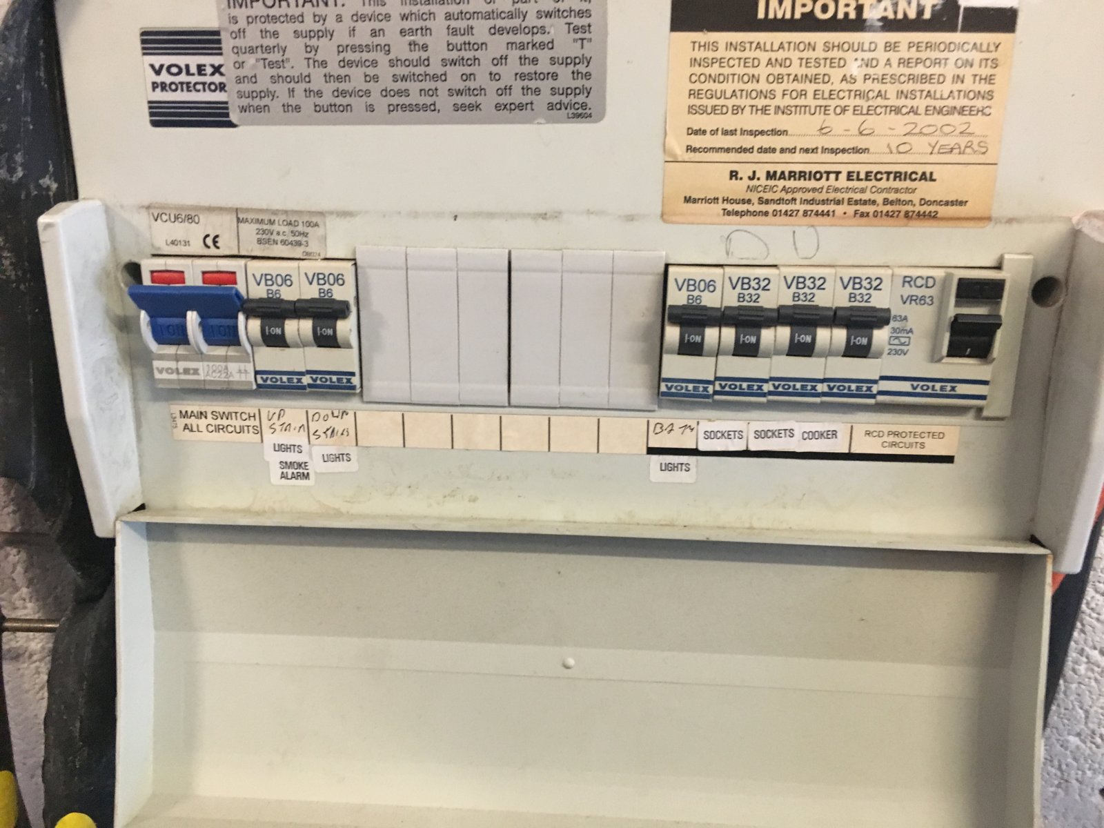

hi can anyone please help me I pulled the cord out of my loft pull cord switch so bought a replacement. Unfortunately I bough the wrong one I isolated my electric off took photos of the old switch..after realising I had the wrong switch I have put my old one back on exactly as it come off but know my landing and two bedroom lights are not working I did not touch anything else or disturb anything and have replaced the wires exactly as they come off any help please...bottom one is before I removed and top is when I replaced..
That pull cord switch won’t be the reason why the bedroom and landing lights aren’t working. Is there an RCD in your consumer unit which has tripped (switch is down)?
The pull cord switch is either the last one on the lighting radial, or there is a junction box somewhere which might need checking.
My money would be on something having tripped in the consumer unit. Even after isolating via an MCB, allowing the neutral and earth wires to touch will trip an RCD.
Thanks for replying chapster yes I did trip the fuse after incorrectly wiring the first time but all the switches are know on...
What mistake did you make ,and what tripped , MCB or RCD ? You may have fried something or loosenend a connection elsewhere whilst working on your pull switch.
I tried to wire in the new cord switch which was different and I put Both the red wires in the same connection, which then when I tried to put electric back on tripped the fuse immediately...
What fuse ? Do you mean the MCB for upstairs lighting circuit ? Anyway ,are ALL upstairs lights not working ? If so switch off the MCB that tripped and then switch it back on ( up ) ,firmly. See if it makes a difference.
It was the fuse which says upstairs lights that tripped and know my upstairs landing, one back bedroom and one front bedroom don’t work all the rest upstairs work...
Some MCBs have to be reset by pressing the lever DOWN as far as it will go before pressing it back UP into the ON position.
Just pushing the lever UP shows the ON indication but does NOT reset the mechanism of the trip and the circut remains OFF
Its a MCB ,not a fuse Leigh. Anyway if other lights on the circuit it supplies are working then you can rule out the MCB. As you were working in the loft ,which is where the cables linking all your upstairs lights most likely run , its possible that you may have in advertently loosened one. Turn off the MCB and visually check around the loft. If that reveals nowt your gonna need a multimeter , the know how of how your lighting circuit works and a bit more help ,or the services of a spark.
