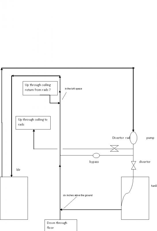

Hello everyone,
I still have the same problem and have taken it a little bit further. I have changed the divertor for the central heating and I have proven the bypass is not passing.
I think it is reverse circulation as per moggets comments and I have attached a drawing of my system for the experts to confirm this.
I have a couple of questions.
How does reverse circulation occur if there is no flow?
How do I fix it!
Regards
If your return pipes are as you say, you will get reverse return. Some of your diagram is not relevant to the problem, so could you do a diagram concentrating on just the return pipes? Make sure you can actually trace the pipes; don't guess what happens.
It's gravity circulation as in un-pumped hot water systems. Hot water has a lower density than cold water, so it will rise. When the hot water in the return from the cylinder comes to a return from the radiator circuit some of the water will flow down the radiator return and the rads will get warm.
How do I fix it!
Change the cylinder return so it comes after all radiator returns. But check your pipe work first to make sure it is connected wrongly.
The return is wrong as DH said, assuming the drawing is correct.
All the heating returns must connect together before the common return from the cylinder.
Reverse circulation is when it is connected wrong and the flow travels cown the return via an open circuit.
Easy to check by running the boiler in hot water only mode, and checking which end of each rad gets hot, then put the heating on and check if any swap over to the other end.

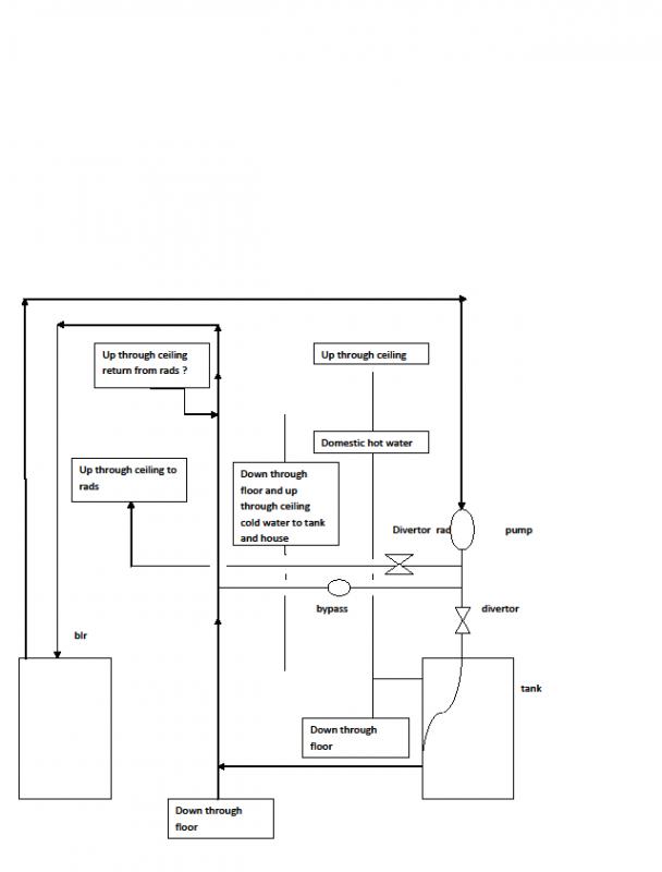

Hello all,
Thanks for the help, it is much appreciated.
I have a loft space above my garage so I can see the pipework from the boiler into the roof space and the connections to the tank etc in the cupboard below so I am reasonably certain that the diagrams I have posted are accurate.
I have added another diagram as requested with I hope the relevant detail.
I have another question the return from the tank is 6 inches above the ground and I think where the pipe disappears into the floor is part of the radiator return. The other return is then in the roof space. What would he easiest job to get this system straight?
