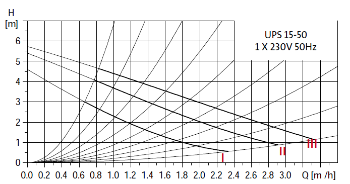

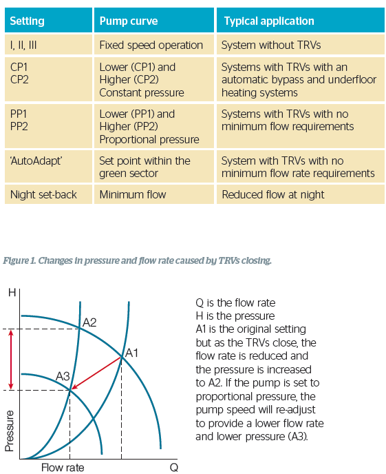

Theoretically speaking and what I have read in books, I think you need to know:
- the head loss of your system (depends on pipe size, flow rates, design and layout of rads) so you can draw system curve of your heating system.
- pump curves of your model from manufacturer which will tell you differential pressure that each settings will produce.
- the point where the two curves intersect (system and pump curve) is the point where you should be setting pump speed (without knowing headloss you are just gessing).
see attached for different layout and configurations for heating system. I have also attached a pump curve schematic of commonly used pump 15-50 in most heating systems.
HTH
