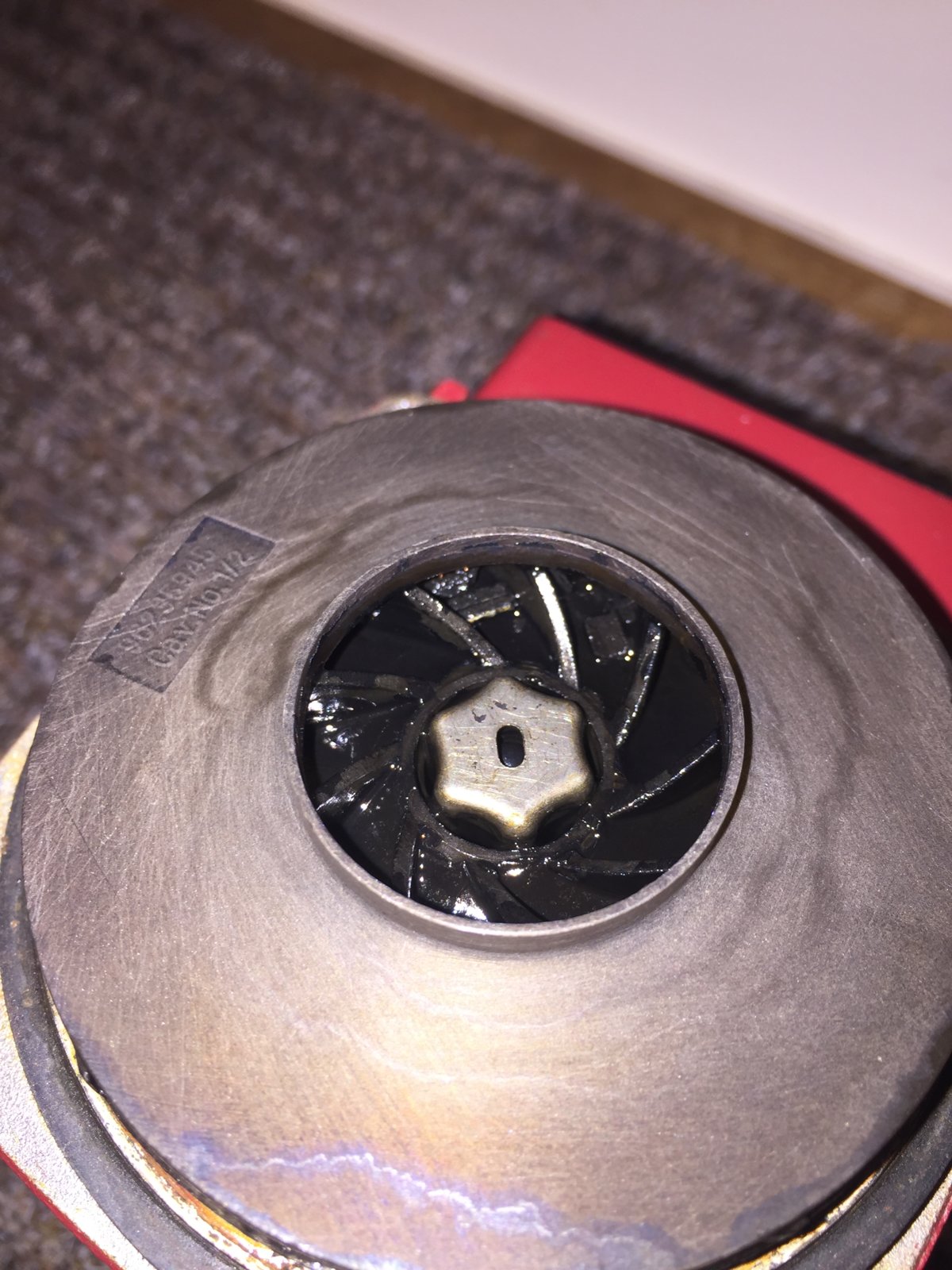

About 2 hours after the plumber left the boiler noise was worse than it's ever been. So I called out Vaillant. They turned up the next day but pronounced the boiler perfect but diagnosed a lack of flow. The first picture below is the state of my new pump. The plumber had connected his kit to the flow and return of the DHW and left the pump in place. His company is not responding to my emails.
So the system is back with the old pump and I thought running acceptably. But Christmas Eve the pump noise returned with a vengeance. I've now set the pump back to speed 1 and reduced the Bypass Valve pressure. The boiler is noise free and running better than ever. The whole system performs its functions well with all radiators coping with the cold and the DHW recovering within 40 minutes. It's just this 'hum' all the time.

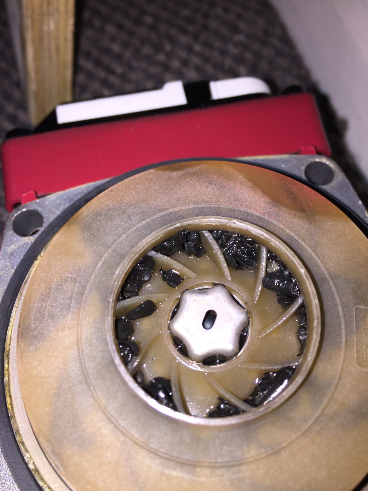

The second picture is the contents from the pump (with cotton bud for sizing)
. Anybody recognise the origin?
That's magnetite e.g your system is full of hardened crap. The poor flow is caused by this stuff. If you paid for a power flush you were robbed, those sorts of bits would come out even with the worst use of a power flush machine.

By the sounds of things this pump was left in place.
Once jammed in the impeller those bits won’t cone out with a powerflush.
Can’t understand why you’d powerflush with that pump in place though.
After the powerflush did he not test the system?
I’ve done powerflushes before where the system works fine with the powerflusher on but not well with existing pump.
You’d expect him to have noticed and checked this.

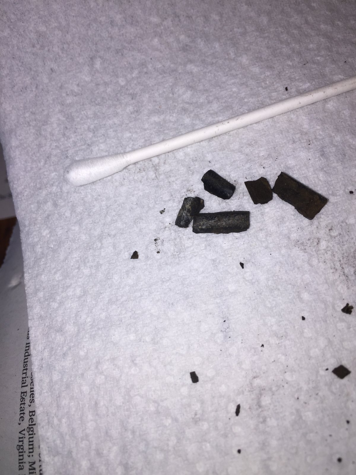

The shape of the bits is difficult to understand. If you look at the pump picture at about 2 O'clock you can see the bits have a rounded profile. The shape is quite small and no relation to 22mm pipes. Have they come out of the boiler? Plus they are magnetic and crumble if you really compress them.
Inside the heat exchanger
They were probably released during the powerflush

Answered my own question (Photo below)
The older pump I fitted back is now also showing debris. So now back with the new (and cleaned) UPS2 and mostly silent. It's on speed 1 constant with plenty of air bubbles working their way through. But the boiler has a bit of a whine I've not heard before. I'm reluctant to change the speed with my previous problems.
So more debris is coming out of the boiler and I'm not sure what to do. The flow side goes up and across to meet the Vent then the Supply (from the loft tank) then down to the pump (pumping down to the Honeywell Valves). On the return side is a Fernox TF1 which had very little debris in it. Just a little powder on the first notch of the magnet.
Pump today seems very quiet but I must be due more debris working through. As I've had a poor power flush perhaps I should do my own next time. The one I had at the end of November was clearly connected to the wrong place and I saw no evidence of magnets in the unit. Just a big pump and a container of water with valves on.
