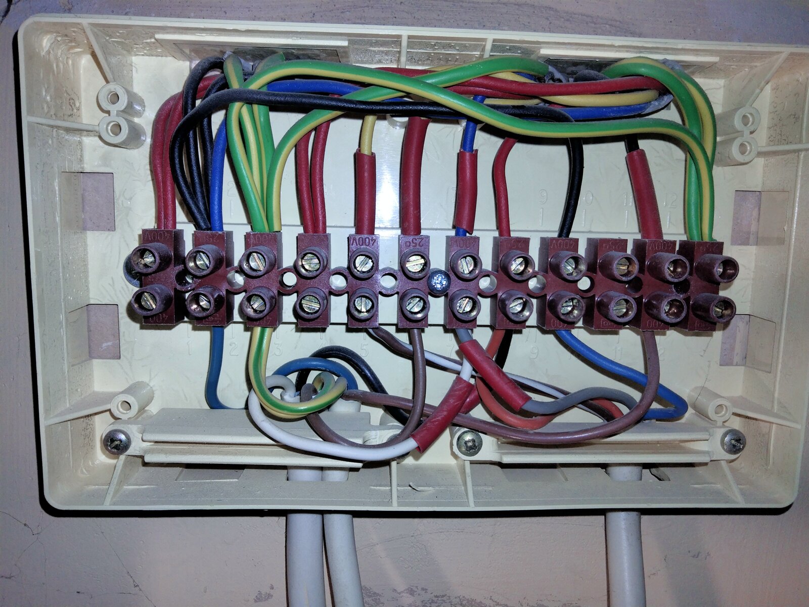

As in title my pump runs when not calling for hot water when the programmer is in cycle.
Photo attached inside my wiring centre.
I need some help fault finding please
When programmer is off ,no demand for hot water or central heating ,does pump run continuously ?
If pump runs on after demand for hot water is satisfied,and doesn't stop, it's not a wiring issue
Pump stops when programmer is off.
