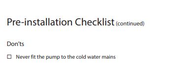

I want to pump mains cold and vented hot water to a thermostatic mixer (long story, water tank too small and I cant afford to replace it or go with a vented cylinder)
Just been told by Salamander helpline that I can do this using this :-
https://www.salamanderpumps.co.uk/product/ct-force-30-tu/25
Is that correct ? - I thought you couldn't pump mains cold ?
Cheers.
The link to the literature you have provided states:
Normally the cold mains goes direct to the mixer and just the hot water side is pumped.
There is provision to increase domestic mains water to a higher pressure/flow,there are many limitations and any outlet on that line needs to be correctly selected and installed,that includes having a shower mixer that will mix with the unbalanced pressure/flow to a suitable temperature.
Its do able,whats your budget ?
Test your cold mains for flow and pressure - You can only pump the mains up to a max of 12L/Min and a raise the pressure to around 1.5bar. If you mains is at this level or above then the mains could not be pumped.
