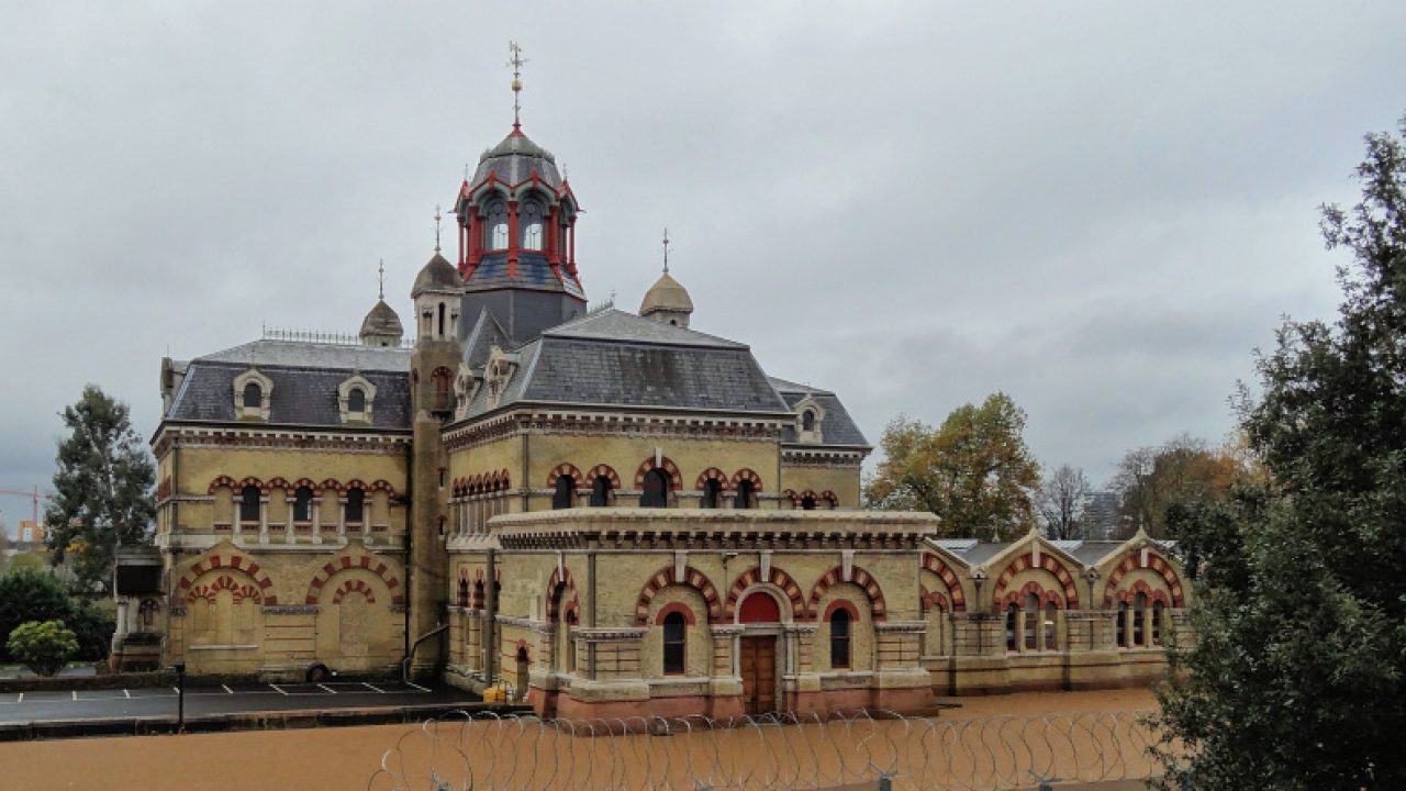

This is what you call a pumping station.
