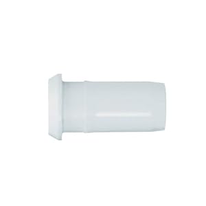

Have you used inserts? From the John Guest website:
Plastic Tube - Polyethylene, nylon and polyurethane conforming to the tolerances shown below. For soft tubing or thin wall tube we recommend the use of tube inserts.
Inserts, stiffeners, liners:
