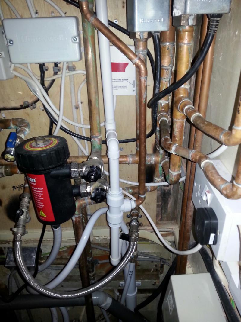

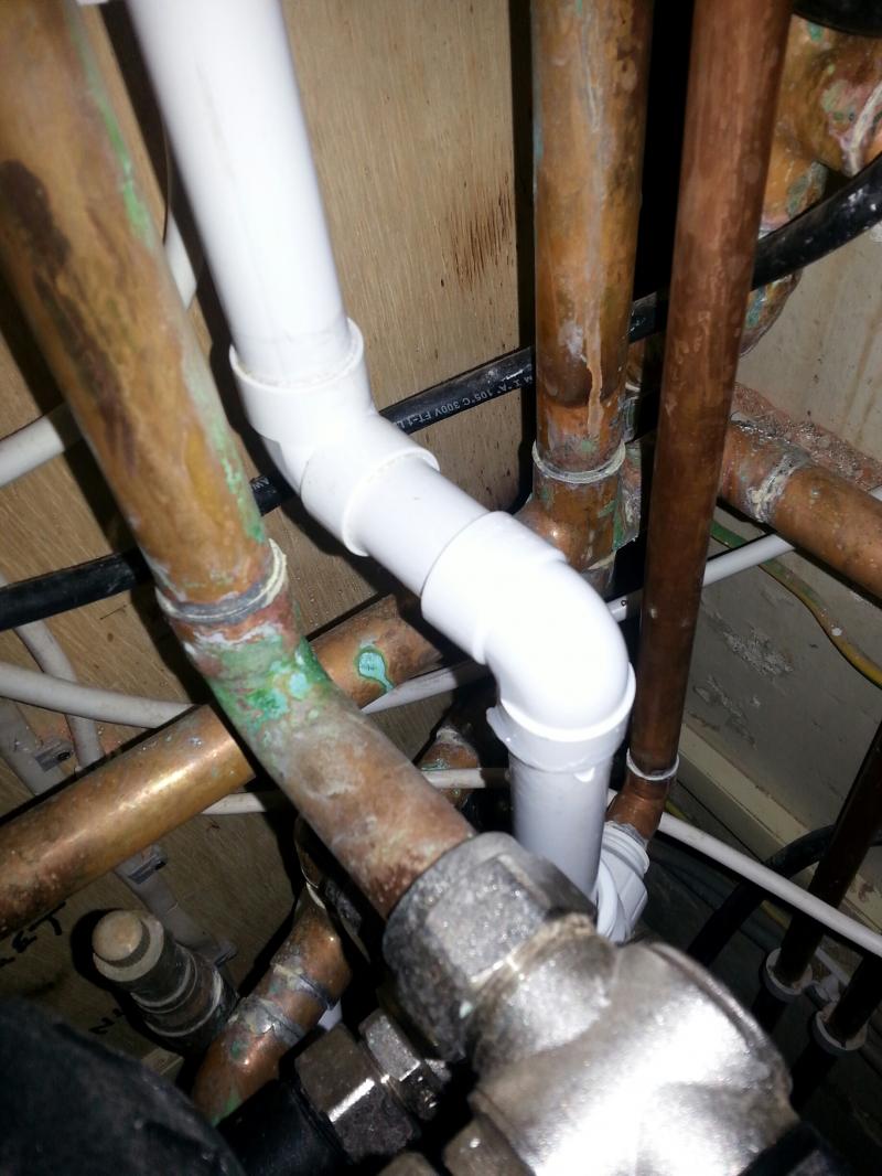

Hello,
Had a few issues with water today, in the end got a plumber out to sort out boiler which was not turning on. During his investigation he was moving the plastic 22mm pipe trying to get to a sensor behind it.
Now ive turned on the heating and one of the elbows is dripping, very slowly so not unduly concerned right now but just annoyng giving the time ive spent cleaning up water today.
Ill attach a photo.
Now, im assuming these elbows are just push fit?
On initial connection are they just push together with a bit of grease to form the connection?
Do I just make sure theyre tight and use a bit more grease to stop the drip?
Looks more like a solvent weld overflow or boiler condensate pipe can you take some more pics from further back?
Definitely solvent weld but looks like a speedfit at the bottom

so....how would I stop a drip on a 'solvent weld' joint?
Your best option is to cut the leaking part out and renew the section. It's a better and probably quicker option than trying to bodge a repair.
You could do a tempory repair by applying solvent weld glue or silicone around the leaking elbow.
AS Rampage77 says looks a bit iffy, sometimes a bit of solvent around the joint works but, a proper repair and perhaps get a qualified installer to check it out is the best bet.
Pipe runs from boiler to waste pipe.

They should be run separate, without seeing the way it terminates it's a bit of guess work but, the condensate should not be run in copper in any part (check it runs to discharge in plastic), likewise I would not run any part of the Pressure Relief Pipework in Overflow pipe also I would not use a pushfit fitting (Speedfit Tee) on any part of the condensate or Pressure Relief pipework incase the "O" ring is attacked by the condensate products or High Temperature .
In summary, I would remove both the condensate and PR Pipework and run them separately as they should be.
Again depending on how it terminates you could have a situation where the condensate pipe could freeze and become blocked therefore the PR discharge has nowhere to go.

whilst your post isnt particularly helpful at all. I dont see the prob with 45deg bend as best use of tight space here.
also I asked many 'pros' regarding doing the job, its not easy to find excellent tradesmen generally...I don't wont to offend anyone on here but lets say I checked a few guys.

thanks. Ill check this out
