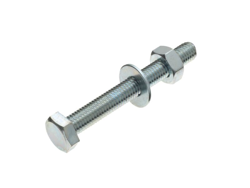

I am putting up a punchbag in my garden. The bracket will be affixed with 3 bolts. I am aware that punchbag will put some stress on the wall so want a secure fit.
The punchbag will be attached to the outside of my shed which is made of concrete blocks (breeze blocks) and the wall is approx 80mm thick.
As far as I can see I have 2 option
Use expanding bolts (aka sleeve anchor/thru bolts) - are these all the same thing?
The issue I have with these is that in the past they have caused brick walls to crack. As I will probably be going in 60mm of 80mm I am worried they will cause damage when they expand.
The other option is I drill all the way through and use a nut to tighten on the otherside. This to me feels like it would be a more solid connection. My query is - what fixing do I need - is it a hex bolt? As such: http://s7g1.scene7.com/is/image/BandQ/5020789852589_001c_v001_ap?$173x173_generic$=
Any other suggestions?
Also I am planning on using my normal drill as opposed to SDS to stop the SDS smashing up the wall. Am I right to do so? Hopefully my normally drill will do the job if I get a good drill piece.
I'd go for the bolt through method, with large washers or plates on the inside of the wall.
You can always use threaded studding plus nuts and washers if you want - readily available. 10mm diameter should be fine.
To reduce break out when drilling through, use a small diameter masonry bit first, followed by the correct clearance size......it doesn't matter if its SDS or not, but a masonry bit is essential with a percussion drill.
Once the small hole is right through, drill from both sides to just over half way with the larger bit.

So just buy 3 hex nuts with washers and bolts and then get a sheet of ply that will go on the wall inside the shed and the washers/nuts will then go onto that?
With regards to the hole, I think I can use 10mm holes as that is the hole size on the metal wall bracket - so I should use 10mm bolts which will literally fill up the hole in the wall to a very snug fit.
