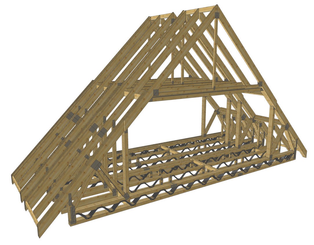

Sorry, I'm just terrible at explaining things. Im quite a newbje to all the technical terms regarding roof structures, my loft looks roughly like in the picture attached to this post :)

So, how old is your property? And are the binders for the rafters horizontal/vertical, or in a W-pattern?
They are horizontal and not in a W shape. Just straight lengths of 2x4 spanning across the width of the loft and attaching to roof rafters. Old ex-council house, build circa 1962.
