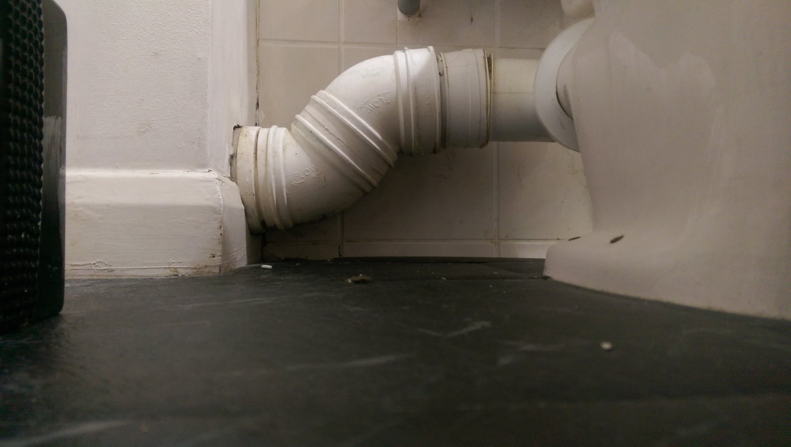

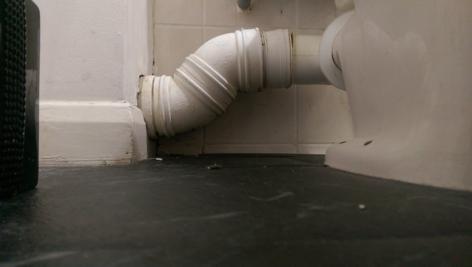

So current WC seems to have been plumbed into the stack about 50mm too low so the waste has to go up the waste pipe a little before heading down into the stack. I think it is that that is causing the room to smell especially after a flush?
Anyway, would it be a stupid idea to cut a thick piece of wood to the shape of the base of the pan and then mount the toilet a little higher?
its as above an ok odea , do it in a couple or so of pieces of ply, glued and screwed together. sit the pan on the ply, draw the outlineand jigsaw the outline.paint the edges to suit,screw the ply to the floor.
but remember the cistern is moving up 50mm to and any other connections will change position.
photo of what youve got there now at the pan connector could help. any pan connectors or extensions must be changed fr new

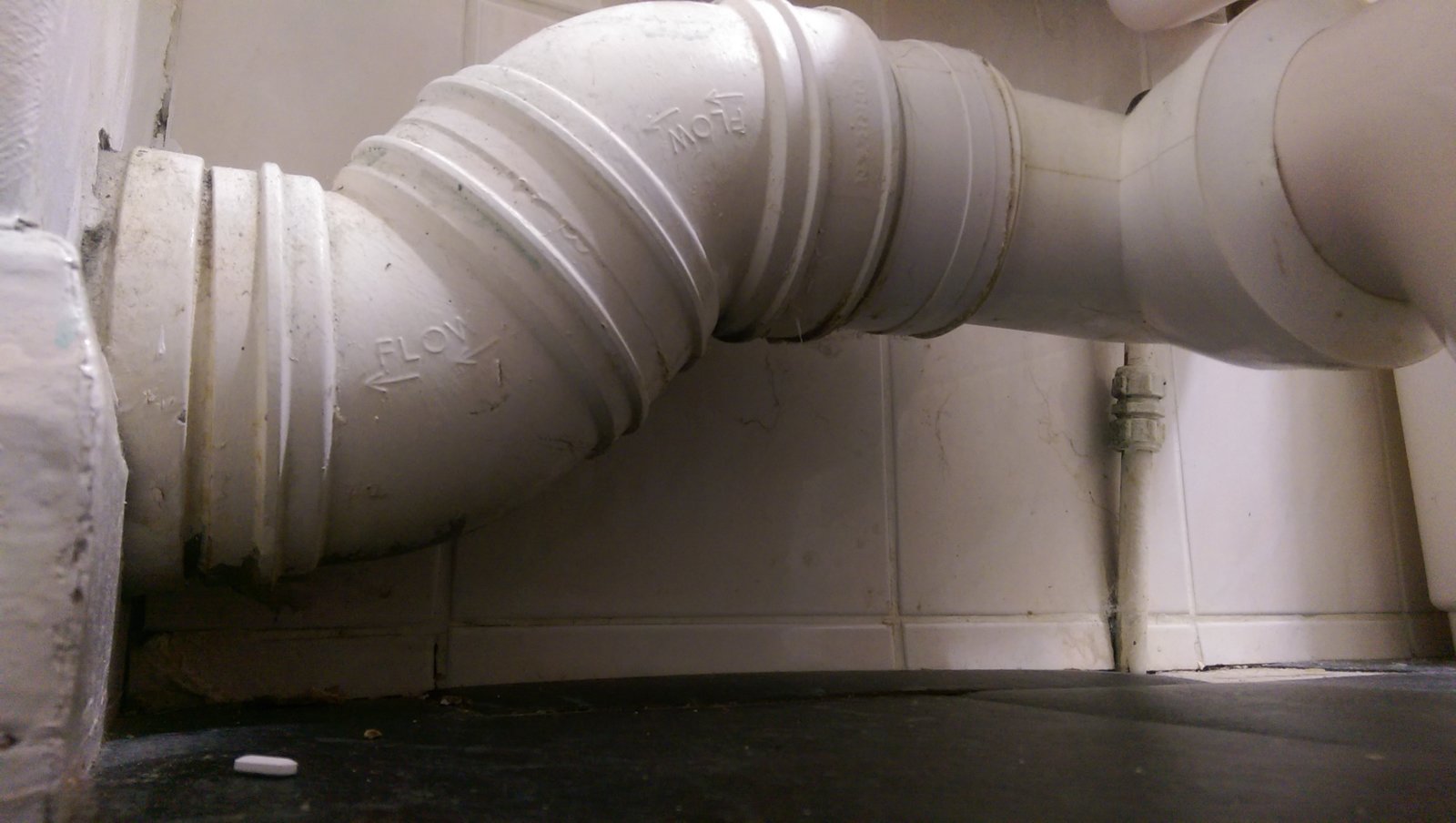

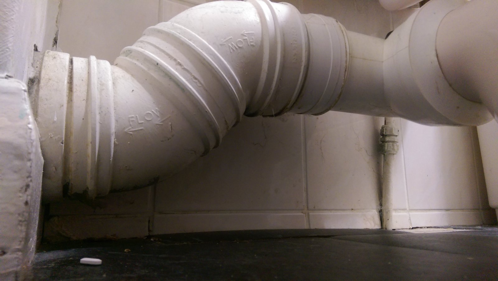

Many thanks for the answers. I've attached a pic of the current situation. The camera was dead level on the floor for both shots.
When I mentioned this to the wife she said it was a very old toilet and why don't we put a new one there so that is the current plan.
However, is there enough pipe there for me to insert one of these?
https://www.screwfix.com/p/mcalpine-wc-con8f-90-flexible-pan-connector-white-110mm/28262
(which costs half the price of the new WC !!)
Its only about 320mm from the nearest edge of the pan outlet to the nearest edge of the stack boxing in that you can see. I guess I could move the new one a little if I had to.
I'm assuming the two 45 elbows are solvent welded so would need to cut very close to the boxing in to get a bit of pipe?

Cheers for that makes sense but I'm still not sure where to cut the existing pipe? Will it have to be virtually flush with the existing boxing? I was thinking that the new flexible connector goes inside the pipe so maybe I can cut the existing connector a few inches away from the boxing?
Thanks again!
Yes solvent weld - cut through the 45 fitting nearest to the stack leaving a stub for the connector - the one shown will work. As you thought- a few inches from the boxing. You can use a disposable woodsaw.
To be honest unless you want to move it up for other reasons, with that setup idI prefer to remove those two existing bends, take the pipe straight across to near the loo from the stack, then put the 45 degree bend diagonally up to the toilet outlet.
That way you have a decent fall right out of the pan and then a gentle bend to rush it into the stack.
