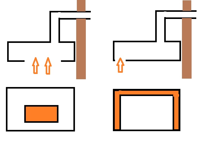

When you say the steam spills out the front & sides is this making you think there is a problem or is the steam condensing on things close by. The reason I ask is that it is normal for a vortex to form around the edges of the hood which makes steam swirl before it is re- sucked into the hood. You may find it does not happen as noticeably on a lower speed.
Some extractors extract from the periphery of the hood while others extract from the centre of the hood.
Extracting from the periphery can be much more effective at trapping and extracting fumes and steam but tends to be noisy with higher air velocities involved.
