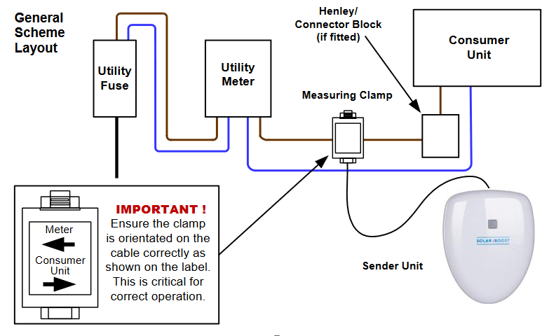

I'm running SWA cable from the house to my Garden Room, I'm planning on installing Solar Panels on the Garden Room. Both, Garden Room and House will have a hot water cylinder. I was planning on using one solar power diverter to feed both tanks.
Can I run a 4 core (L, N, Earth, L from diverter) SWA from the house to the Garden Room, PV on Garden Room, Solar Diverter in Garden Room feeding the tank in the garden room and use one core from the SWA to feed back to the house directly to the tank.

Seems technically possible, my iboost has two outputs for two immersions. You can get stickers that warn of needing to isolate at multiple points, I would want to make it really clear to someone who didn't know the house.
Hi JJ, the garden room tank is only 120l and used rarely, so all it needs is a top up. Once hot it would feed the main tank in the house. I would like to avoid any feed back to the grid.
I am waiting for an iboost to be fitted, I thought it would be fitted where the solar panels are, but seems they want to fit it where the tank is. Reading the instructions it seems they are radio linked. Radio Range 1 to 30m indoors (dependant on construction and local conditions). So looking at this.

Are you having a grid connected inverter? Most diverters won't off-grid work as they detect the excess being sent back to the grid.
... And even if they could, the means of control is not suitable for where the available energy is a hard limit. They work the same as a phase cutting dimmer, so for example to run at 50% of power, they activate at the peak of the sinewave, so while they reduce the RMS current in relation to the required power, the peak power doesn't follow the same trend, it'll stick at the same value until you get below half then start reducing.
Its not a problem when there is infinate energy available, although I'm not quite sure how the meter ends up integrating it all (whether you end up buying the peaks from the grid, or whether it gets averaged out over one cycle) but if you are on a strictly limited energy supply from a off grid system, you could find yourself with not enough energy to hit the peaks even though in RMS terms its perfectly loaded and the inverter might start dropping the voltage/ shutdown / or actaiavte a bypass contactor
Your original idea with the 4 core cable should work. Personally I would use 5-core so the circuit back to the immersion in the house has its own neutral. You will need to take the immersion circuit out of the CU in the house and connect it to the 5 core with an MCB in a separate enclosure suitably labelled or a fused spur box.
You may need a separate earth rod for the Garden Room so it is TT earthed, rather than exporting the earth from the house presuming that is T-N-CS.
