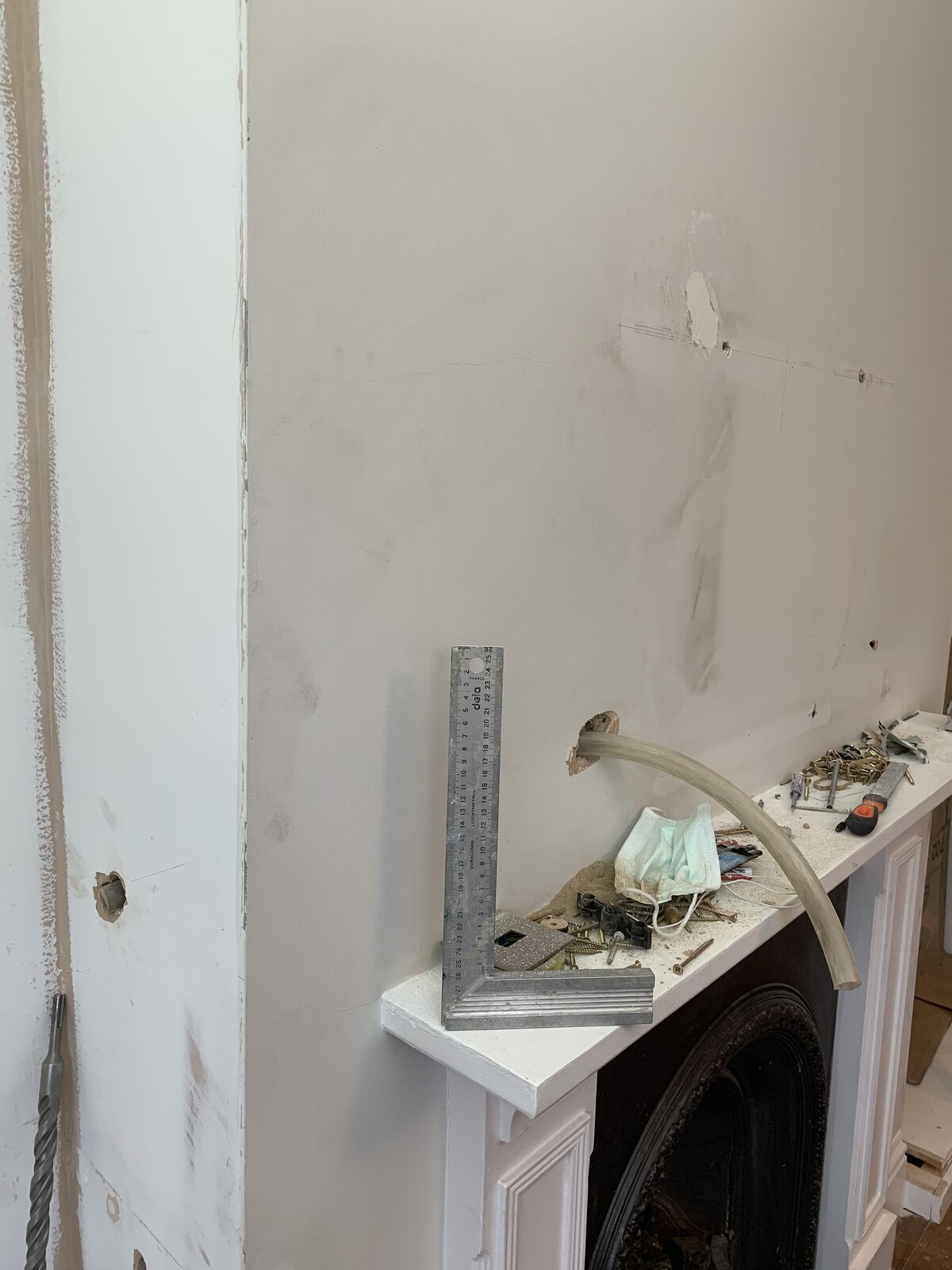

Hi there,
I need to run a speaker cable through the flue of my fireplace.
I've drilled a whole through the mantelpiece (on each flank) and got a clear vinyl pipe via which I'll have the cable run, so I need to isolate that vinyl pipe from the fire that will be 5 inches or so below. I also need it to be heat insulated so that it doesn't melt.
I've looked for sleeves such as the Rockwool Pipe Insulation sleeve (for example here) but was told it wouldn't be suitable.
Would you have any suggestions as to how to go about that? The vinyl pipe may not be the best option, but I couldn't find any pre-insulated pipe to have the cable run through.
Note that the fire is a gas one, so fairly small flames and not extremely hot either.
Any suggestions would be most welcome,
Will

Actually it’s 20in from the base of the (artificial) coals and around 12in of where the flames would get to when the fire is on with maximum gas.
Heres a picture:
I was thinking of one fire resistant layer and then one heat insulated layer. So for instance a heat insulated sleeve inside a copper pipe (although I would rather avoid a rigid pipe because I’m going to struggle to get it through if both holes aren’t perfectly aligned...).
@Madrab Your second point obviously worries me because I’ve already drilled the holes. But why is that a problem; the fireplace is already open onto the living room, so why would holes in the side of the mantelpiece make things any worse?
Any incoming gas is in the pipes and when it comes out to be burnt, if there’s a monoxide carbon leak, it would get into the living room through the open fire wouldn’t it? Or am I missing your point?
With an open flued gas appliance, you want all the burnt gases to head up the flue/chimney.
Under normal use and if the fire and chimney is working correctly, when the gas burns the heat creates an updraught in the chimney that then draws the air and all the products of combustion (POC's) through the fire front, up the chimney and out to the air, there will be no flue gases entering the room, only radiated heat from the fire.
When a gas fire is tested, one of the tests is called a spillage test, it's a smoke test performed under the front edge of the fire box that checks that all the air and POC's are heading in through the fire and up the chimney, if there is any spillage (smoke entering the room) it fails the test and the fire is shut down and disconnected until it is made safe.
If you drill holes into the flue space then gases (Carbon Monoxide) from the fire could find a path out of those holes and into the room. The risk is small but it is still a risk.
Those holes need mortar'd up IMO.

Thanks everyone. After trying to find multiple routes (under the fireplace, at the back), I finally settled for a sideway cut where the cable will run from the side of the mantelpiece to the front, then run outside the front of the mantelpiece (it’ll be hidden behind a large mirror) and then dive back into the mantelpiece to come out at the side. That way I don’t go through the flue.
Now I need to fill in the holes I made in the flue which is going to be a bit of challenge. I read the plaster of Paris is fireproof and quite good with heat, do you see any reason not to use that?
