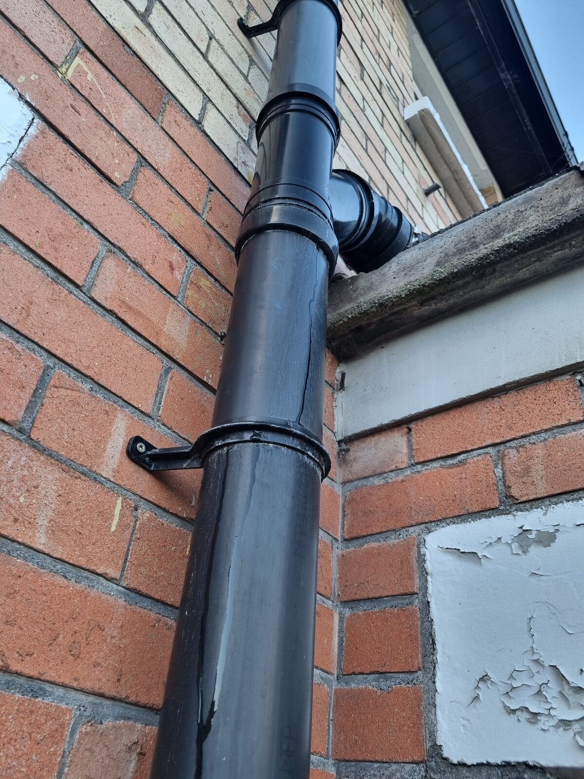

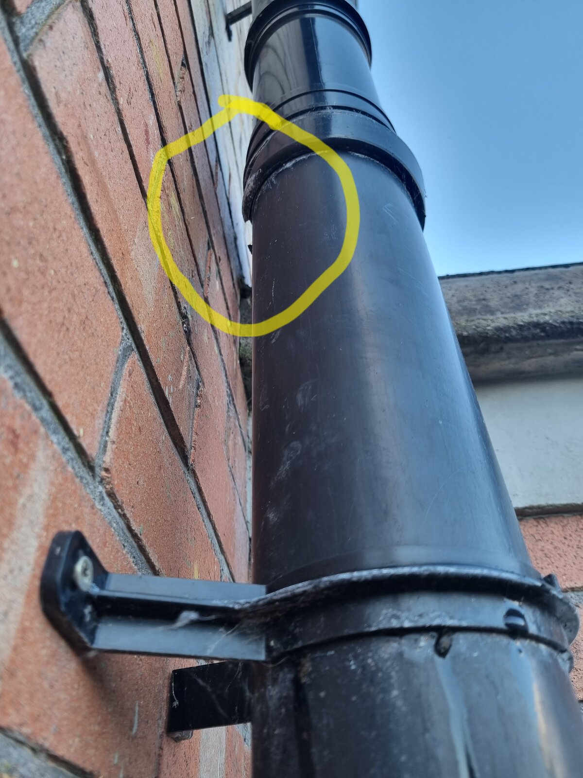

Hi all.
Have a leak on my PVC soil stack, looks like a collar has broken as pictured, the pipe under the leak is fixed into the ground. Do i have options are that dont include digging up the paving and concrete underneath?
Thanks.
Bodge, wrap some Denso tape round it, (filthy stuff, wear gloves and clothes you don't mind throwing away afterwards.)
To do a proper repair, it looks like solvent weld fittings that have been converted to 'Ring Seal' so with some care, you may be able to get the joints apart, and either replace the junction, or possibly clean up the mating surfaces and glue it back together.
