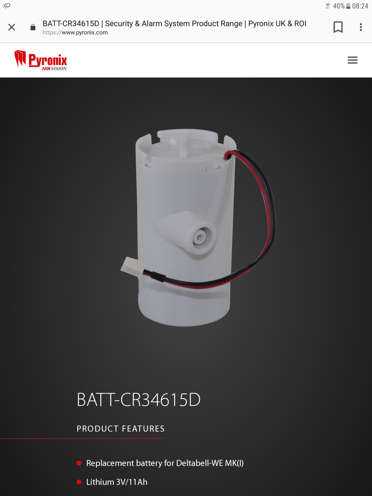

I had a Pyronex Enforcer installed about 5 years ago which has worked fine until recently. Now when I go to set the alarm the following message flashes up;
Active faults
Siren
Wireless low batt
Is this meaning I need to replace the batteries in the PIR's in all the rooms - or just some of the batteries, how do I tell which ones - and could it be other batteries running low?
I'm tempted to replace the batteries in the PIR's to see if that clears it - will opening these set the alarm off, shall I just enter the code then?
Thank you.
The clue is in "siren " ....in other words the outside bellbox ! And while your at it change the pir batteries as they are only around £2 each
The next question ....is the round battery or the two flat ones ? The round one would be my guess at 5 years !

CR123A batteries for pir's
Bell box is dependant on being round or square ?
You will need to look inside the bell box to find out that battery you need.
Screenshot_20181116-082403.png This is for the mk 1 model bell box
