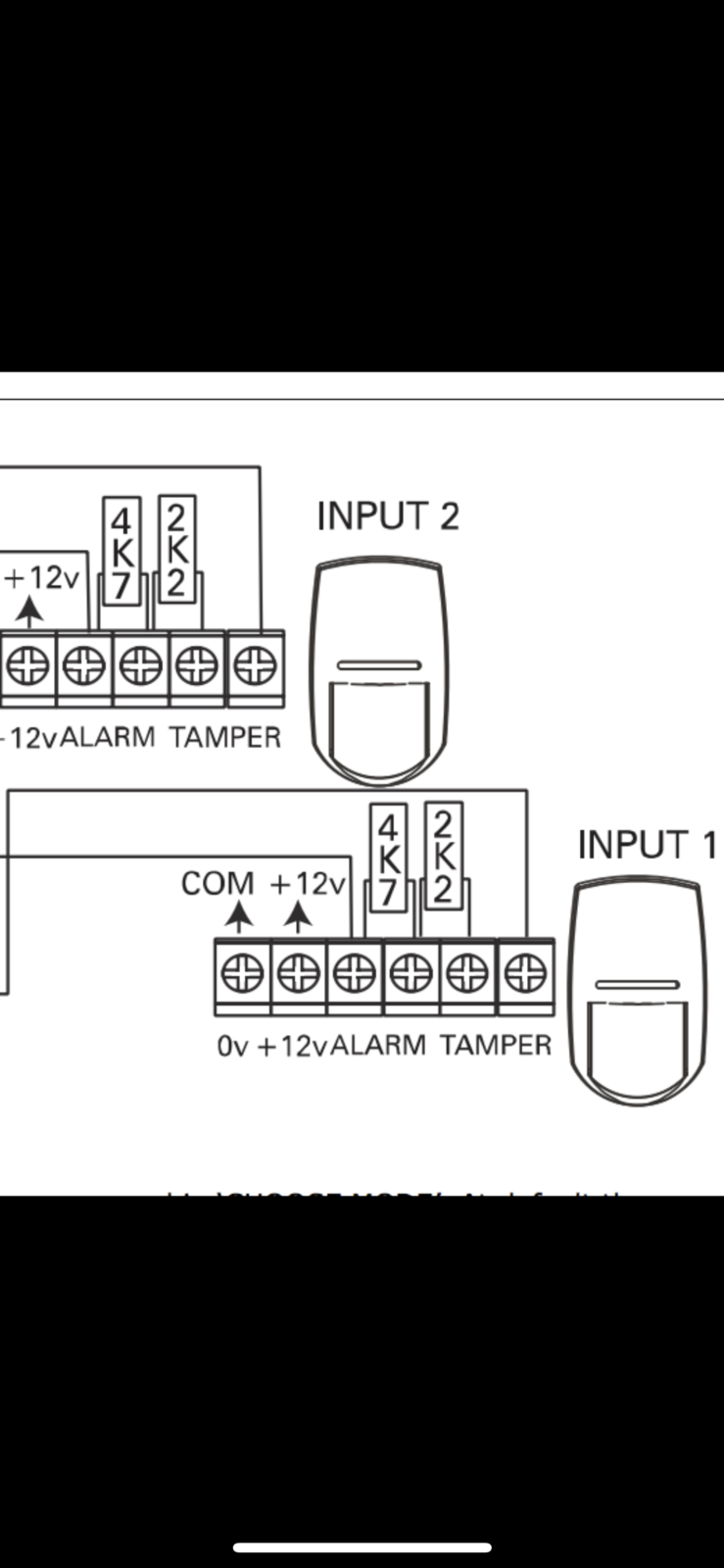

Hi I’ve just installed a pyronix wired alarm system - small system with 3 pir sensors and a door contact ,
now I’ve powered it up today and the siren works , but when I try to arm the system it counts down the arm time and the sounder squawks to say it’s set but the pir sensors aren’t doing anything when I come into the property .
these have been set up as in the diagram below , have I missed something? Do these need setting up a certain way on the keypad? None of sensors or door contact will activate the alarm

Tried walk test , there’s power to them but nothing happens when I set alarm and then try to activate them .
I am not to sure how to set these up on the keypad to work in inputs
the wiring for them is as follows haven’t got a picture .
Out of control panel to put sensor
and wired exactly as image I posted
so com
12v+
2 resistors
Then 1 wire to tamper
As below

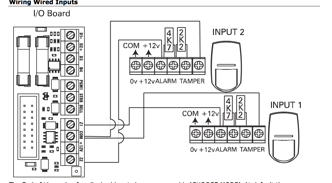

So you’ve done no programming?
By default all 8 wired zones are unused so you need to go to change inputs and change each detector to your desired mode I.e final exit, entry/exit, intruder
also the picture you’re posting is from the wired I/O board on an enforcer not the euro panel.
Clarification please.
Is your control panel a pyronix enforcer, euro mini or a euro 46 ?
Zones can be wired EOL or double pole on euro 46.
You will need to program each zone input to your requirements
Front door final door A ,Hallway pir entry route A ,Lounge intruder A etc
You need to study programming manual as this control panel can be complex if you do not understand the programming terminology.
