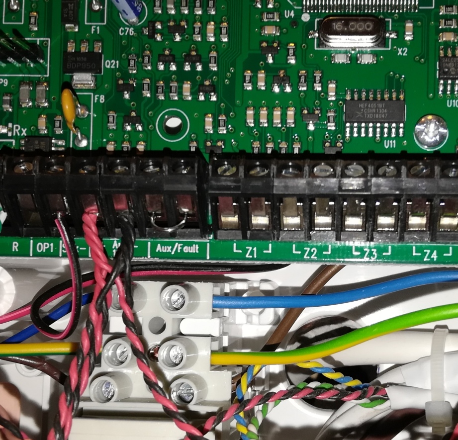

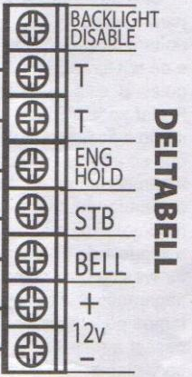

Needing a little bit of assistance if anybody can assist?
I moved into a house some years ago and had an old ADE system in and I think it was a Sigma bell box. The box was in disrepair, needed a battery (one light flashing) and was weathered so swapped it for a new back lit Pyronix Delta box (grade 2) So has the connections shown. Simple enough wire up and off we go.
3 years down the line and the panel started to faulter so I disconnected the system until I got time to install a new one. That time is now. So ordered in a new Texecom premier elite 24 system with wifi connection. Looked like the dangly bits, or so I thought!
Been many years since I have installed systems and even then I was more electrical than systems. Anyway, contacted Pyronix who were arrogant to say the least, asking for company install details etc! I used to have that when I had my own business. Contacted texecom who were abrupt and very unhelpful!
What are the connections from bell box to panel? Any ideas?

The way I see it so far is:
Panel STRB - BOX STR
Panel 0V - BOX -12v
Panel BELL - BOX BELL (or is this +12)
Panel +12v - BOX +12V (or is this bell?)
Panel Tamp - BOX T
BOX T shorted to =12vinside the box?
Are any resistors required in this scenario?

The additional issue, as I have seen it mentioned on other pages is the AUX? I take it that is a tamper cct. There is a reference elsewhere to this but to a grade 3 box Can I simply just omit this?
I found this, what are the fault connections?

WHAT I HAD THOUGHT WAS:
PANEL ---------------> BOX
Panel STRB ------------- BOX STR
Panel 0V ---------------- BOX -12v
Panel BELL -------------- BOX BELL (or is this +12)
Panel +12v------------ - BOX +12V (or is this bell?)
Panel Tamp ------------- BOX T
AND FINALLY INSIDE THE BOX:
The other T terminated to -ve?

Does anybody else have the connections to the box outside? TIA.

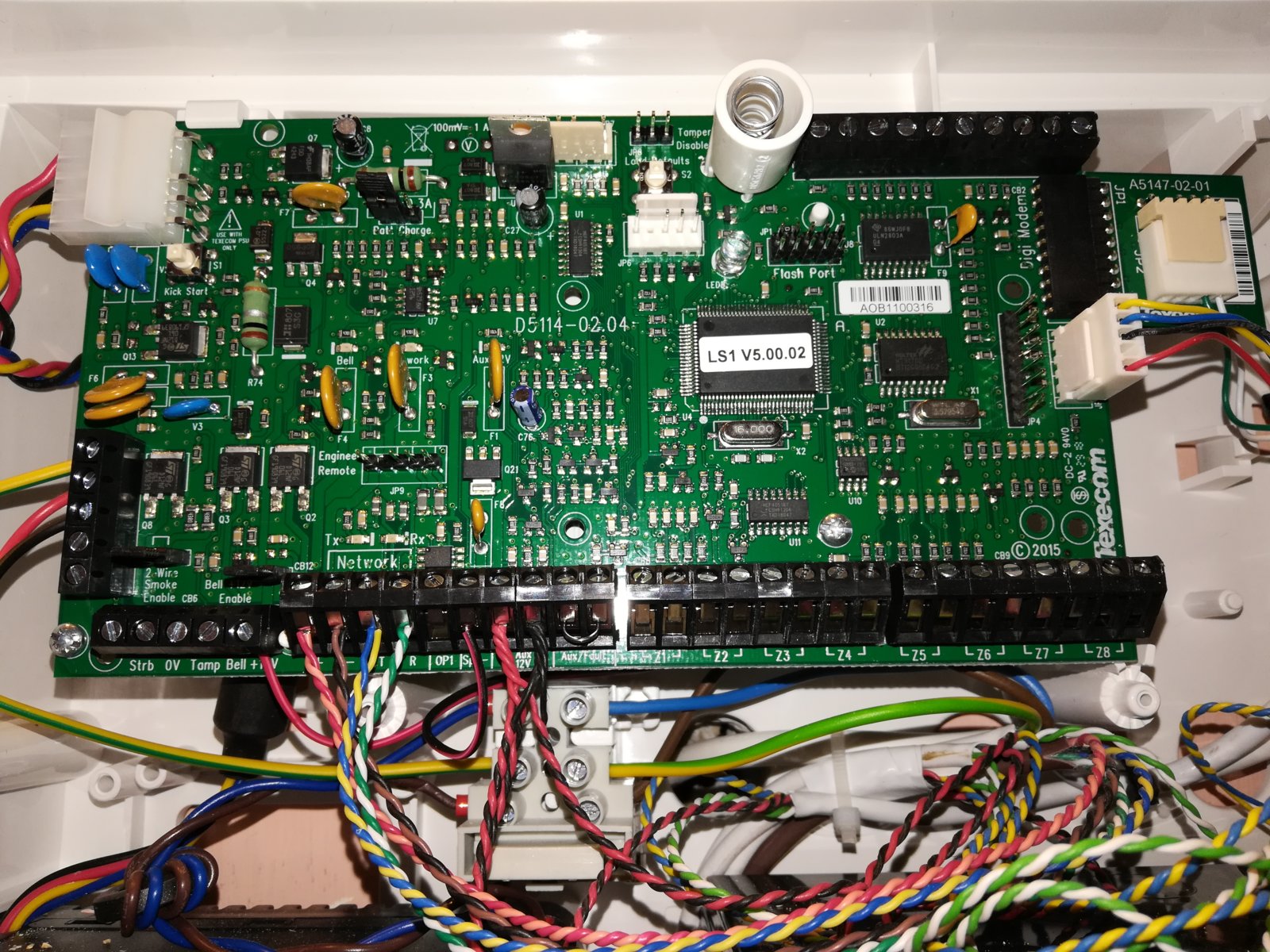

Which bell box do you actually have?
We are wiring to the Texecom panel.
What is the issue you are having?
finally if this is on existing wiring, you are best doing this on a short piece of cable directly to the panel so we can confirm you have actually wired it correctly or there is a fault.

I cant help you if you don't tell me what your issue is and confirm this is a new bell box and the full name of the box.
the wiring for this bell to similar systems including diagrams are all over this forum if you search for them and that should make it easier for you.
Sorry bud pretty much what I said in the OP, I need to connect a Pyronix delta bellbox to a new Texecom premier elite 24
If your struggling with a simple bellbox then your going to be struggling setting up a premier panel !
there are wiring diagrams on here if you search.
that will make you more comfortable, the problem is there is more than one version of the delta bell.
If you have wired it up as you mentioned you should be okay, however if you have a fault take pictures of the bell wiring and the panel wiring to confirm.
then try on a short cable if your still having issues

That looks fairly straight forward? Its all laid out. The bell box connections arent. Pretty sure I had them right anyway, merely needed a heads up, thanks anyway.
