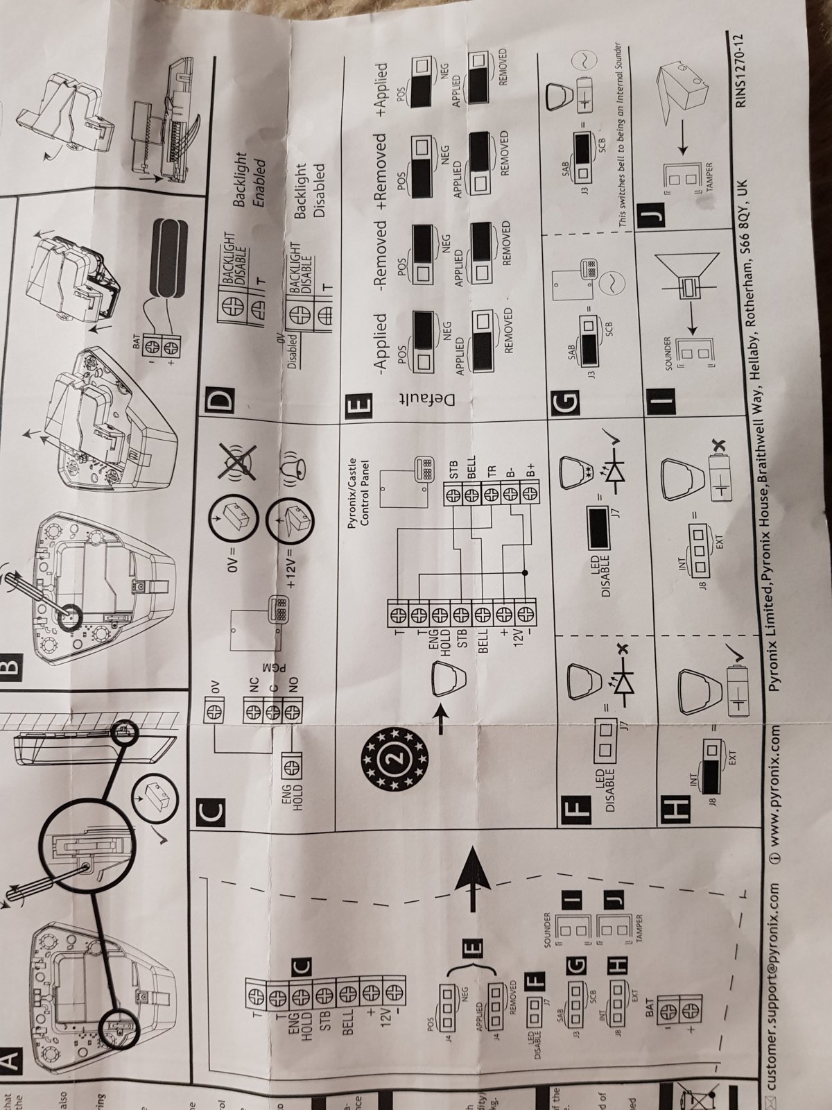

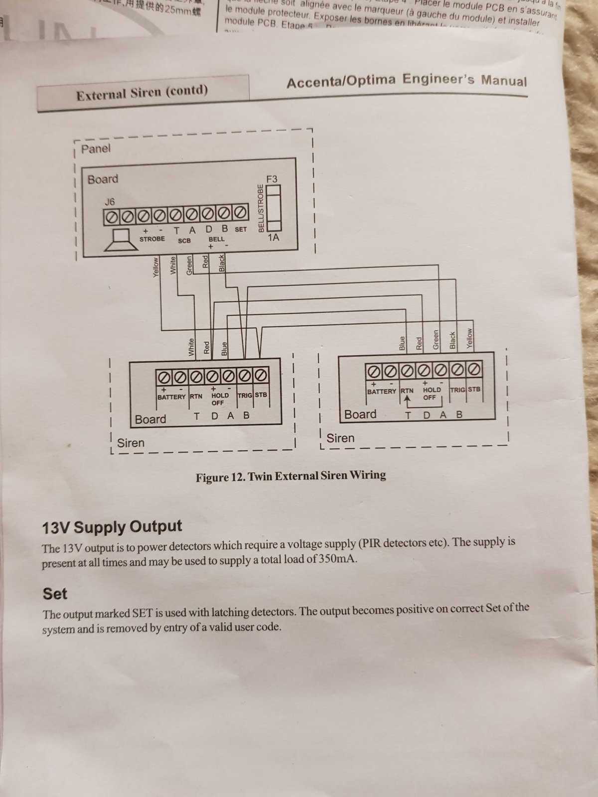

Hello Everyone,
So I have a new Honeywell Accenta alarm control box and 2 bell boxes, One is a Pyronix Deltabell and the other is the standard Honeywell box.
My problem is how to wire both boxes together, I will be honest I have spent ages trying to work it out but to no avail:mad:, so I'm in need of some expert advice.
I have attached some photos of the manuals.
Thanks in advance.

okay have you been able to get both boxes to work independently?
Is the total power consumed when both bell boxes in alarm under 1A?
powering up bell and strobe triggers should be straight forward, its the tamper that is the difficult bit and I believe Breezer has a diagram in the alarm stickys section which may help you.
2nd posting the manuals can be useful, but as we are not checking the manuals to determine if your bells will work, you need to provide photos of the panel bell wiring and both bell boxes.

Thank you for the drawing. I will try it when I get home and let you know.
you can have a go first surely now they are on the bench so to speak.
firstly wire up the delta bell, given your experience, lets start with getting each unit working on there own first. to be fair its only the tamper loop we are looking at, thstas they complicated bit the rest should be all direct as you can see from the diagram I hope.
Omg. It's all working.
So i set up the deltabox to work on it's own. I had to link the top T terminal to 12v- and the tamper fault went away.
After testing it to be sure it's working I followed the drawing you sent and it works perfectly with both boxes.

Hi guys just been reading your posts. I have currently just bought a accenta gen 4 panel and a pyronix Delta bell plus siren I am looking at the connections and the drawing which you provided is this the correct wiring to connect the siren to the panel?
In the pyronix it does show a link between -12v and T (top one) I'm guessing this would work correctly

Thanks for posting the diagram....I have purchased 2 Deltabell boxes (e plus) and would like to connect them to my Accenta/Optima 3 panel (replacing my old pair of SABs). Do I need to use a relay to connect the 2nd box? or can advise on the connections I need to make based on the diagram above? I intend to connect and test boxes connected to the panel before installing on the external walls
thanks in advance
