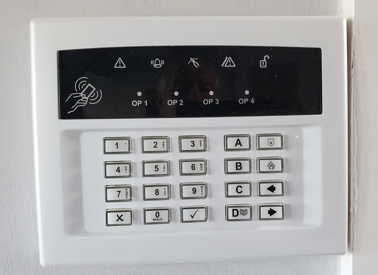

Hi All,
Upon setting, My Pyronix Enforcer beeps 7 times for 7 seconds before starting the setting timer (15 Seconds continuous tone)
Is there a way to stop the beeps and go straight to the 15s setting timer after you enter the code?
Thanks in advance for any help.
Cheers, Tony.

to sparkymarka - no sensors in hallway (exit route) only a door magnetic contact, so don't think its a sensor error, yes if you open the door during the 15s continuous exit tone it changes to a beep, beep, beep,........ But always does 7 beeps before the continuous exit tone, whatever you do.
Don't know if this makes a difference, but we are entering the code on a remote keypad, not on the main panel.
It's mystery.
Tony.
Wireless I think, but I didn't install it, it was there when I moved in - see picture, if that helps

Well I’ve just learned a wireless keypad onto an enforcer and there’s no intermittent bleeps
All devices closed
It does this whilst arming the wireless devices before the exit period starts. You can stop it by not using any wireless devices.
