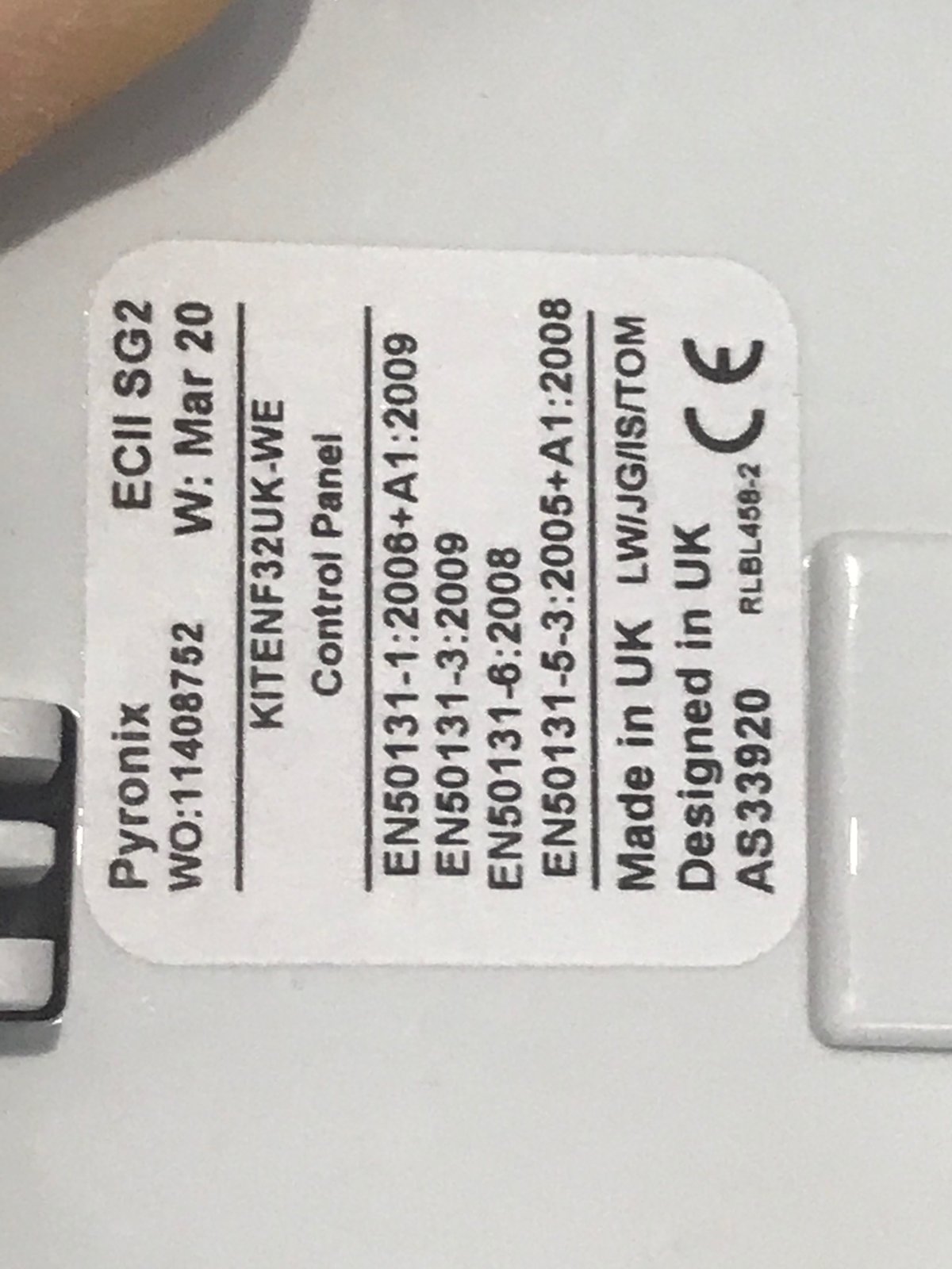

If I buy another control panel (the same) can I just use the front part and connect up to what is already in the back half? Obviously the system name will change and I will have to re-commission from scratch but would like to re-use the back box & electrics if possible.
Yes ....it should have two year warranty ... look inside at the back of the panel for warranty end date
Quality Control date on the back of panel is 13 December 2017 so do I have 2 years from then? It must be at least a year regardless. If so will Pyronix, as the manufacturer, swap it for me as it is faulty? I do not think the eBay supplier I purchased it from is still trading.
