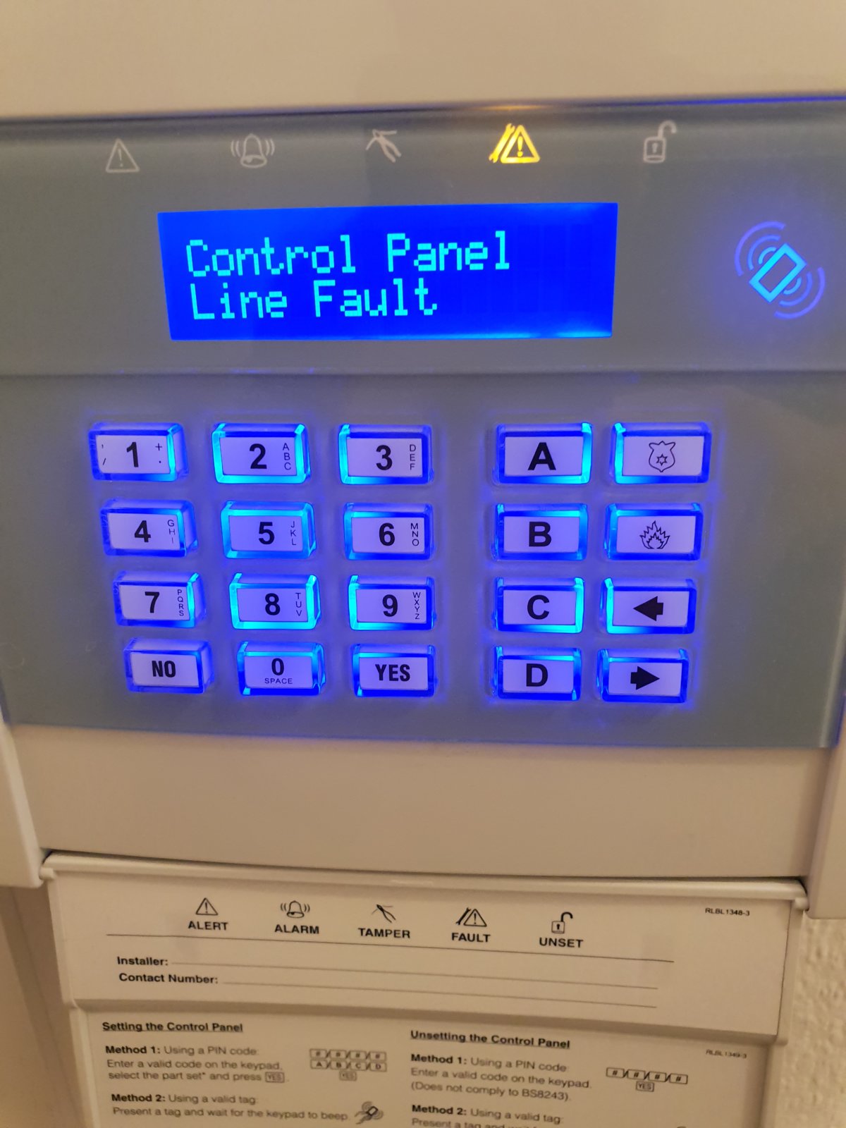

Pyronix enforcer fault
12 Jul 2008
607
16
Wiltshire
Guys my alarm won't sent and I get a control panel line fault.
It's a GSM unit, could a deactivated sim cause this?
If so is it as simple as putting in engineer mode and saw the sim over?
Thanks.
Just in case anyone comes across this with the same issue yes it was the sim and yes engineering mode disabled the tamper.
All sorted.
