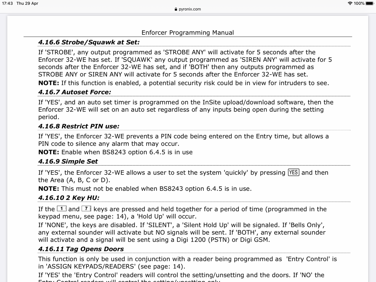

Good afternoon people,
Please could someone enlighten me as to why when i have fresh started the panel in yr 2000.
Added new user codes and set the alarm with master manager or new user codes it will let me set but NOT unset.
Only after alarm generated ??
I have codes set at "o" for unset/set and flexi set,although i dont think it makes any difference.
I have an final set exit, an entry route and another sensor for night set "FX"(stairs)
I know this should be simple but i dont know how this has been introduced into yhe system.
By the way i am bench testing before fitting.
