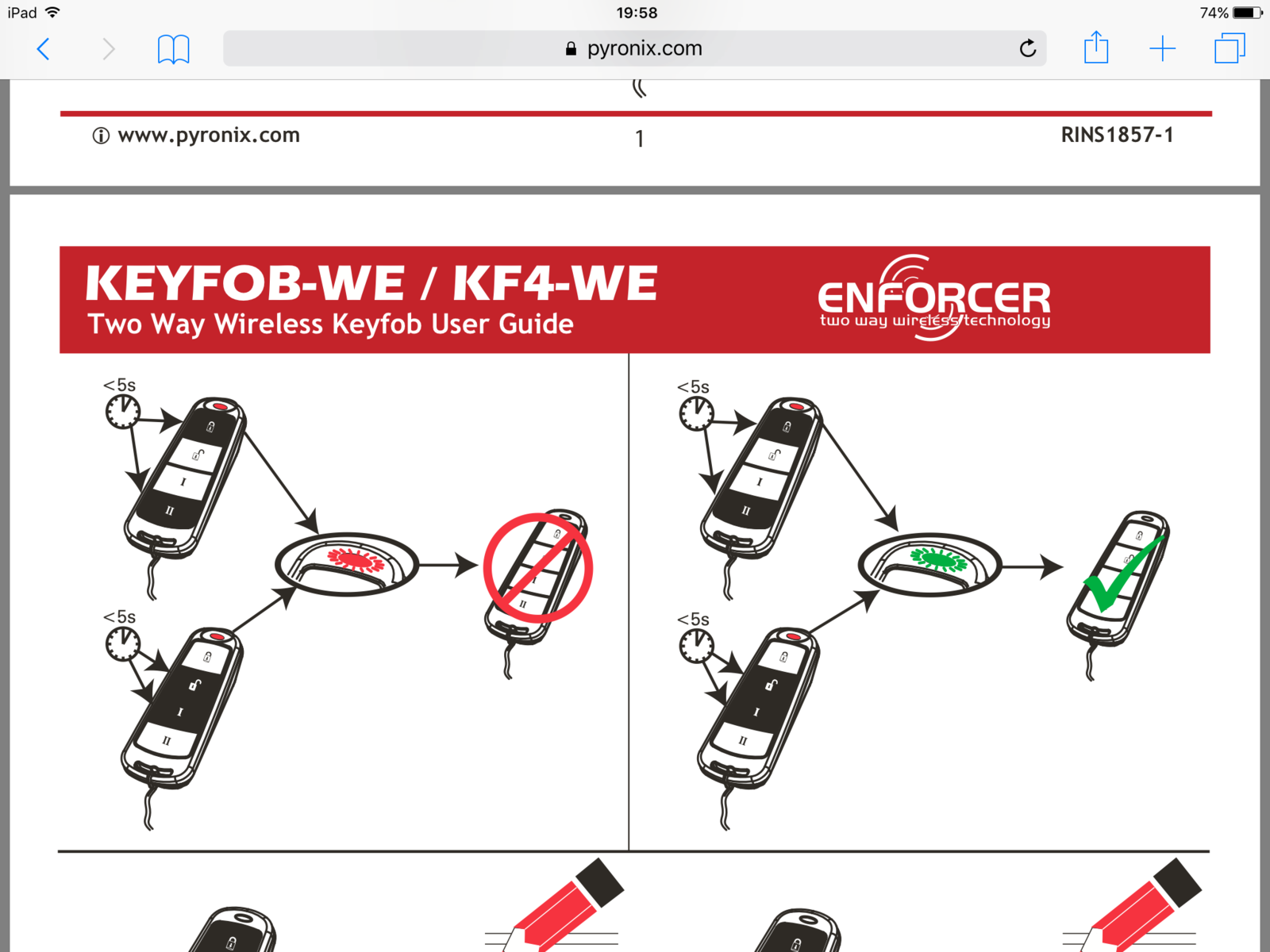

Hi, I have a Pyronix Enforcer system. My KF4-WE key fob is on the blink. Sometimes when I press any button I get a single amber flash. Sometimes the red and green LEDs flash alternately for over a minute.
The battery is fine (I have tested it and also swopped it into a second fob).
I have tried removing and re-adding myself as a user, and I have tried re-programming the fob to my profile on the panel. The fob won't communicate with the panel at all.
Is it kaput? Thanks in advance for any insight
Have you tried defaulting the radio fob ( via the fob buttons ) and relearning it again ?
I have found ,you have to delete the fob and relearn again within a few seconds ...
thank you - I have successfully deleted and re-added myself :)
I am not celebrating just yet as I did this at the weekend and it went on the blink again within 24 hours..... watch this space.

Hi Alan - turned out it was a faulty key fob battery with me after all, double check your battery, try a different one, reprogram it... good luck
