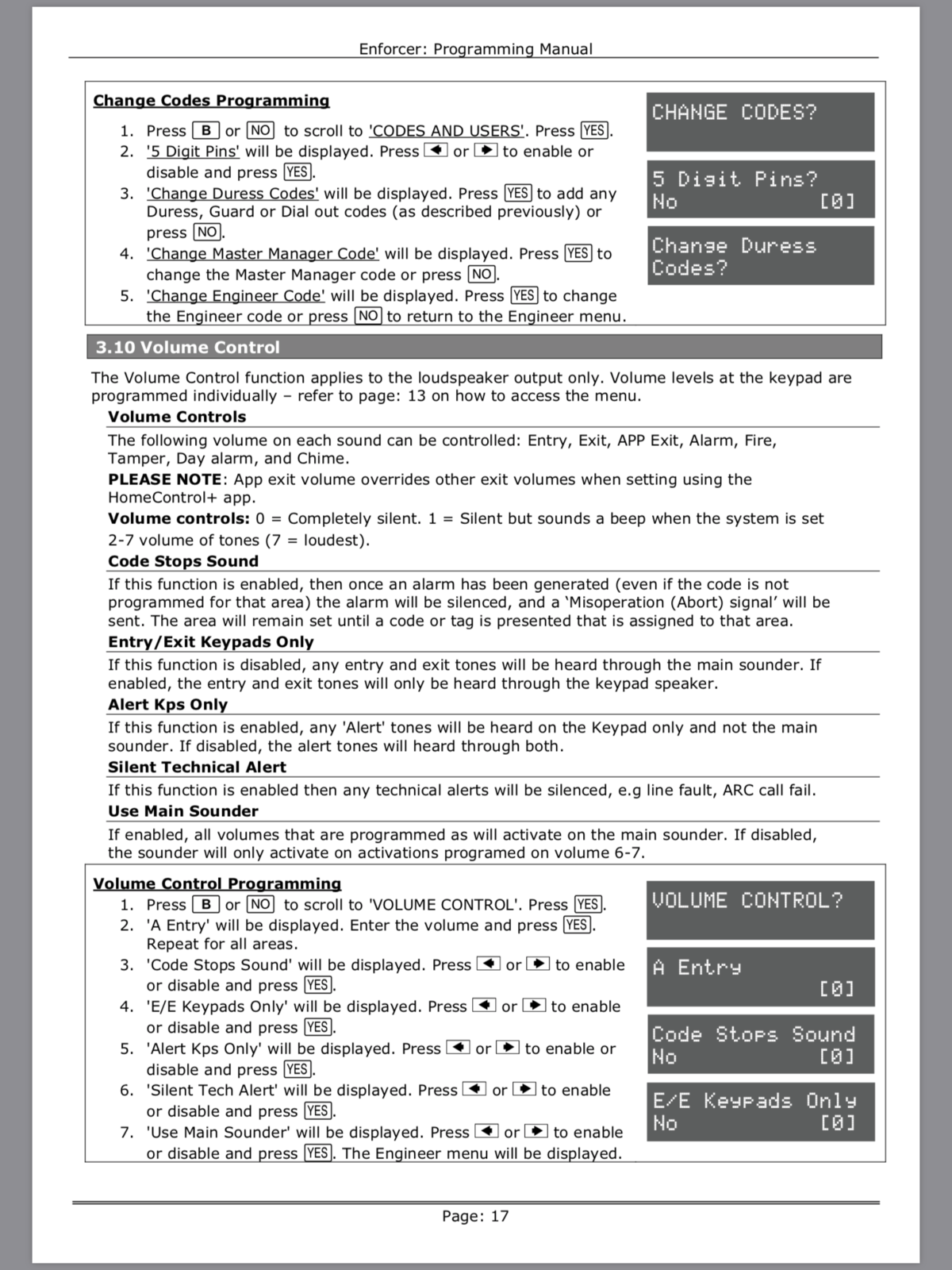

Where are these options? I only have Systems Sound Demo menu, nothing to change the volume/type of panel noise. The one that's currently there is deafening.
In engineering installation manual. See attached page
Enter engineer code into alarms panel, cycle through to volume control, then adjust the option that suits
