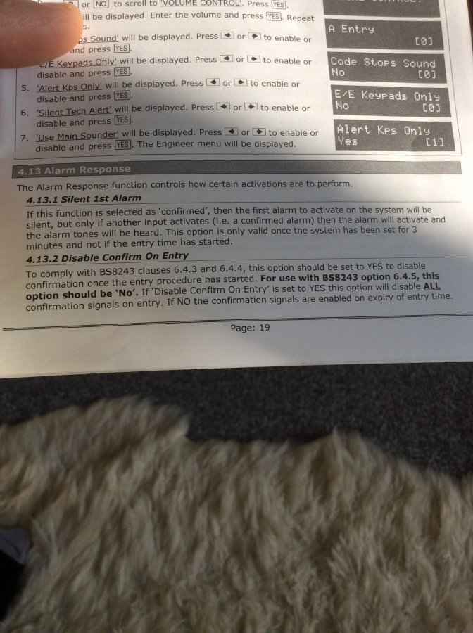

Can someone explain this in eniglish layman. I've tested my alarms in that
I unlock the door & trigger the entry time And enter the hall thereafter walk into the lounge.
I want the alarm to blurt all the bells and whistles......clearly this is not the case at the moment.
Some sort of secondary timer triggers when I enter the lounge.
Lounge should be programmed as 06 Intruder. Exit modes should be programmed as Final Exit. How is it programmed at present?
Alarm responce > silent 1st alarm Never > Area A starts at Digi. or select Bells if Digi is not used but I dont think it makes a difference. Do you get an entry timer when opening front door? Exactly what happens when you go into lounge? Can you trigger full alarm on any other detectors?
