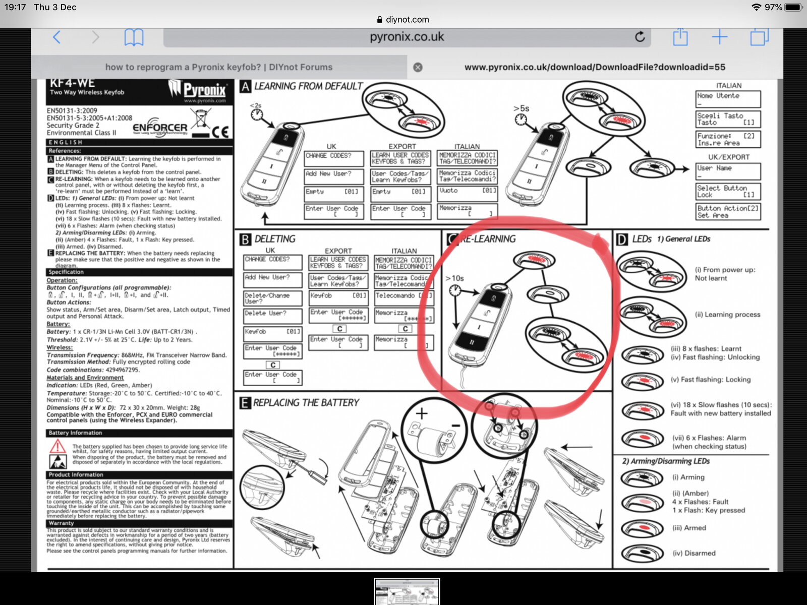

I can’t seem to add a key fob, but that may be the two new fobs I bought off the bay. I tried adding a user, pick a location, instead of code, press and hold the lock button, an orange light is emitted, but the panel doesn’t add it as a user. Will chase that one tomorrow.
Tomorrow, it’s also add a bell time, we’ll see how that works out.
Will report back progress adding the next bits, I may ask for help as it reads a bit more complex.
Yes, they were new, other. Tested not used.
Have just been looking at one of your other posts where you mentioned defaulting the key fobs. Haven’t found the process for this yet.
Is it a button press combination?
Update, have found Spakymarka’s kf4 manual which I’ll have a go with later.
That’s one problem that is no longer a problem. thanks sparkymarka.
relearning worked a treat, two new fobs for £20, came as part of his kit he didn’t want.
