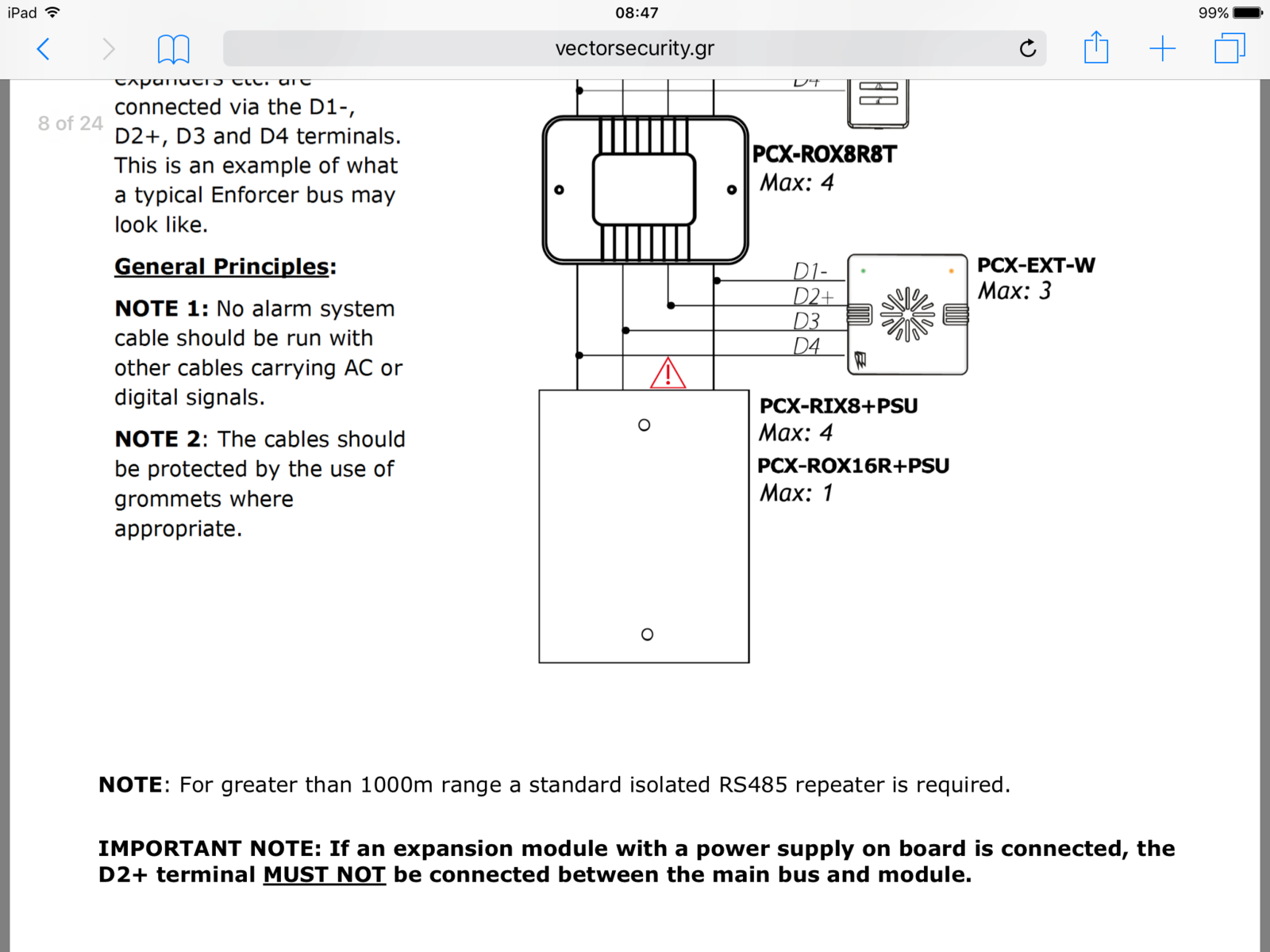

IMG_1783.PNG Why you can't just google it is beyond me ....lol
Up to 1000m
Google is very useful but imo there's no substitute for experience - although I'm still not convinced that vocaliser will trigger!
Link ONLY the two NEGATIVEs 12v between the Vocaliser and the seperate PSU.

Sorry - more questions (but I have used google!) So, I've now got an external 12v psu for the vocaliser and an oem8r8t module. Before I power up I'm looking for reassurance that I'm correct - for the oem wiring : on the 485 bus "in" I will have the d1,d3 & d4 from the 485 bus from the Enforcer panel and then connect the 12v psu to d1 and d2 on the oem bus "in" also ?? If that is correct and I then connect the vocaliser +ve & -ve direct to the external psu will I still need to common the -ve from the vocaliser to the com terminal in the Enforcer panel or will it pick it up through the d1 terminal on the 485 bus from the oem ? - if that works then I've got oem programming to look forward to - not found a lot on that yet!
Yes ,but no need to common up as the bus line includes the 0v anyway , just leave out the +

.....and it all works! Out on interest, on the Enforcer display panel there is the letter "c" after the time - does anyone know what that is there for please?
