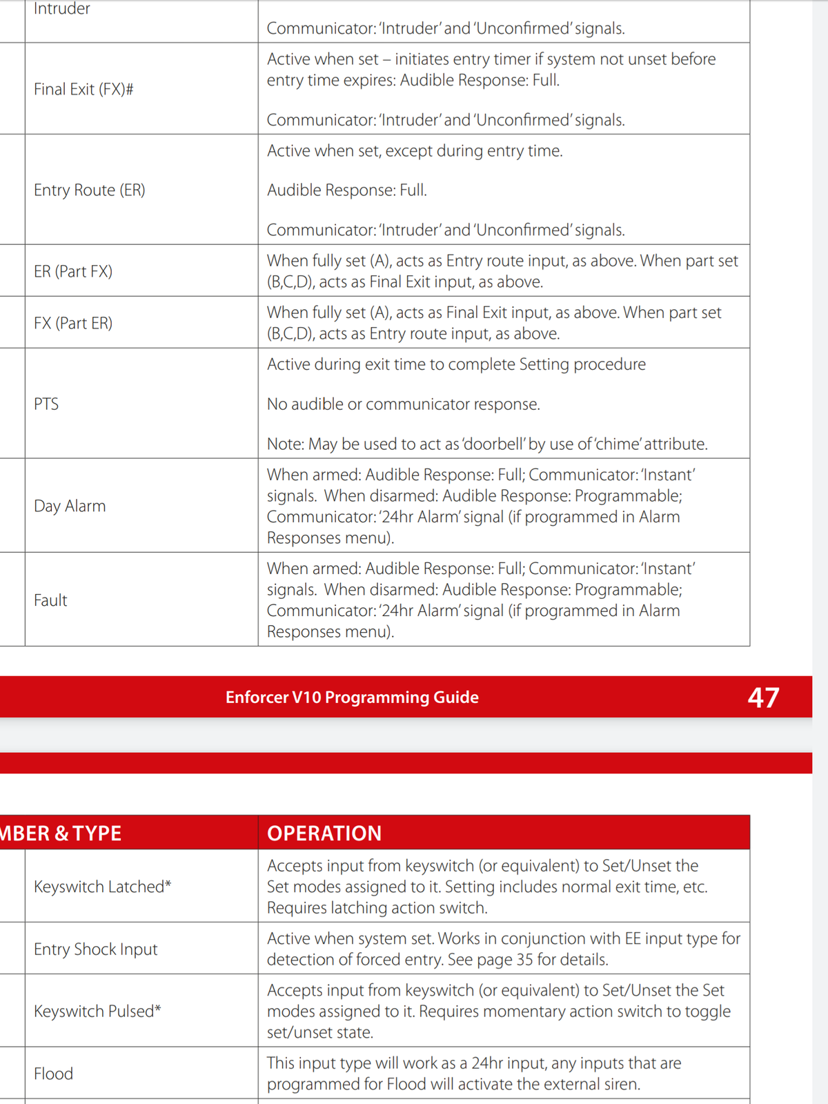

hello all,
could someone please tell me what 'Day Alarm' means? or does? when i configure it on Enforcer V10? i can't understand what it means or how it works or when it get triggered?... any explanation would be appreciate it so much.
thank you.
Screenshot_20210612-075336.pngThis Is 24hr zone,it will trigger when alarm is set or unset.
13 Day Alarm When armed: Audible Response: Full; Communicator: ‘Instant’ signals.
When disarmed: Audible Response: Programmable; Communicator: ‘24hr Alarm’ signal (if programmed in Alarm Responses menu).
Basically its a 24hr zone.
When armed or the disarmed and activated gives an audible response and it can be programmed to signal when disarmed
Isn’t the beauty of it not the fact you can also programme the audible response to off when triggered when unset?
So it doesn’t necessarily always sound whether set or unset?
what the point of a 24 hr zone that your unaware is working may as well be intruder?
although to be fair if its signalling I can think of some uses for it where having it on silent maybe preferable when unset. have to say don't have any panels using 24hr zones, although some are armed day in and day out for the most part.
