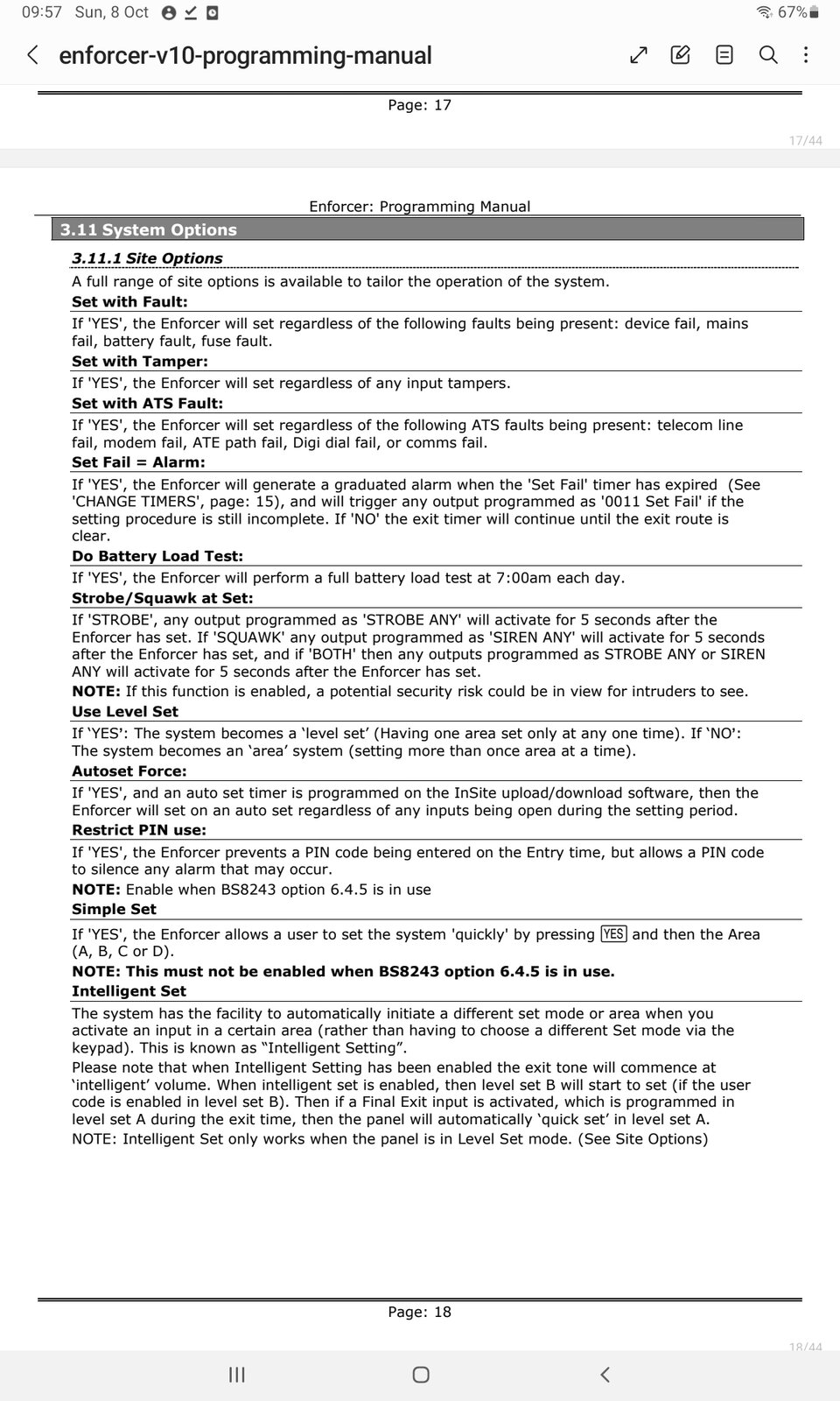

Hi Folks, I have recently install a new wireless system complete with the wireless Deltabell. Everything is working fine apart from the final beep to show the system is alarmed. The control box beeps but the deltabell doesn't. I have checked over and over but can find nothing in the instructions or on the internet regarding this. Have I missed a jumper or switch? Also is there any way of doing a full arm on the panel without having to open the final exit door? I do tend to arm off my phone most of the time but it is sometimes a little bit of a nuisance. Any help would be appreciated.
Is there any reason you want the bell to confirm the system is armed? I ask only because it will drain your deltabell batteries quicker. If despite this you want the feature turned on you’ll find it within system options and under strobe/squawk at set
Regarding the final exit door change the exit mode to timed/final rather than final

Thanks for the help people, got the squawk working now and also timed exit, unfortunately when re-entering my code does not disarm it although my fob does?
Excellent, no idea how that changed. All working ok now - I think LOL
