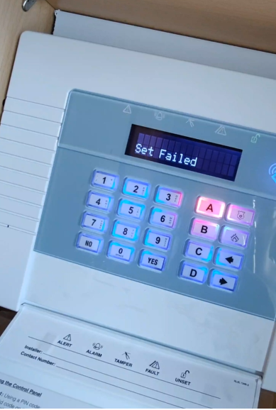

Hi All!
I'm in a bit of a strange pickle here with my Pyronix Enforcer v11 on my own property (domestic).
I wired it all up and programmed the inputs & Keypad, finally got time today to try arming the thing but it fails and triggers the Alarm every time.
Now the only error code I receive on the screen is "Set Failed", no codes or reasons just that, but strangely I can set it completely fine from the Pyronix Home Control App, I've reviewed the logs but they have no additional information.
Tried both main panel and wireless keypad with Zone A & B (both are identical at the moment) to no avail.
I've performed walk tests on the inputs, x2 Door contacts- Entry Route, 1x Passive - Intruder and 1x passive- Walk through, they all function correctly.
Does anyone have a clue what could be going on?
Cheers!
