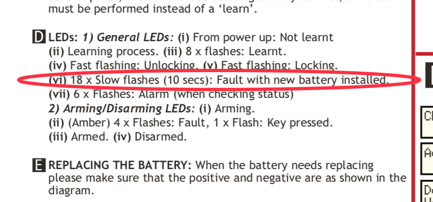

Maybe a faulty battery
I Have this version of Keyfob (manual capture attached) but no mention of red and green flashing together. However, I have checked then installed a brand new battery as you suggest, but with no change in the result!
Yes this is the keyfob I have. Did the nvm reset....but....still the same situation :(
Now then....progress. As I stated at the start, we've moved into the house and inherited the Enforcer system, so it's been a learning curve. It came with two keyfobs, and in theory everything functioning correctly. When I found the keyfobs not working, with totally flat batteries. I purchased two new batteries and installed one in the first keyfob, and have been working with that keyfob and getting all the symptoms in this thread, assuming it was my lack of knowledge that was the root issue.
Just now, I thought I'd fit the second battery to the second keyfob, and to my surprise find that it is working perfectly !!
So, I reckon we can call it a day, and that the fault lies within the duff keyfob....who knows why.
