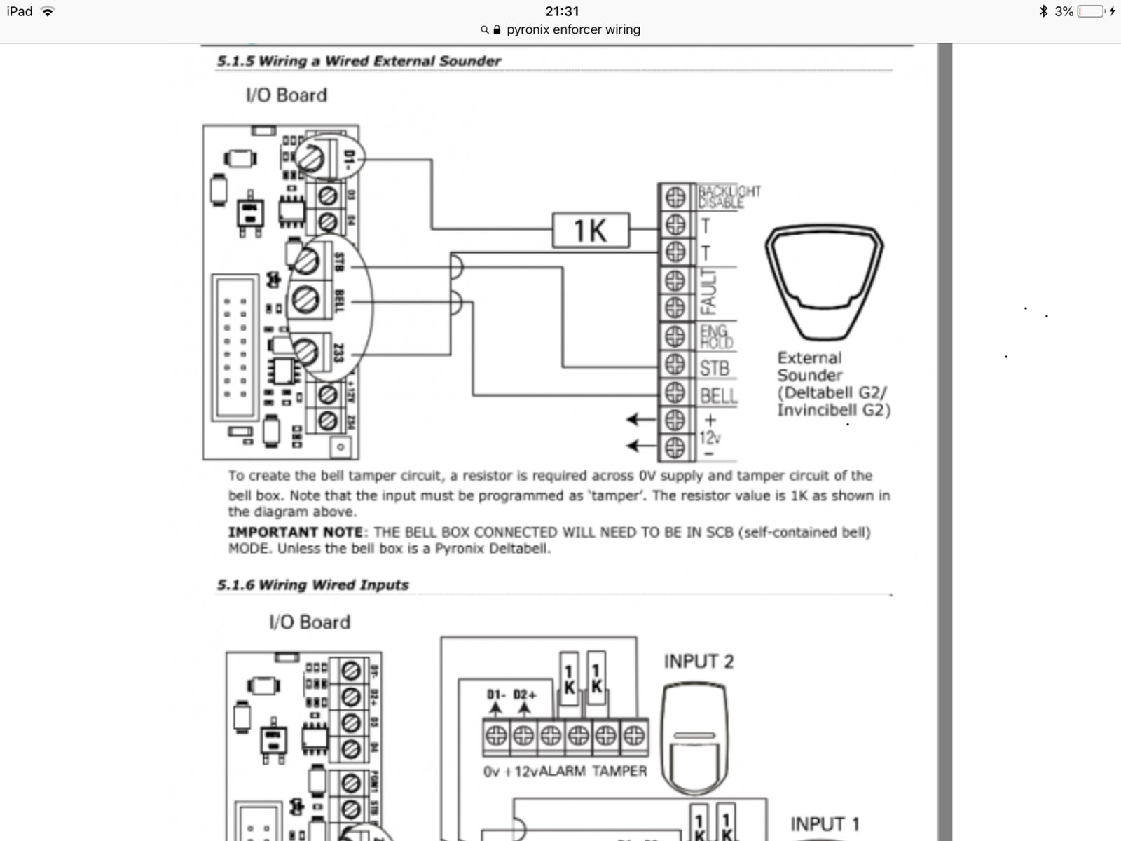

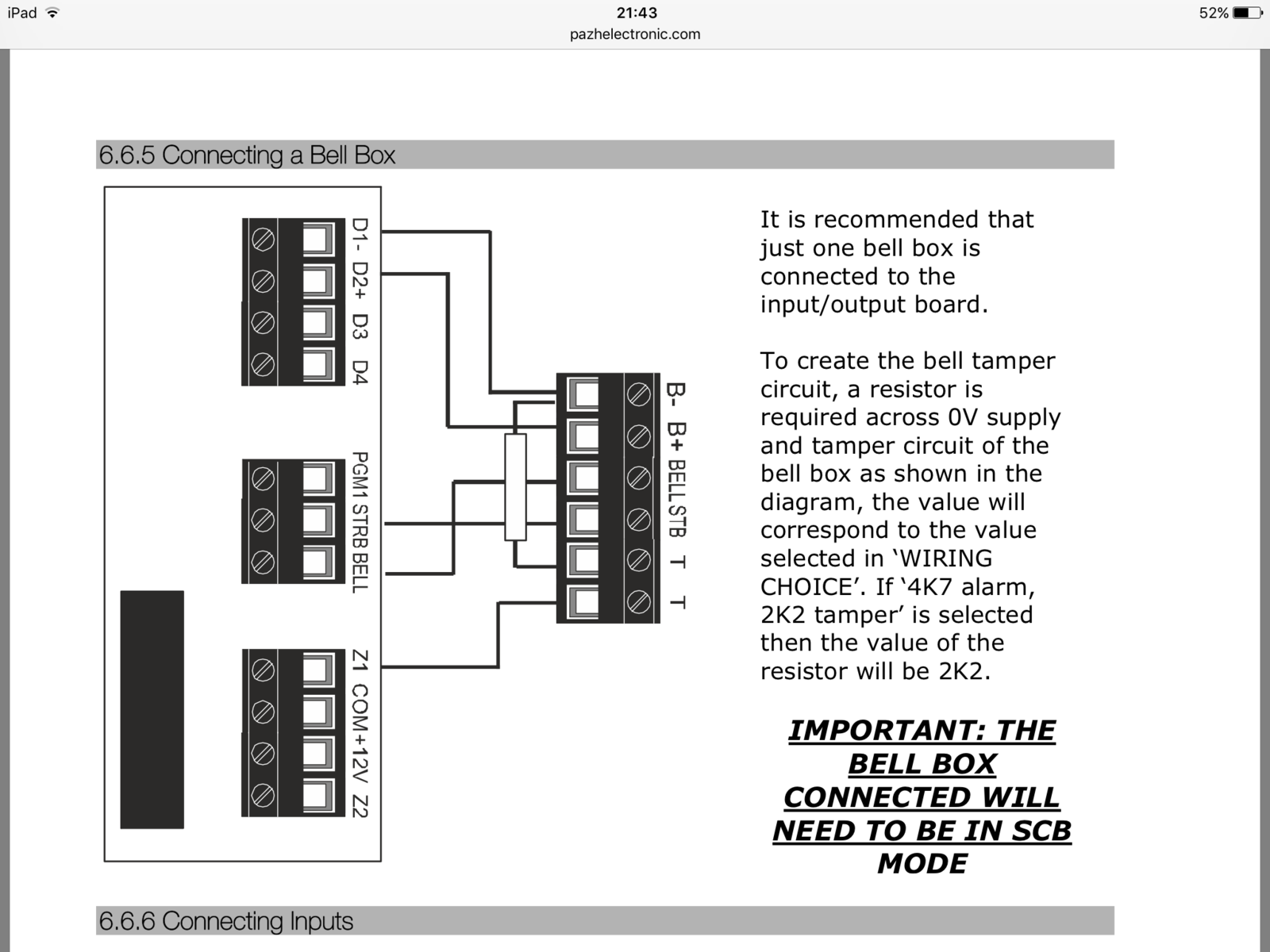

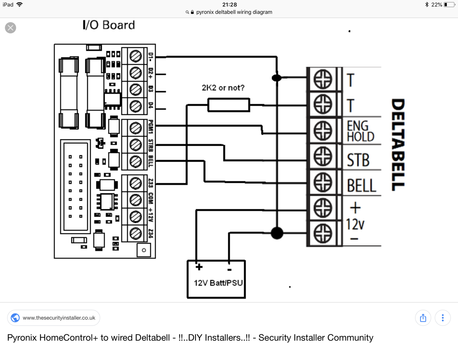

Hi,
I have recently purchased a Pyronix wireless enforcer kit 3 and want to upgrade to the delta bell X with led light box. Looking at the wiring diagram in the instructions and from the limited detailed information online I cannot see where the 12v+ and 12v- are connected on the I/0 board.
I can clearly see a terminal for the 12v + but not 12v- although there is a COM terminal next to the 12v + terminal.
Hi,
Thanks for your reply but it is still not clear to me where the 12v+ and 12v- from the delta box terminate in the control panel.
