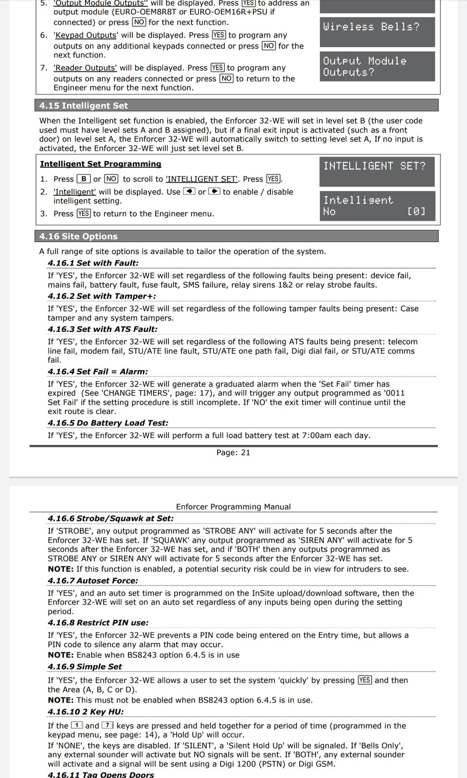

Hi, newbie so be kind. have a vibration detector that has had 3 new batteries (one swapped from another unit which is fine), the panel still says low battery, is there a way to clear the fault ?
I do at some point intend on taking out as it has to be the most complicated over menued system I have ever used, but for now it needs to work, biggest problem is it wont set from the fobs with active faults such as a low battery, which is nuts.
cheers
May have answered my own question, but this may help someone else, looks like you have to fully set the system to clear any faults ? does that sound right ?

Screenshot_20210927-190227_Drive.jpgOne of the easiest control panels to program. You can program the system to set with faults if required. To clear faults code and press no twice should clear most ,but this is dependent on fault.

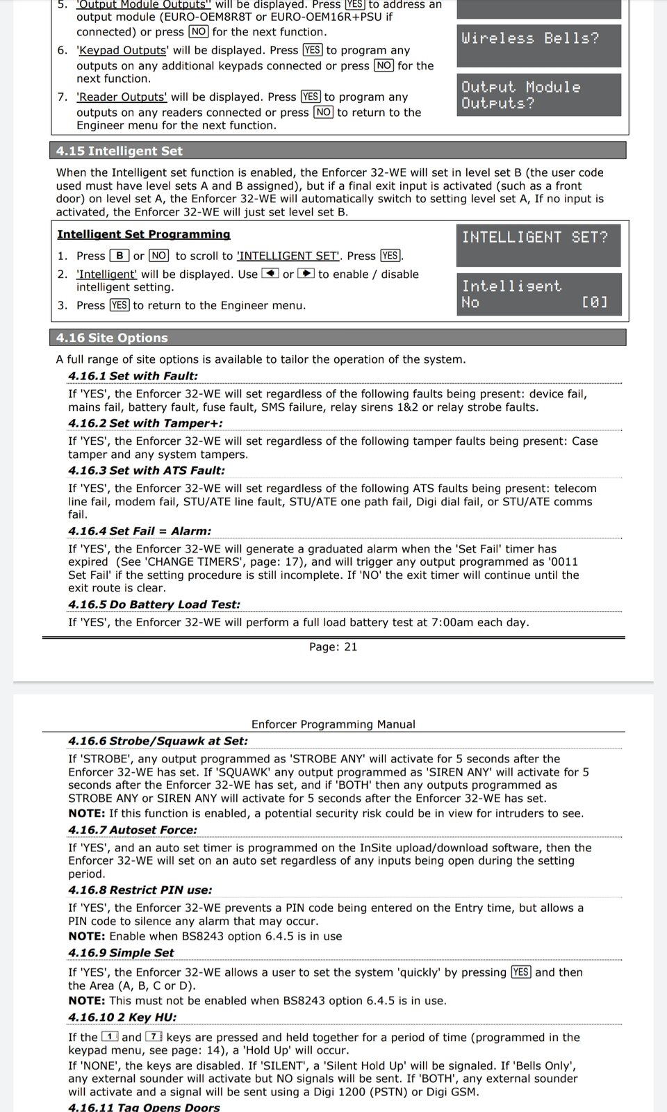

View attachment 245228One of the easiest control panels to program. You can program the system to set with faults if required. To clear faults code and press no twice should clear most ,but this is dependent on fault.

Easy? wow would not like to see a hard panel, the panel refused to clear the battery fault until it was set and unset, no amount of messing would clear the fault, and I search high and low in the menu to set with active faults from the fob, couldn't find anything.
