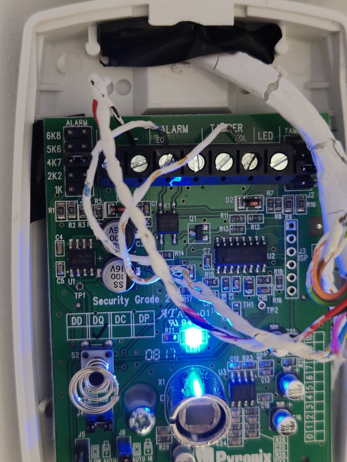

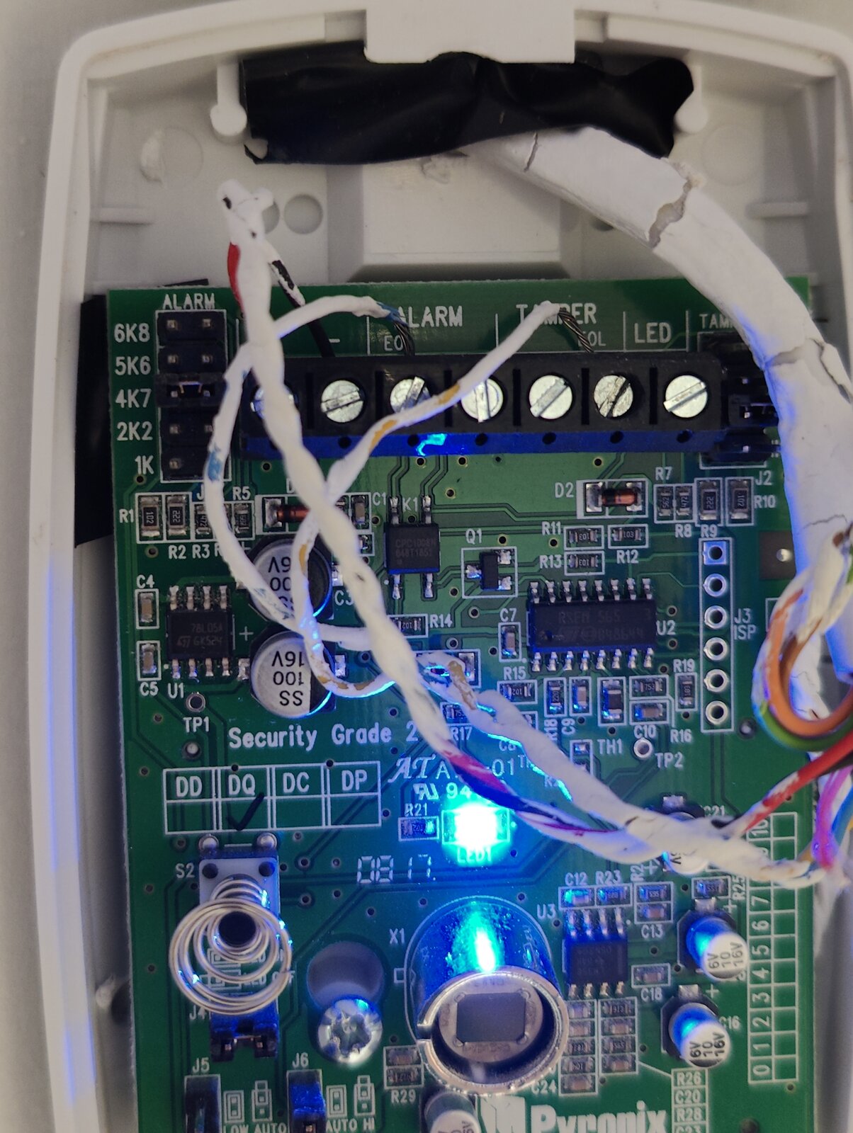

Hi there. Its wired 4 wires - pic attached. Thanks

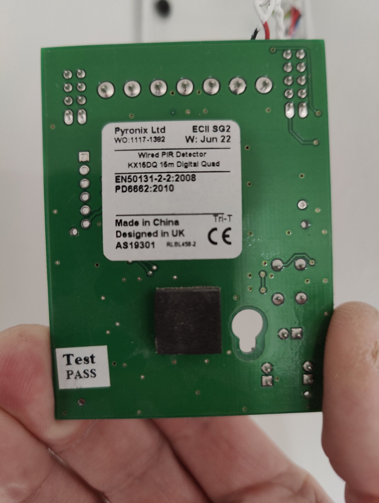

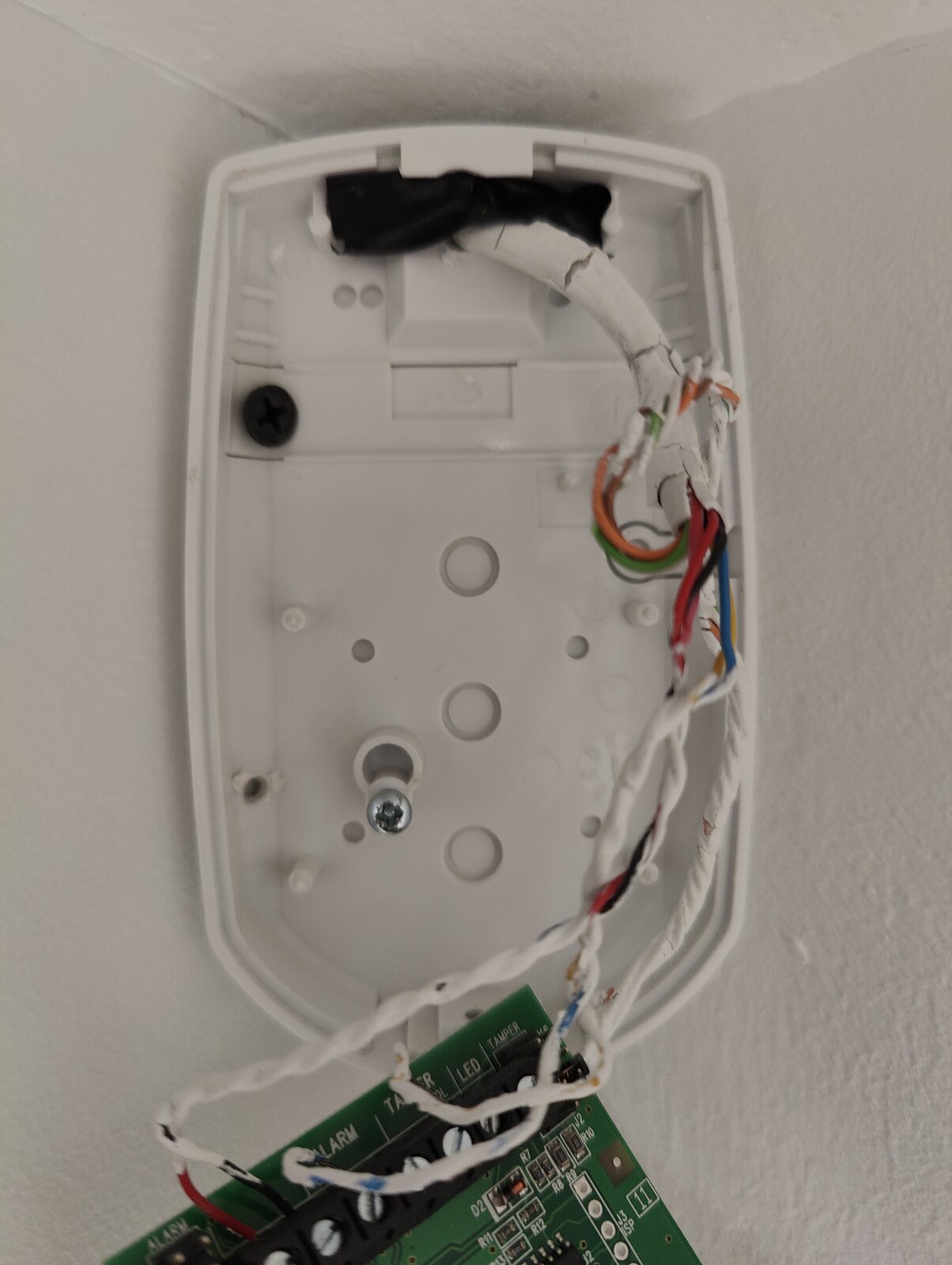

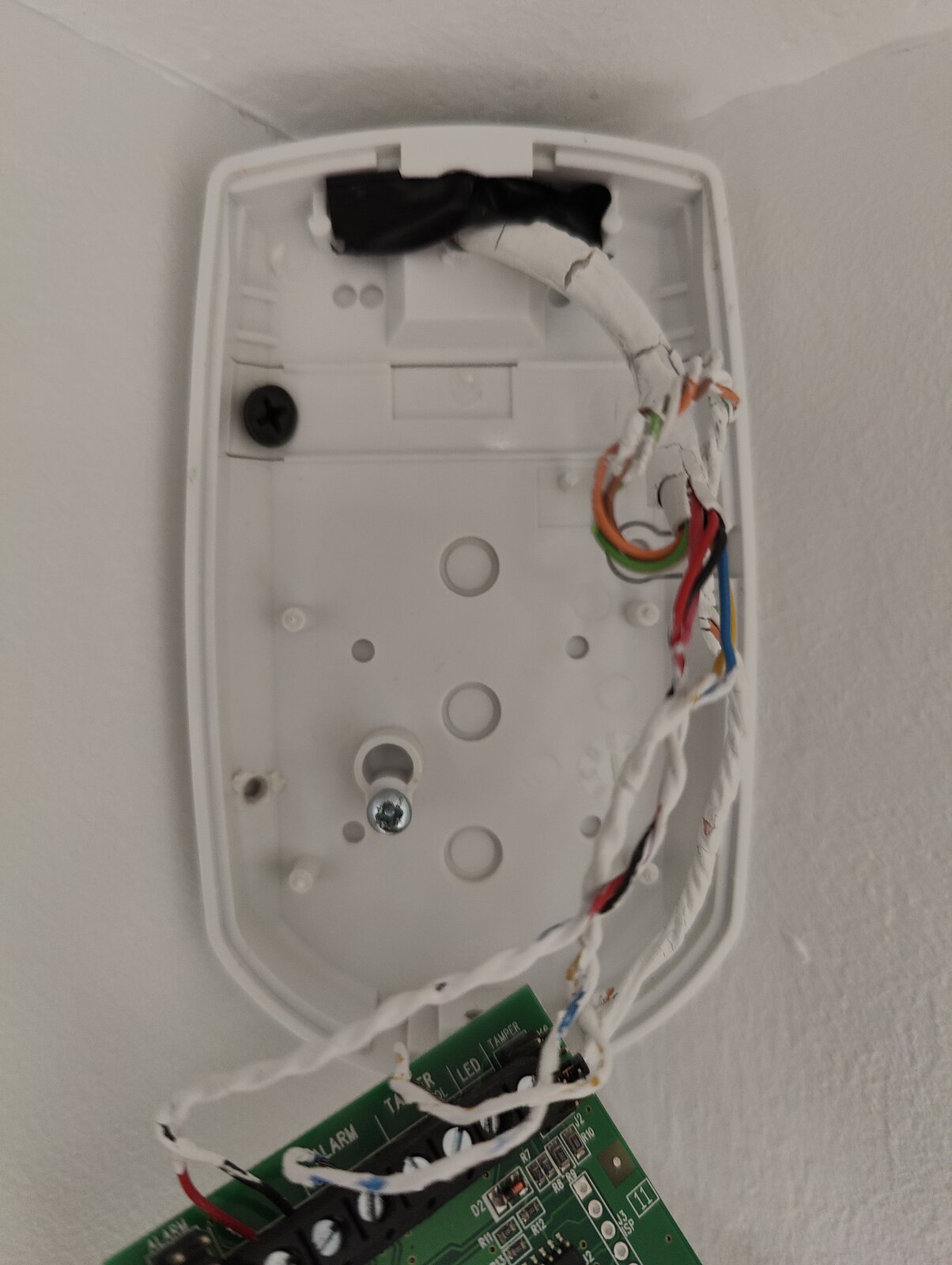

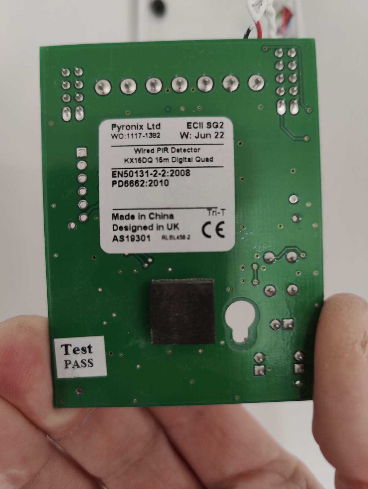

Is the back tamper plastic knockout missing ….? Loosen off the screw holding in the pcb and slide the pcb out ….post picture of detector back plastic mounting plate and the back of the detector pcb ….
The back plate is there. Out of interest how does the back tamper mechanism work? I don't see anything on the back of the PCB. Thanks

No back tamper on that one , stretch the front spring a little before putting lid back on
It doesnt have a back tamper, u need tp check the resistance reading on the blue and yellow if it still showing tamper with the spring pressed down
Got it. 8.3 kOhms without the press, but when the tamper button is pressed, it seems to oscillate between 6.5 kOhms and 7.5 kOhms. Thanks.
Try it without the cables connected to the pir. Should be open circuit with the button not pressed
@Bigsosij, yes, its open circuit when the button is not pressed, after disconnecting wires. when pressed, goes from 2.2kOhms when the LED is off to 8.8kOhms when it comes on.

2k2 is fine, tamper should clear when there is no movement in the room. 8k8 is too high should be 6k9 OC. Could try taking the jumpers off and fitting 2k2/4k7 resistors in the terminals
Sounds a bit of a punt …but ….have you tried it with the pcb out ? Is that black screw top left shorting on the back of the pcb ? Put some tape over it ?
