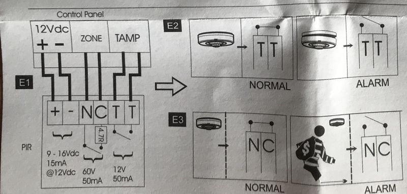

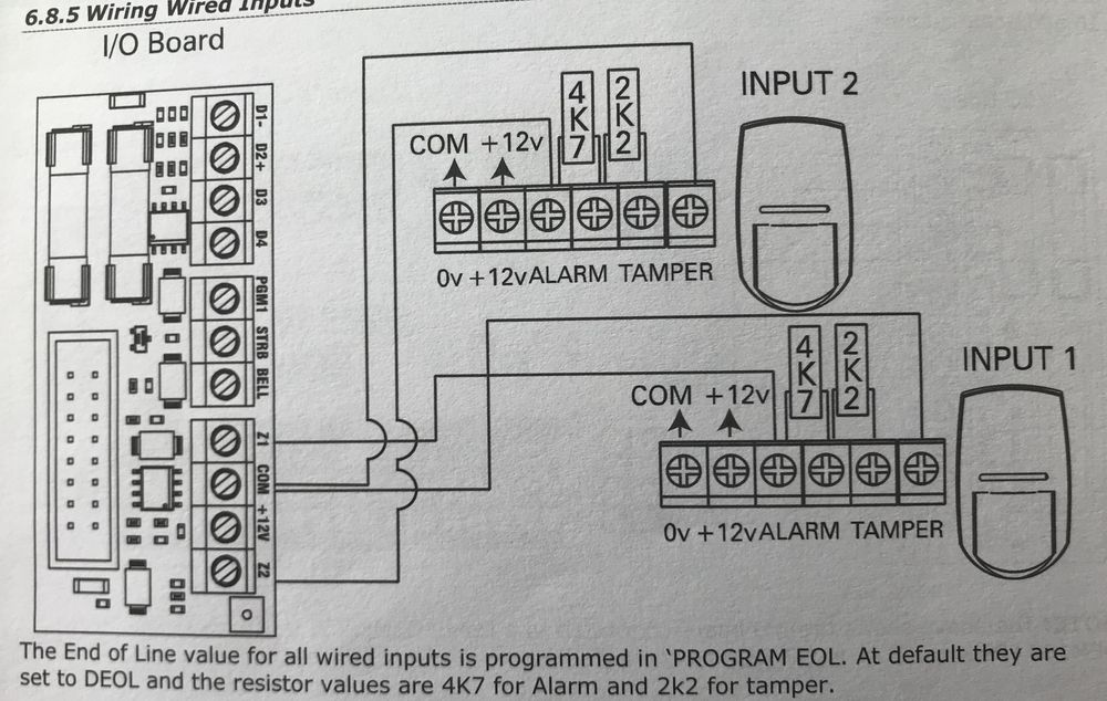

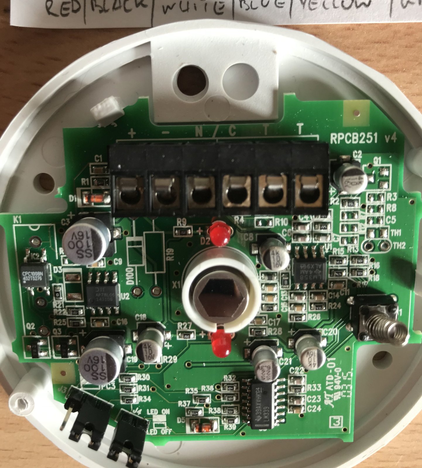

I'm trying to wire Pyronix Octopus into Pyronix v10.
I've tried to do it but witout succes, and after my attempts my other wiresess PIR didn't work for some time [not sure maybe panel needed to settle down...]
Please can you let me know, should I follow wiring diagram from Pyronix v10 manual or from Octopus - this one is not clear for me.
Both diagrams below.

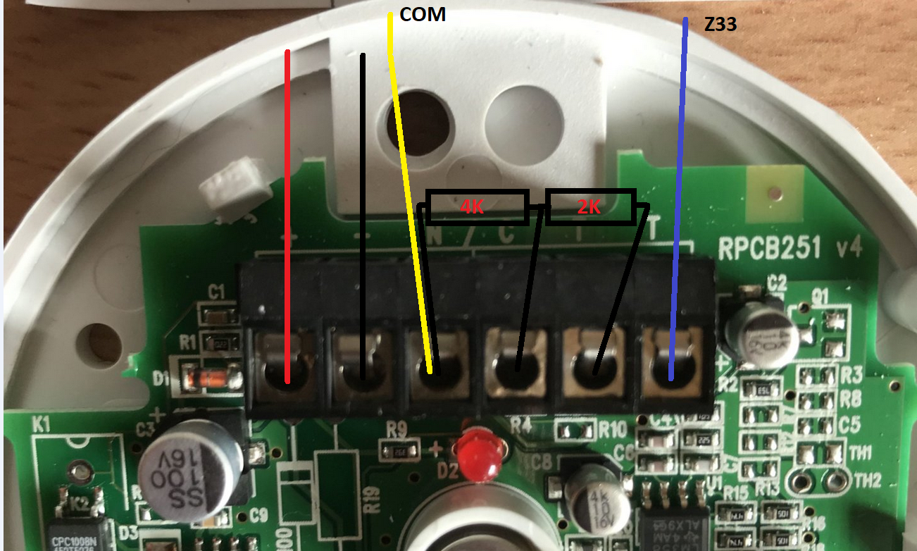

I've wired it with two resistors as per Pyronix manual diagram,
Added Input 33
No faults when saving changes
Getting Fault - "Unable to set alarm" on this input
Done
NO/NC setting was incorrect
Post picture of pir with resistors fitted , also the tamper leg has to be in the common as per diagram
Thanks for reply it works,now
I think I have COM and Z33 wrong way around but it's not polarity sensitive so it should be fine to leave it as it is.
