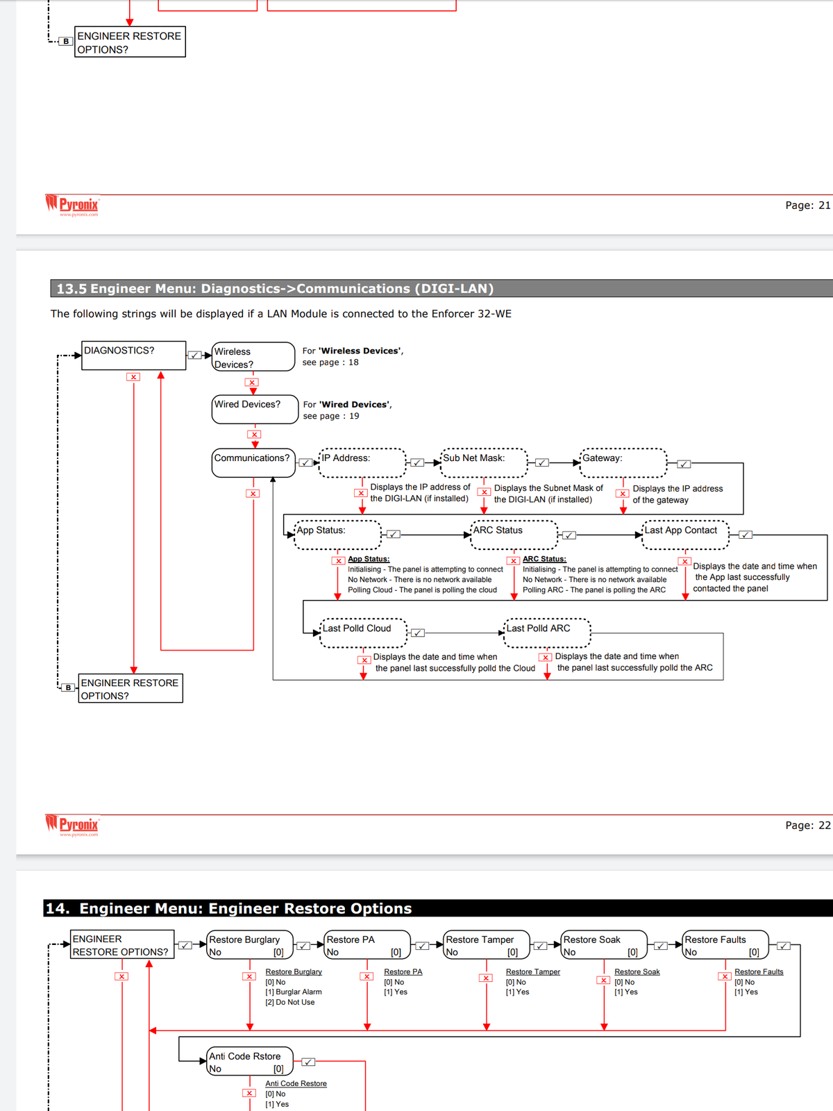

If you put system in engineer mode before u open the cover the alarm wont sound. Whilst your in there u could also check in diagnostics > communications, and make sure system has ip address and is polling cloud
Thanks for that Bigsosij, i also spotted the diagnostic/comms check but backed away when asked - are you sure? Is this likely to cause any grief?
If it asks are you sure then u have gone on to wifi setup. This allows u to use a wifi device to connect panel to wifi network. If u go into diagnostics menu, under that will be communications, this will show you signal strength, ip address, and app status. It should say polling cloud. If it says full network then a panel reboot normally sorts it

Enter engineer mode
Press no until you get to DIAGNOSTICS
Press yes
Press no until display shows communications
Press yes
Display shows signal strength
Press yes
Ip address should be displayed
Press yes
Gateway
Press yes
App status polling cloud
Press no until communications
Press no DIAGNOSTICS
Press A
To exit engineer mode
If no ip address then try re establishing wifi connection first. you can follow this video
Sorry handymanjo, mine doesn’t follow that sequence in engineer mode, it’s a 2016 model, software Rev vo2.20a 0002978benforapp. App status on this unit said basic network and not polling cloud.
