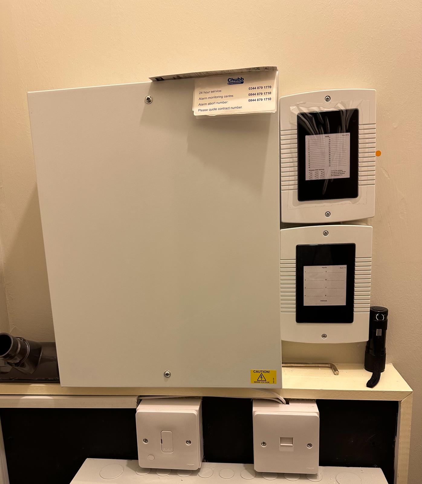

Hi,
We have a EURO 46 v9.1 panel and its been flawless for 9 years running, but looking to upgrade it for new online features
i.e. remote management.
The current setup is as follows:
The system is connected to ARC monitoring via traditional BT line.
The panel is wired up to 9 Pirs (7 downstairs and 2 upstairs) + magnetic sensors for front main door and back door i.e. 11 inputs.
There is main key panel for operations and management; we have 3 key tags for set/unset and also remote key fobs for the same.
Also, the panel is connected to 2 expanders I believe; I think its wireless ZEM32 which works with x3 remote key fobs (to set/unset). I believe it also has 8 input wired expander (ZEM8?).
My main reasons for upgrading is to achieve remote mobile app management of the alarm i.e. remote set/unset, receiving notifications on alarm, viewing status and history of events on the alarm remotely etc.
For the upgrade, I would like to retain a wired setup across the Pir sensors etc. for reliability (also maybe most cost effective upgrade and easier install perhaps).
Ideally would also like to retain the existing forms of arm/disarming via key tags and remote key fobs (where possible).
I am unsure if i'll continue with ARC monitoring (due to increasing costs) or proceed with a bells-only setup. So would still need to consider suitable signalling options if i continue with the ARC route i.e. WiFi or SIM signalling?
I understand that for mobile app control, Pyronix have various offerings i.e. HomeControl2.0/ProControl+
I'm am under the impression that the one to go with is HomeControl2.0. Any advice on this would be appreciated.
As it stands, I believe my options are to upgrade the Pyronix panel - either EURO 46V10 or the new Enforcer V11?
Am i correct to believe that all my existing kit (Expanders / Pir / key panels etc) will be compatible with an upgrade to either of these newer panel options?
Can someone give me any recommendations of which panel is best? (in terms of better reliability, newer, most cost effective?)
I assume with the EURO 46V10 i need to also purchase a WiFI module to enable Mobile App functionality; whilst for the Enforcer the WiFi is already built-in (is that right?).
If consider continuing ARC monitoring, I understand this can be via IP (WiFi) or SIM based. If one goes with the IP approach I assume the Enforcer has all this built-in (due to integrated WiFi?).
Trying to evaluate which panel would be best?
Any tips and advice would be great.
Cheers,
H

I would say the 17 is good value with any replacement included, but how often do u actually need to replace parts... Get a price from a few local companies may find them a bit cheaper im assuming its with chubb going off the picture you posted?
Yeah £17 is fine and would be happy to continue at that, but £37 can’t be good value?
Tbh the system has been good that in the 9 years I’ve only had a replacement battery and one pir! And yes it’s chubb.
