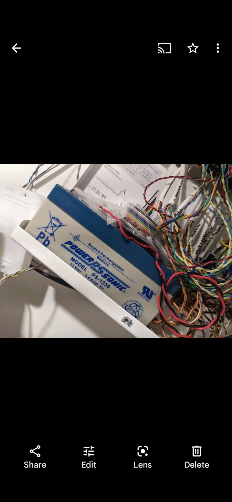

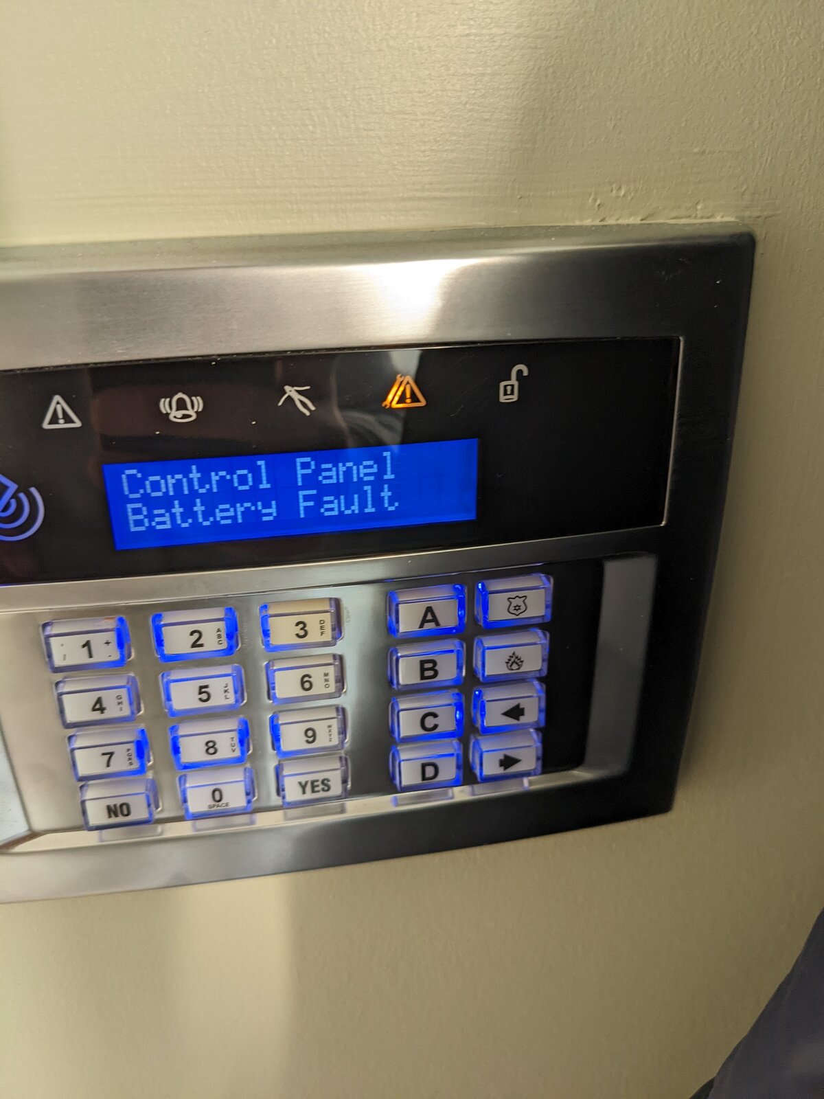

Hi have a pyronix hybrid V10 alarm.
Control panel is bleeping saying "control panel battery fault "
I take it I need to change the battery , with the alarm in engineers mode? I have the engineers code?
Is it as simple as simple as swapping the battery?
Currently is a 12 v 3.4 amp battery.

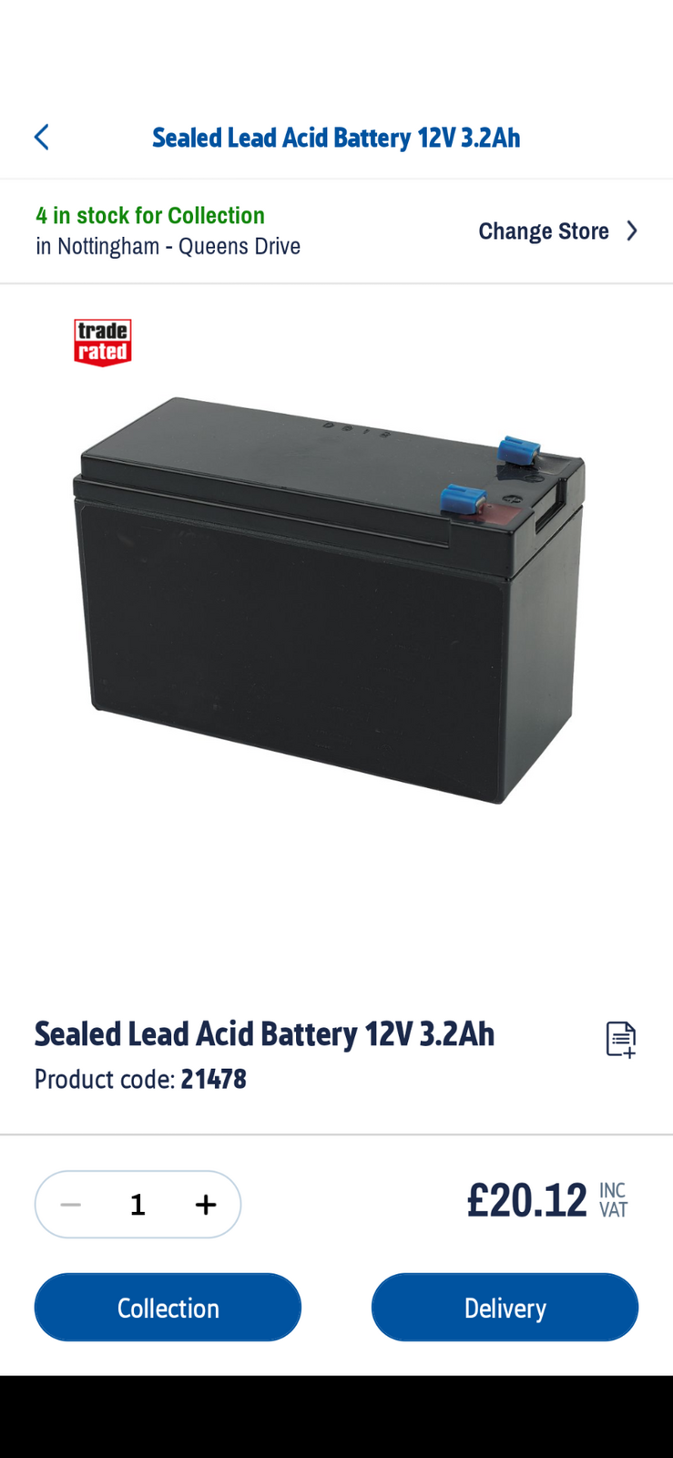

Would this one from.screwfix be ok? It's 12v but 3.2 amp.

Thanks for the replies. Out of interest why would you recommend a 7 amp over a 3.4 amp. Pyronix seem to have 3.4 amps as stock.
What's the benefits of the 7amps?

The size of battery is calculated on current draw of control panel.
7.0 ah is standard size battery for 46s.
Smaller battery = less standby time.

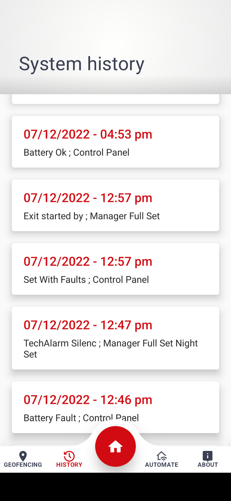

Thanks for the reply.
Interestingly the panel reads "battery ok"
Have cleared the fault in engineer menu and the panel seems fault free for now.
Is this due to the battery recharging in the panel?? Is this a thing?
Or am I delaying the inevitable and should just put a 7amp in thanks.

How old is the battery?
3-5 years seems to be the normal live of batteries these days.
For £20 not worth a sleepless night with warning bleeps.Just change battery.
Thanks it started chirping in the night so changed this morning with a 7amh and all hunky Dory.
