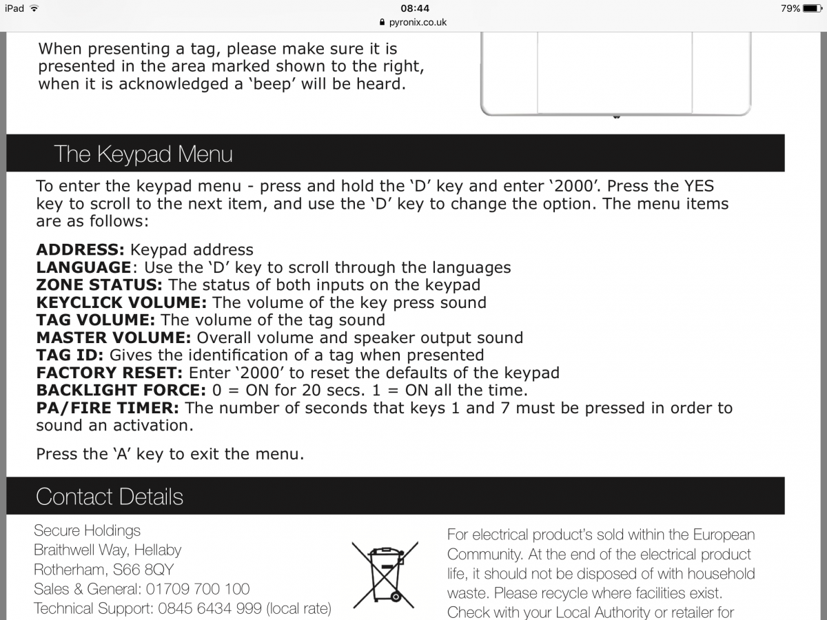

hi, can anyone tell me how to get the backlight on all the time as it seems to go dark after around 1 minute? It said on the pyronix site it's prgrammable but default turns off after 1 minute.
Can't find it in the book though
Cheers
